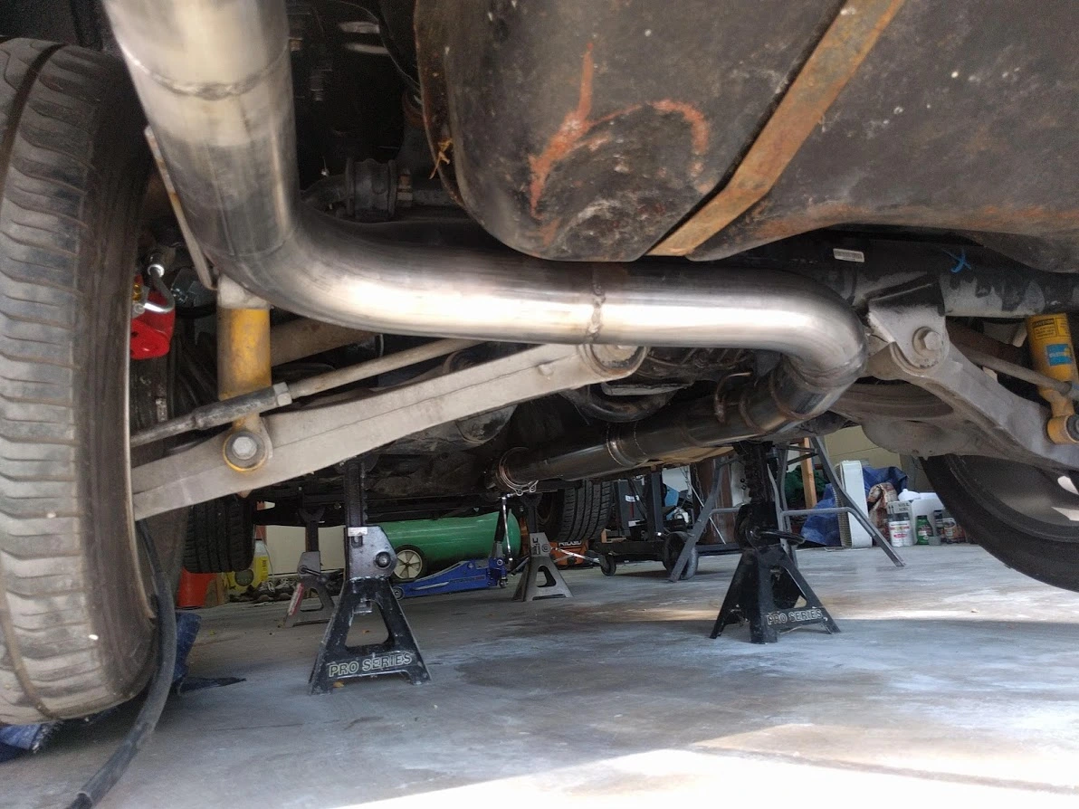

Before the interruption I was chopping and welding my fair share of stainless. Aside from adding a recirc. for the wastegate and tweaking the crossover for accessory clearance, the exuast is good to go.
This is all most everyone is going to see. Single exhaust pipe out the back.
And one of the few poor shots I took with it all buttoned up. Lots of pie cuts in this system.
It splits into three pieces with vbands, down pipe, mid-pipe and tail pipe. It's got a flex join about in the middle, really the only place I had to put it. I put in a glass pack in what I hope isn't a vain attempt to keep the beast quiet, and the whole thing hugs pretty well to the underside, The only place I worry about hitting the the end of the tail pipe on bad driveways but there isn't much to be done about that without cutting up the bumper.

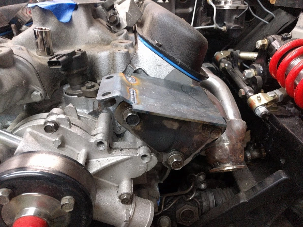

@98Mustang2017 I'm not sure I follow, I've replaced almost everything up front with explorer parts or one off's.

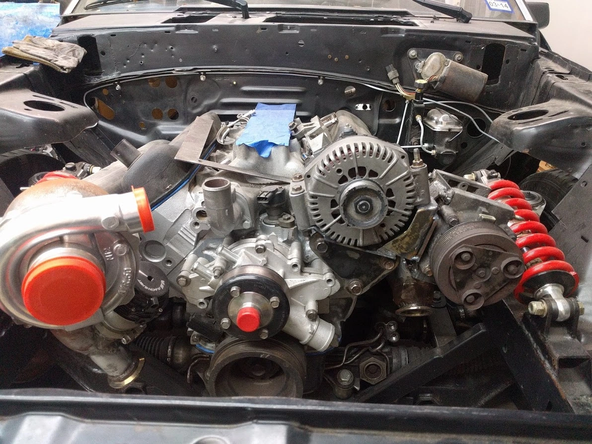

Here is a good half day's work on accessory bracket making:
Clears the hood by about a half an inch, maybe more. Looks like the trade-off for ac will be going to an electric power steering pump, I might can squeeze it under the ac compressor but it'll be kinda close to my crossover. I'll work in a tensioner pulley between the water pump and the alternator in the end. The setup to line up the mounting tab to the alternator at the right height was incredibly fiddly.

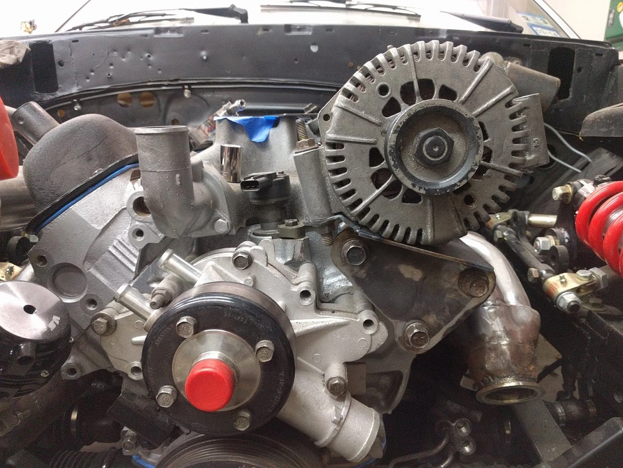

Check out my automatic belt thrower :)
I got the ac compressor bracket tacked in place, it needs triangulated and fully welded..
The next step will be figuring out where idlers, tensioner and the power steering pump fit.
Am I wrong for thinking I can get away with less water pump wrap (1/4-1/3 of the pulley) by going with electric fans? I can see a couple of different ways to run the belt but I'm not sure which is best.

add another plate onto the bottom of the alternator bracket and do a regular pulley to gain more belt wrap... I had to get fairly creative with my setup as well.
just for reference.
all kinds of pulleys are available and if you get creative an old socket drilled out/ ground slightly will work nicely as a bushing.

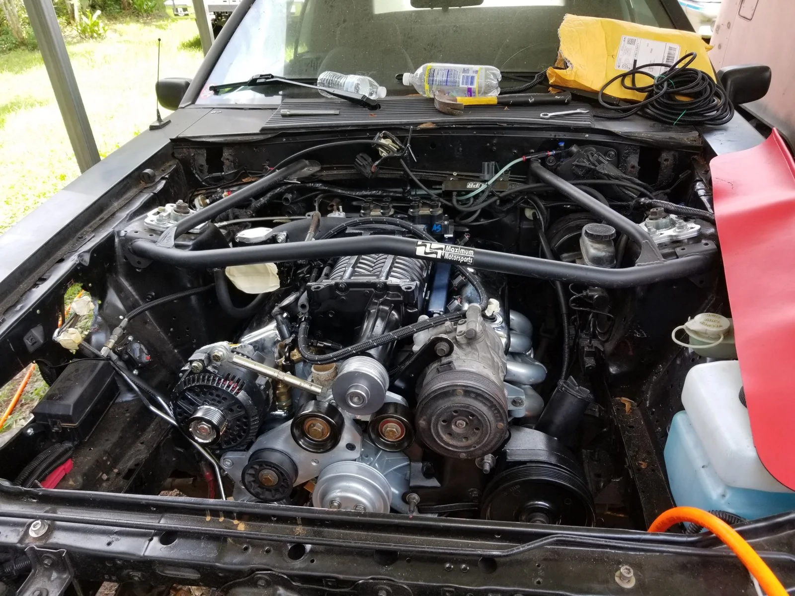

So I take it I am to get as much wrap on the water pump as I can (and alt)?

just showing options, I have wrap on half of the WP pulley and half of the alternator. My main concern was the Blower pulley

I've found a couple pulleys on my shelf, I'll get to placing them this evening.
