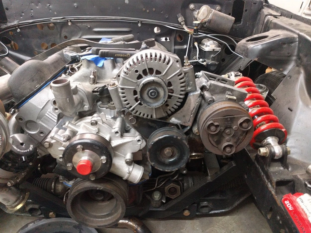

Enjoyed some R&R this weekend but was able to fit an idler last night. Ac compressor took some persuading to spin freely lol.

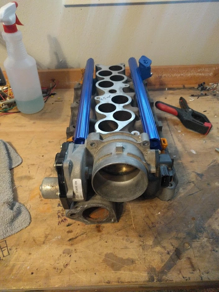

I don't have too much to share. I've been working on my upper intake design. I've got about 4.5" inches of clearance for the intake at the throttle body so i had to find something that would fit. I ended up with a 75mm electronic throttlebody from an 04-09 f150. Something else to tackle was plumbing to the stock fuel rails as well as dodging them with the intake I'm working on. After some pondering I settled on these ebay special fuel rails. They'll kick the regulator out enough for my tastes and i'm probably breaking even with what I would have spent on the connectors to the stock rails. As far as their quality goes? Only one in four mounting locations would actually work and some of their tapping could be cleaned up. The bores for the injectors looked good however so a little cleanup elsewhere and some screw holes added isn't that big of a deal.

why are you restricting yourself so much?? what are we trying to accomplish?
4.5" is from the top of the lower intake to the bottom of the hood (I'd like to keep the stock hood with no hole in it). I should have some wiggle room to tilt the throttle body and bring it forward and down like the holley hi-ram intakes as seen here, but in the end I am a little tight on space. With the new rails I can have a wider plenum too.

thats plenty of room, I have done more with less :D
I think i've got plenty. My charge pipe will only be about 1 foot long and go from 2"-3" connector -> 3" stainless -> 3"-3.5" connector -> throttle body :D.

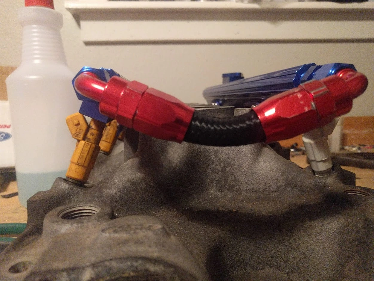

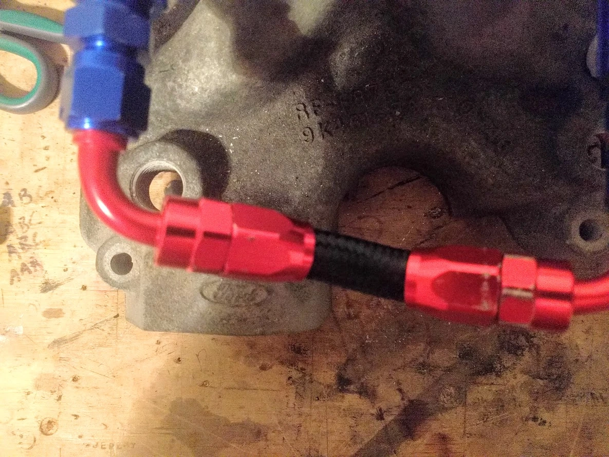

@Davedacarpainter technically this is more. I made a shorter crossover. I'm not wild about it but unless that bend as shown is too tight it should work. Any thoughts on a hard line crossover? I'm considering bending one up with flared 6an ends.
