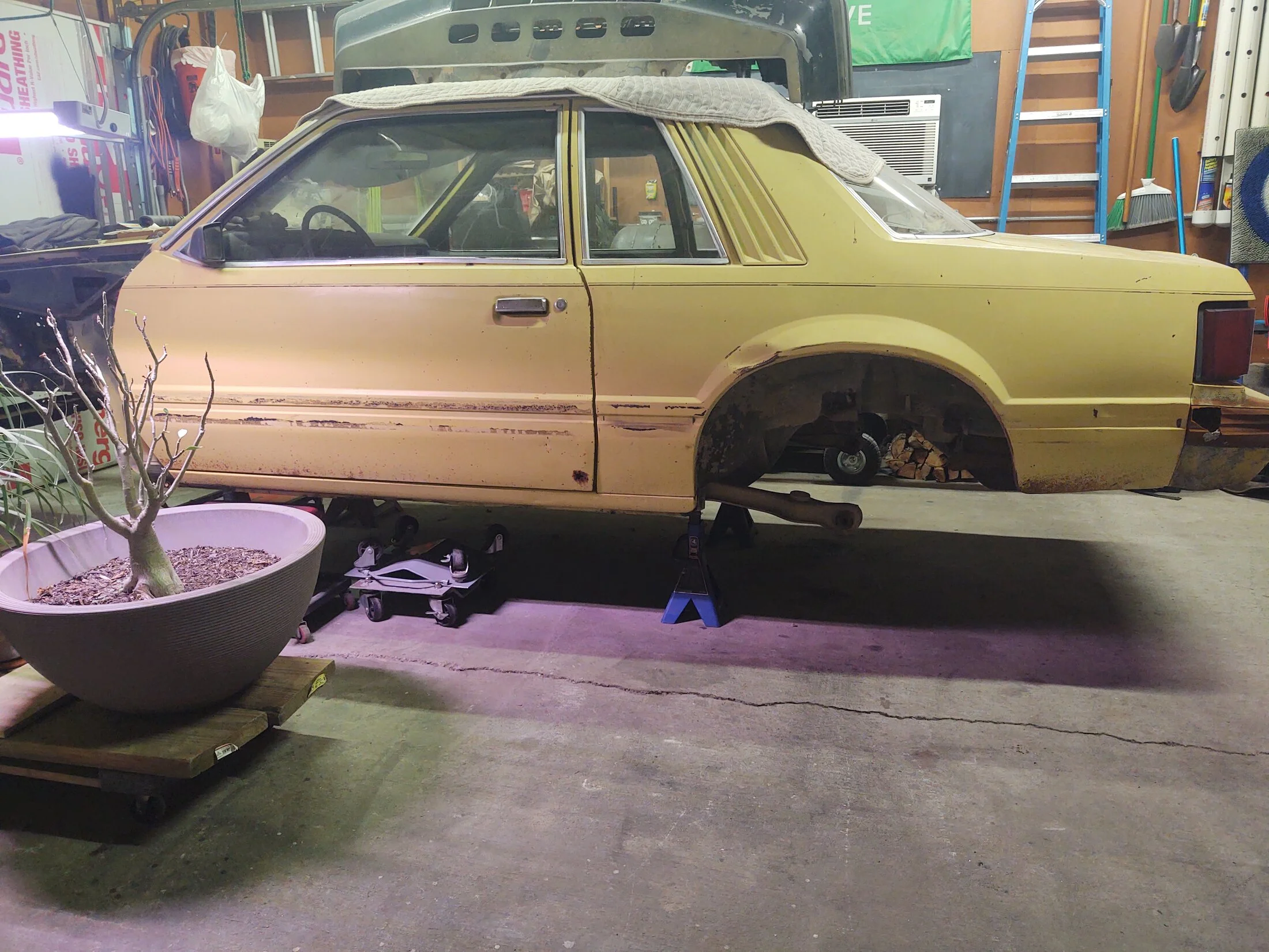

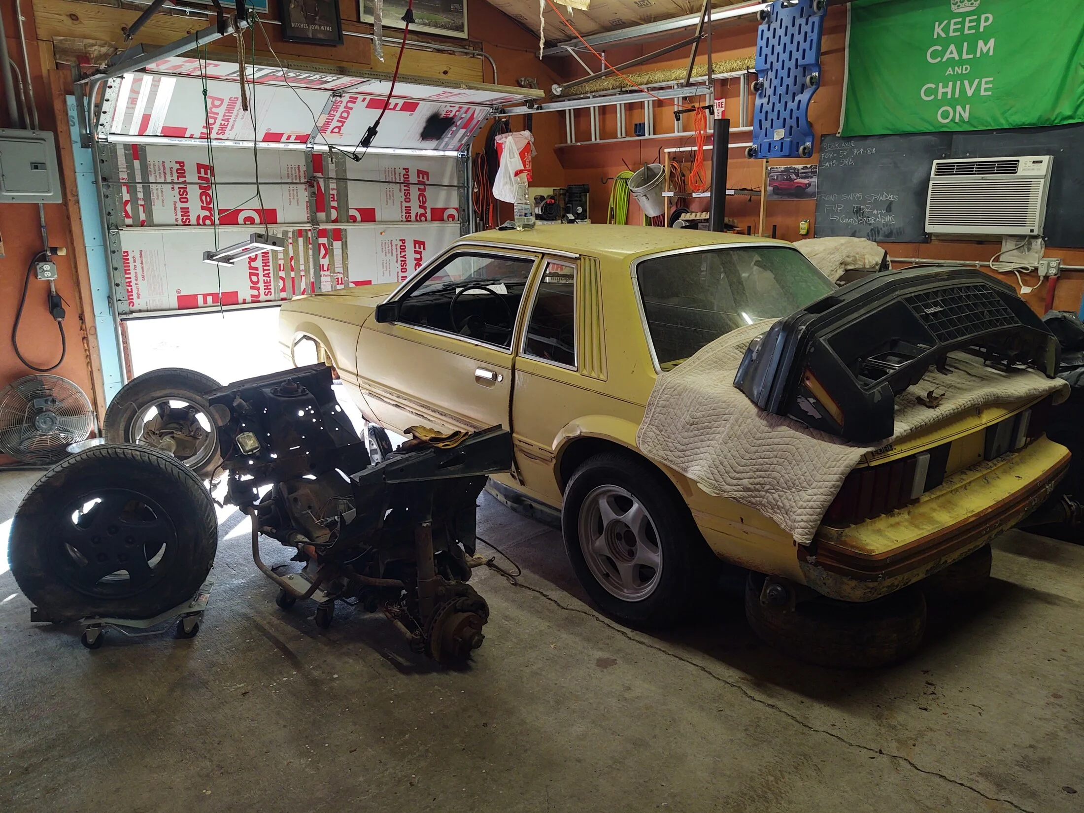

I bought a 1980 notch back shell a few weeks ago. PO was going to make it a circle track car and removed everything. I'm going to build it to run autocross and occasional trips to the drag strip. It has to be street legal, because I've sold my car hauler and larger trucks. It doesn't have to look great and I don't want it to sit in the garage for years. Budget build w/upgrades as needed and money allows. So far I've purchased front hubs, rotors, and rear axle from a '95 GT to start the five lug conversion. I need wheels and tires so I can roll it in/out of the garage. I like the black steel 10 hole design, so I was thinking about a set of '06 and up Crown Vic wheels. 17 x 7.5. I believe I read on here that 17 x 8 would be the largest I could run w/the extra width of the SN95 rear. Is that correct?

As purchased.

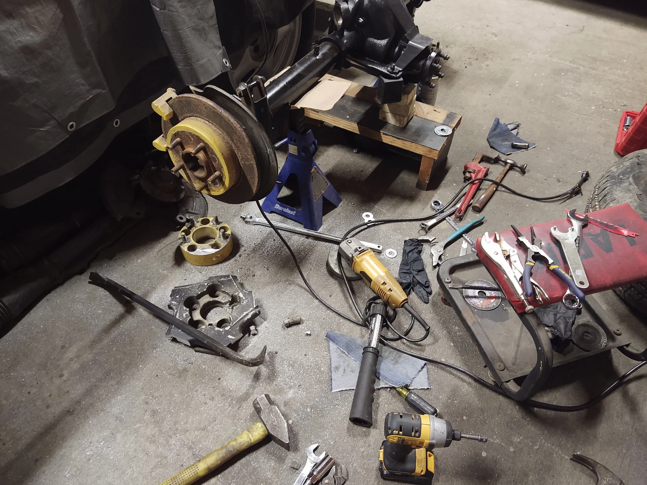

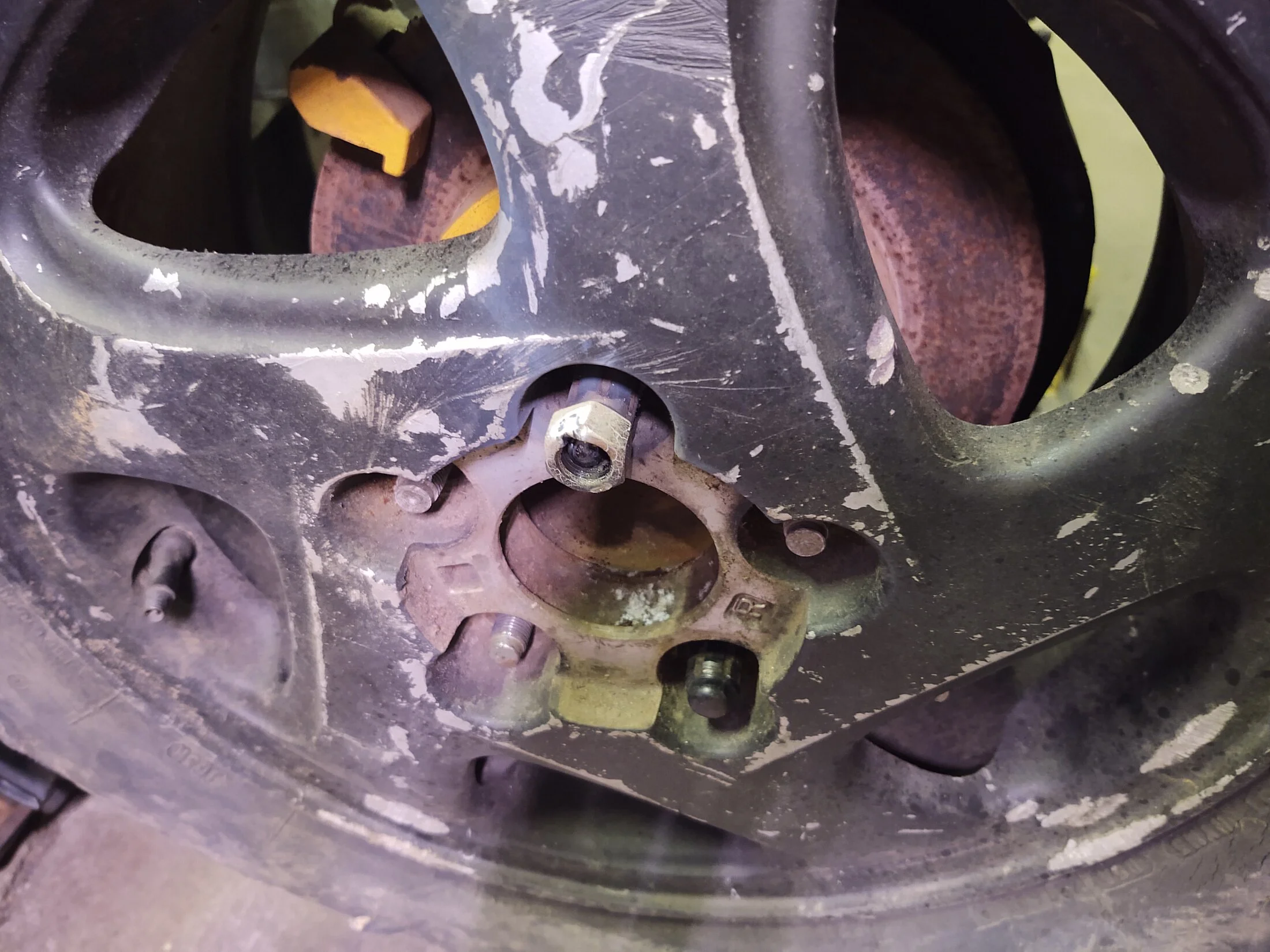

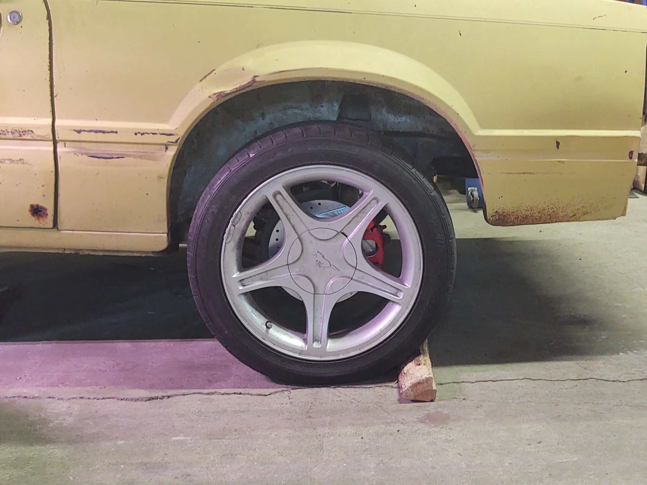

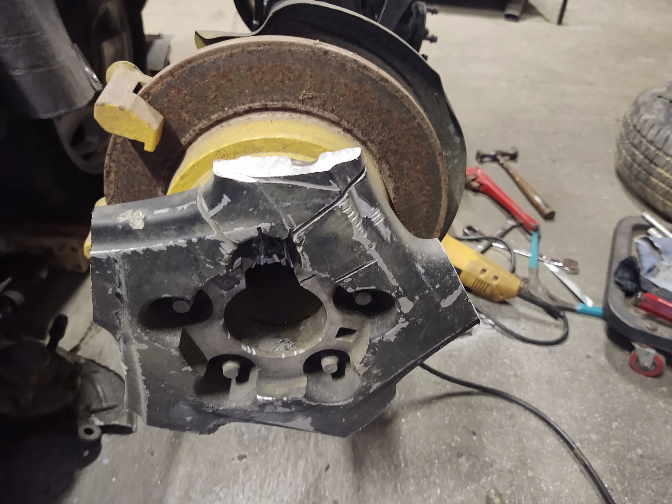

Working on the rear axle this week. It came equipped w/Acura wheels, 2" spacers, and spline lug nuts. First time seeing those, and I'd already damaged two before going to the parts house w/a sample. The spline lug nut socket proved to be useless at this point. So I got out the welder and welded a nut to the end of both lug nuts. First lug nut came off easily after the weld. The second wasn't compliant. Next up were the grinder and sawzall. 2 hours later and the last wheel was finally off.

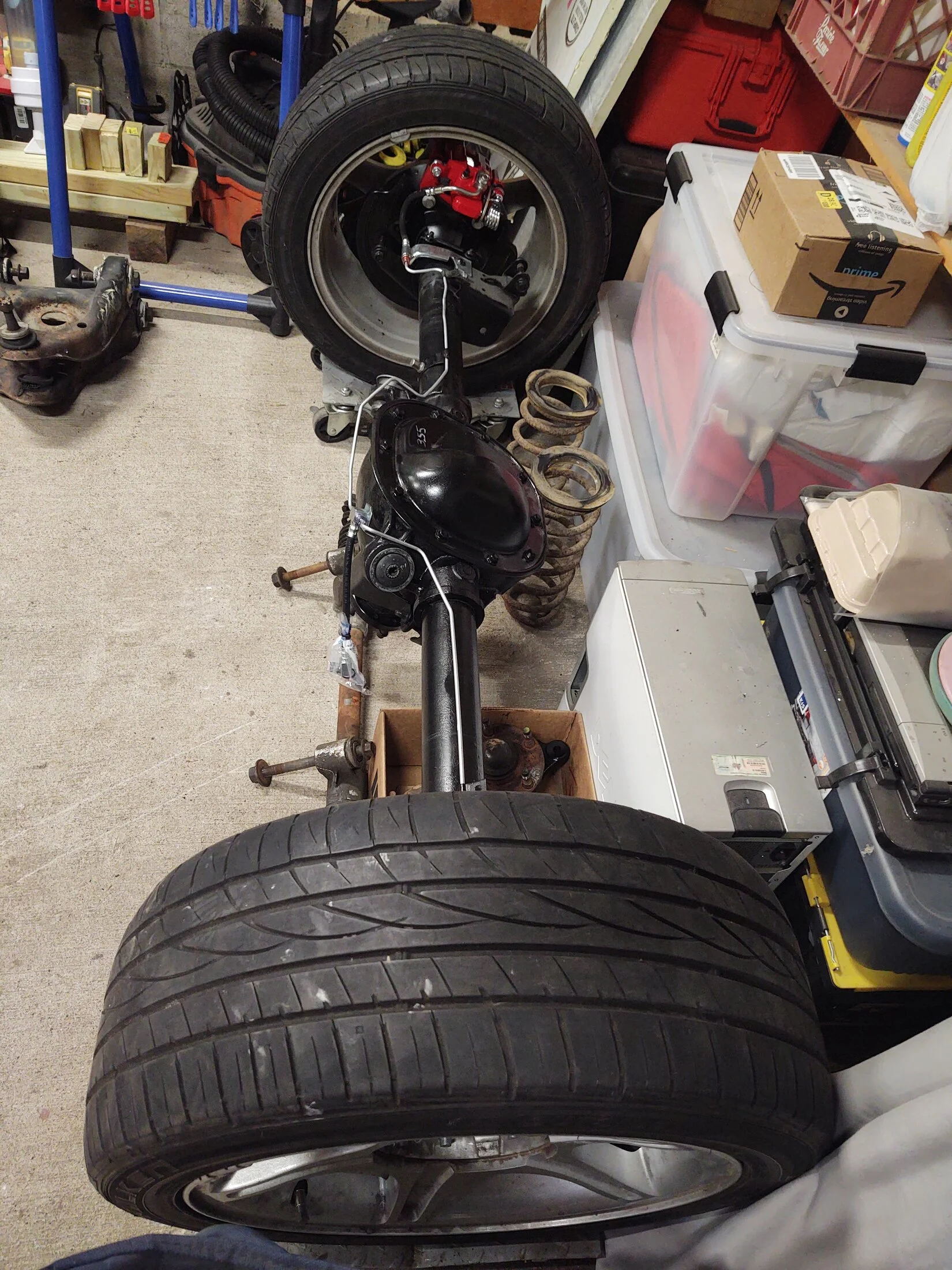

I have the rear '95 8.8 ready to go in. I bought a set of used 17" GT wheels & tires last weekend, and pulled the original 7.5 last night. The next few weeks are going to be boring, I need to address some surface rust w/everything out of the way.

I got the rear axle under the car. New factory style upper control arms, & the factory lowers that came w/the '95 rear axle. I installed new FPP M-5300-C springs & the SVE urethane isolator kit. I bought a set of used wheels w/235/45/17's. The rear of the car looks too tall now. I'm not married to these tires. Do I need to run the urethane bushings? IMG_20240227_131758216.webp
The tires aren't your problem. They are actually a tad on the shorter side.
Could be the car is not full weight also it would be a problem if you tightened up the control arms with the rear axle hanging.
If you are asking if you should replace the factory control arm bushings with urethane, that would be a firm no.
I'd buy new control arms before i would go anywhere near that project.
