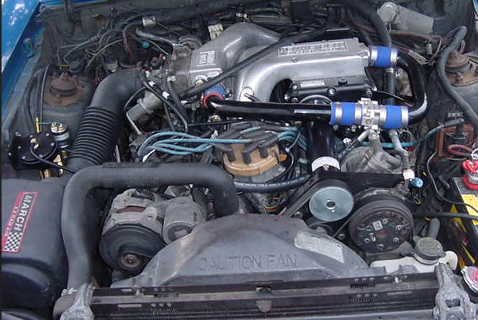

I used to run the whole kit and then went to running just the airbox and filter. The ram air kit didn't function poorly per se. The cleanout works ok but it did still scoop stuff up occasionally. Is the ram air worth any HP? Probably not. Is it a good airbox to use to get the air intake out of engine bay? Yeah, that's what it's good for.
Here's a pic from the [way back] machine :O_o: I was only using the box at this point, shortly after in installed the KB.
I made [almost] 1 lb more boost with the KB with this airbox over the stock airbox in my data logs.

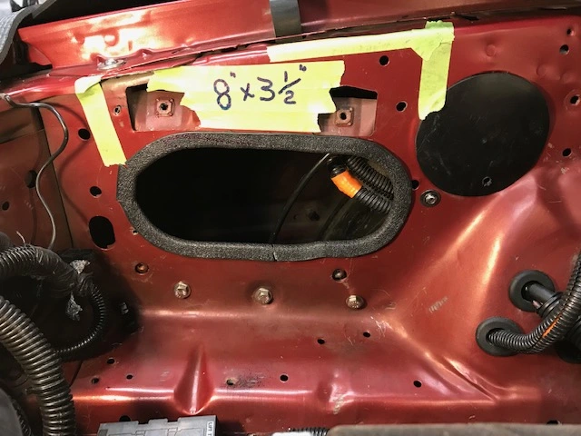

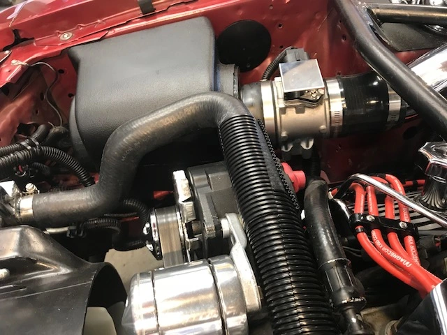

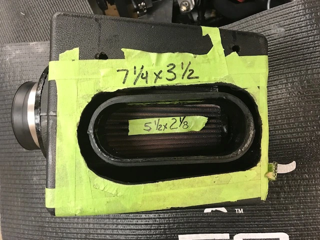

The March airbox is a great way to mount a conical filter under the hood. I opened up the air intake opening to match the hole in the fender apron with a Dremel using a Roto-Zip bit. I do not use the ram air hose or scoop. You can also purchase the ram air box as a stand-alone item directly from March.
