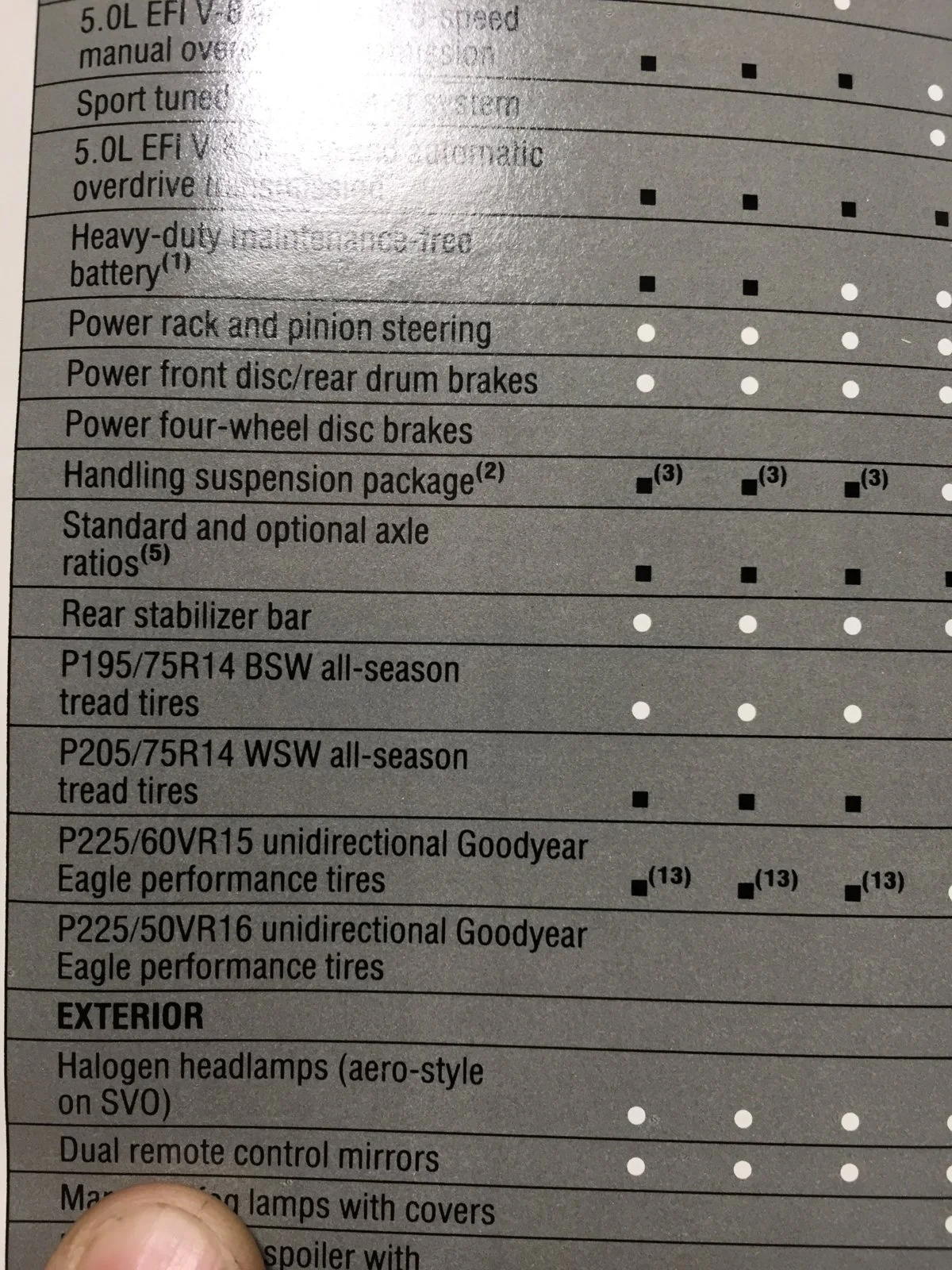

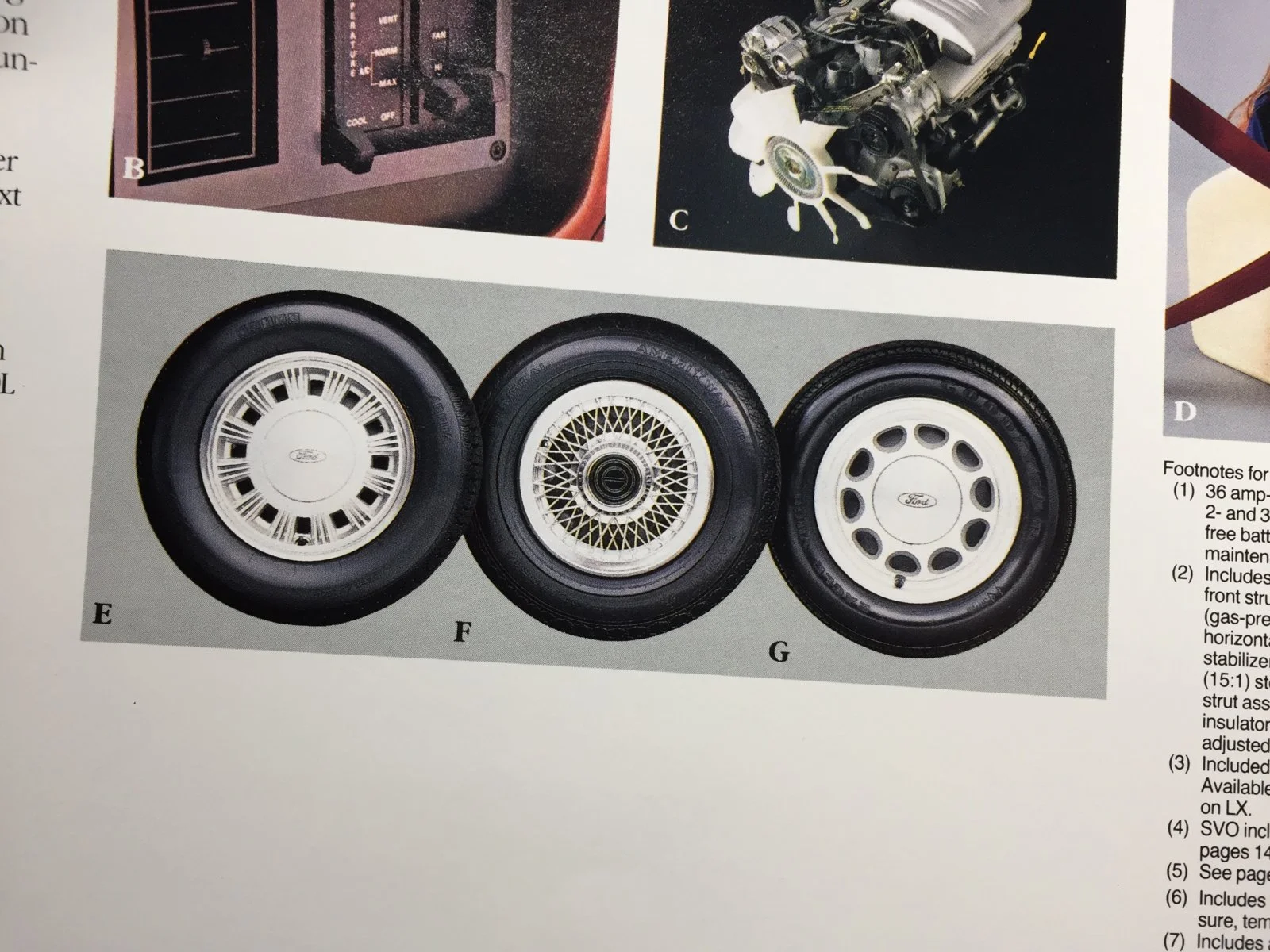

Factory wheels? According to brochure, here's what was available
195/75/14 was standard with 205/75/14 optional.
Standard wheel was a steel wheel with turbine hub caps
Optional were the "styled road wheel" which also came on the 87+ 4-bangers.
A wire wheel hub cap was also an option. Wheel F
10-holes were V8 only
If you want to know how your actual car came equipped, you'll have to do a marti report
