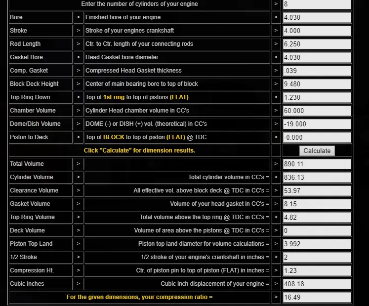

so anyway. I've got a 74' 351w that I'm wanting to stroke to a 408. I'm going with a 4" RPM forged crank, 6.250" forged Eagle H rods, and forged JE Twisted dome 1.230 Pistions with a -19cc dome. Zero Decked, overbore to 4.030.
750-800 cfm Carb, .037 gasket, Edelbrock Vic Jr heads with a 60cc chamber, and a Edelbrock Super Victor Intake. (The rest shouldn't matter for my combustion ration as of right now, lets assume the rest is pretty neutral). JE is claiming that my setup would get me 10.7 cr at a 58cc head, so with a 60 i imagine my cr would be around 10.5 give or take.
I don't think I'm using the online calculators correct because I'm getting an estimate of like 18.5 cr (kaboom). so i wanted an opinion from some guys that i figure have some experience with this.
Hows my setup looking so far (excluding the fact i don't have a cam chosen, but I'm looking at one to get me to about 6500rpm.) I'm trying to keep my CR at mid to low 10's on 93 pump fuel and decided to go NA instead of having a power adder.

Below is from a calculator i am using. there is no way this is right is it? 16.49 CR??

I got the same result when I put your values into the below calculator.
Looks like you need to either choose a different/dished piston or heads with larger cc.
https://www.rbracing-rsr.com/compstaticcalc.html
Ah, so i changed my dome on the calculator from -19 to +19 and my CR went to 10.9 (more like what i want).
Like i said, im really new to this, but for less compression, you want a negative cc right? for more compression you want a positive cc? so maybe either the calculators are weird, im misinterpreting the calculators, or JE's site is displaying the wrong integer...
so if JE's piston claims, it has -19cc (inverted dome i/e hollowed out piston head) then that lowers the CR, if its a positive cc (like 19cc) like an actual dome, then it increases CR..
or am i wrong?
