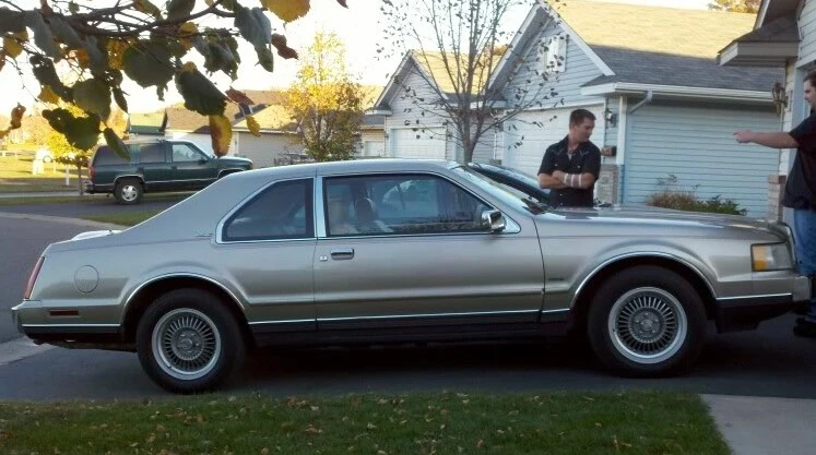

I don't have a photo of the actual car but here is one just like it. I had 2.73 gears in it, a truck torque converter, transco shift kit, and could smoke the tires with a bit of torque braking. It would hit the speed limiter at 130 mph and 3,000 rpm. That was BEFORE I put the 347 stroker and mild cam in it. I am sure that one was a 13 second car but never got a chance to get the numbers.
The tall gears and the low stall speed converter let me floor it from a stop light and just simply be GONE by 3,500 rpms. And I had quiet exhaust system too! I really really miss that car. The new one looks just like it but is near show room. We put a KB 1000 on it just like the old one and blew a head gasket. And it did not even run well. Then my local wrench SOLD the supercharger.

PS: The photo of the MK VII got scrunched in the transfer. I don't know about these technical things.
