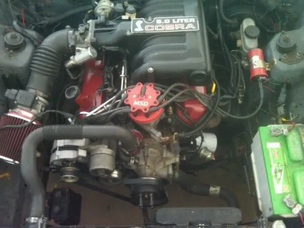

Heres my setup, its mass air, Cobra fuel injection
Thats my thing im being specfic as i can, I crank the Car and itll run then bog out and cut off. but its running my batterie dead every time, but the alts good and batterie.
But if i pull the terminal off while its runnin, it should stay running, but its cuttin off, and idk if this has anything to do or help but an old guy i no told me to try that.
Im Basic startin from sratch, I bought the car not running, guy told me he blew the head gasket, well it was way more then that, so i had another 302 layin around so i transfered everything and it fired right up, no smokin or Knockin so i figured good engine to kick off from, And then my propblem started of it wantin to cut off and run the battterie dead, got tired of throwin parts at it that didnt fix anything so im tryin to see what yall think!
I see a lot of deleted stuff. Usually issues like you are having arrise when stuff is deleted off the engine improperly.
No smog pump, charcoal canister lines/wirng removed, EGR is prob dead, you have a BIG vacuum leak with the oil fill port line missing and wide open. Should be a line from the throttle body to the oil filler. It's gone, and only one side is plugged. At least cap the valve cover port, but ideally you want a vac line from there to throttle body
First step...run the check engine codes. No point guessing when the car will tell you exactly what is wrong.

it looks as though the PO hacked it up a bit, based on the pics. if I were you I'd try and find a new wiring harness in a junk yard or online and put it back as close to stock as possible, then modify to YOUR preference. Who knows what has been chopped out of there. did you run the codes yet as suggested? that might help lead you to what's missing...
its a sweet looking car though. definitely worth getting back together the right way
