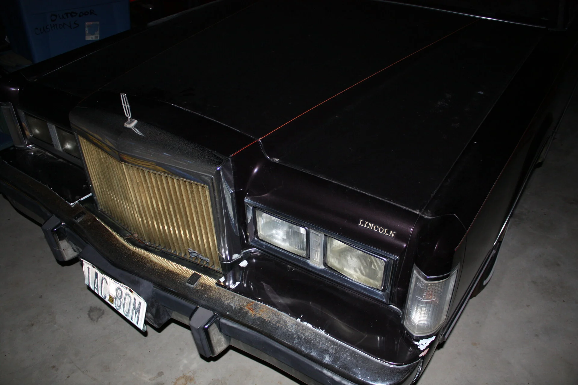

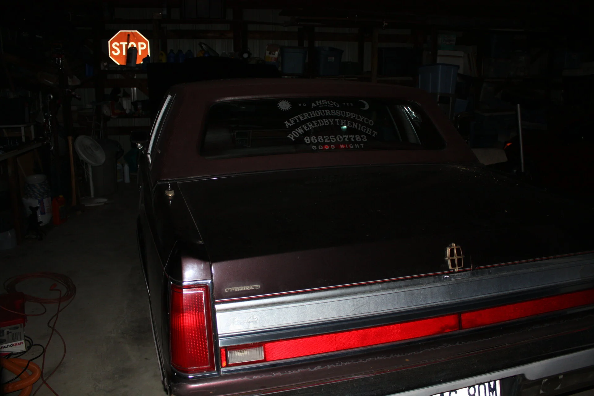

Now that you’ve confessed...... we must see a picture of it!
I thought you'd never ask!
I think they only made around 5k of these with the gold grills and this paint. It's pretty menacing in person.
