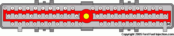

Code 19 - Engine off - No Vehicle Power (pins 37 + 57) or bad PCM VPWR
Revised 30 Mar 2019 to add computer wiring connector diagrams.
Key on, engine not running .
This is a wiring problem that is from a bad ECC power relay, bad connection, bad fuse link, bad ignition switch or a bad computer. The ECC relay is located on top of the computer under the passenger side kick panel. Pull the connector off any fuel injector and measure the voltage on the red wire: if its 12 volts or better, the ECC relay is OK. If the ECC relay is OK, pull the kick panel off and measure the voltage at computer pins 37 & 57. If it is 12 volts or more, then the computer's diagnostic firmware has taken a dump and is defective.
Computer wiring harness connector, wire side
Computer wiring harness connector, computer side

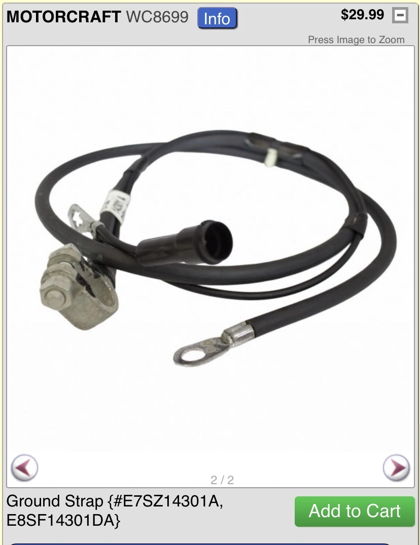

Chiming in again on this. Thanks for the tip. I replaced my negative battery terminal and noticed a slight improvement in my failure to restart when warm/hot. So I replaced my negative battery cable. . My ground cable from battery to block I was suspect of initially due to the brittle insulation and soaked with oil at the block. I had cleaned up the connection there but the cable itself was crustyand grimy. I dismissed this as contributing to my restart issue as the car started when cold. I am having consistent restart at operating temp without issue or hesitation. I am definitely relocating my tfi as I have had it temporarily relocated to a heat sync resting on top of the dizzy boot. TFI stayed cool there on the heat sync so definitely will be permanently relocated once I get the kit, never to return on the dizzy.
