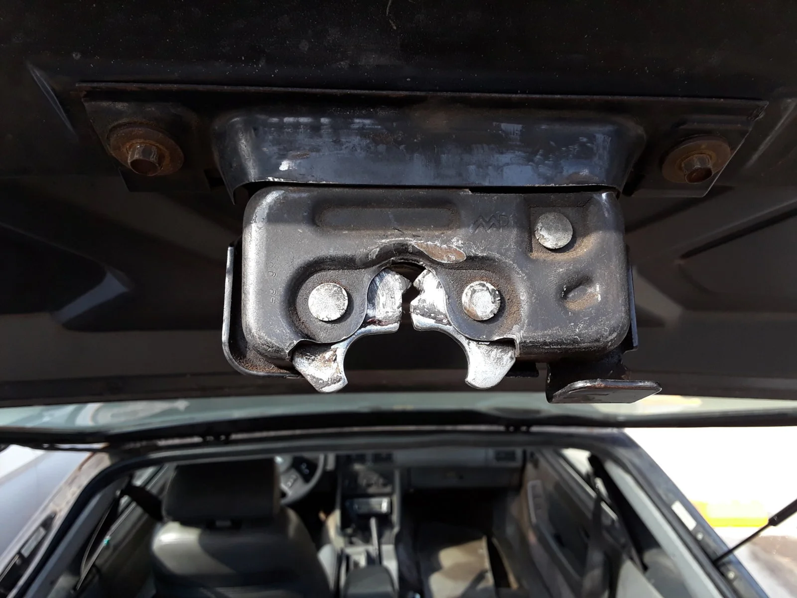

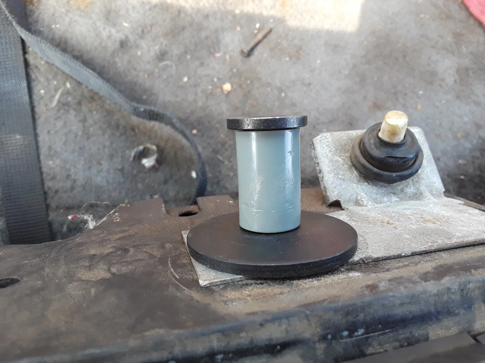

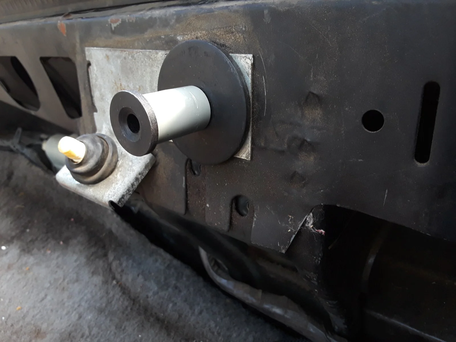

Ok guys, problem solved!!! It turned out to be super simple. You might notice by the pictures I posted that the new LMR striker is not a torx operated screw like the original striker is. instead, it just has a hole in the center. I foolishly hand tightened the striker thinking my hand would produce a sufficient amount of torque to properly tighten the striker. This, of course, was not the case. Every time I closed the hatch, the latch would push the striker out of place and compromise the adjustment I had previously performed. I grabbed an adjustable wrench and tightened that sucker in the proper position and the hatch closed and locked properly after that.
I'm glad you got straightened out. After looking at the pictures again, I see that the latch WAS open. If you have problems getting the striker tight, you can tap the hole in the end and loctite (red) or jbweld a short bolt inside. That should give you a little more leverage. A little semi-gloss black paint and you would never notice. Have a blessed week
That's an odd striker lacking the torx bit insert to tighten it up. How are you supposed to tighten it?
I kinda agree with the idea of drilling an tapping a hole in the end and installing a bolt. You'll just need to JBweld the bolt into the threads so you can loosen it, although vice grips would probably do it as well (although marking it up).
I'd send a comment to LRS asking them about this? Seems strange to not provide any way to tighten it
