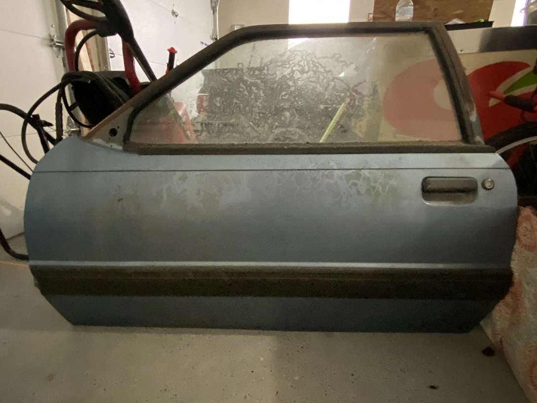

Ok. So, I drove to a mustang specific yard in PA (https://www.billfoxsautosales.com/), as they had on their website some fox hatches in perfect shape. However, when I got their in a borrowed midsize SUV- they determined that the hatch still would not fit. ALSO, they said the 1990-on hatch was slightly different (different latch?) than the 1987-1989 hatch, and all they had were 1990's hatches. Finally, the ones they had were sitting outside, and unbeknown to them, had acquired some surface rust since the last time they inventoried. So, absolutely not a dig on them (they appeared to be SUPER cool- were happy to chat mustangs with me, and were super friendly!) but the hatch just didn't work out. I did pick up a driver's side door however:
It's very dirty in the picture as you can see- but the whole door is smooth, un-damaged, and rust-free. (It's an LX door, and it is power window equipped, so I'll have to swap the trim and the window regulator over).. But, unlike my driver-side door which has through rust under the trim, and several dings/not straight, this one will allow me to reduce the amount of body work needed when I do get the car painted.

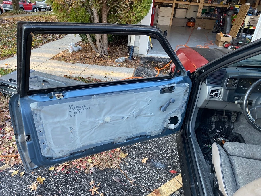

Ok.. Swapped it over today. My wife's cousin stopped by, and offered to help- and these doors are kinda heavy (and he also has an '89 5.0 convertible, so he's familiar with the type) so I decided- time to do the door swap. I'm glad I did; The inside of the door was pretty minty! First of all, I must have looked at a bunch of doors (they actually had a '93 cobra door there- could tell from the VIN tag on the door!) and many doors/most doors were power window. Mine is actually manual wind after-all, so I didn't have to swap that! A nice surprise (how the heck did I miss that!)
My 247k mile GT had the original door pins in it. So, that required dremal action to get the pins out. BUT, the new-to-me LX door had replacement pins in it, so they came out quickly (the door came with hinges).. I had a new door pin kit from LMR in stock, so I put in new bushings, and new pins (and a new roller for good measure). A small adjustment to my front fender and striker, and now the door shuts without binding or making noise- and feels WAY more solid. Must be the new pins... I'm getting quite the collection of colors here (the hood is originally white in color too!) but, this door has no rust, and is very straight.
I still need to remove the pin stripe, and the LX door molding. I've ordered new door moldings from LMR- they appear to have good reviews. Anyone know if they come with the tape needed to mount them? I won't be mounting until after it is painted- so I'll leave the LX molding on for now. Look how nice the inside of the door looks:
I swapped the mirror, the lock cylinder, the lock tab plastic (mine is black, this door came with silver?) and put my door panel back on. The front edge and body panel gap appears to be perfect. The rear of the door is fine height wise (even though the pin stripe makes it look a little strange), but, the top (near the door handle, not the top of the window frame) rear of the door sticks out perhaps 3/16" away from the quarter panel. Not terrible, but not perfectly aligned either. The striker is all the way inboard, so I don't think I can do anything here.. Anyone else experienced this? What do you do to get the gap smaller at the back near the door handle?

Looks like the water barrier has never been removed. Door moldings come with double sided tape already on the molding. Paint and install.

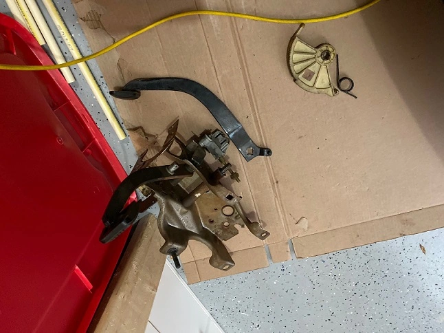

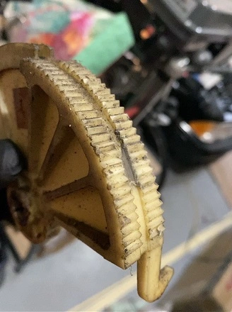

Online research convinces me, that I've probably broken my clutch quadrant, which I was able to visually confirm was actually the stock plastic unit. At first I considered that trick looking Steeda aluminum quadrant. Then reading the fine print, I see that you have to use their special adjustable clutch cable. Then, I notice just about everyone that has one has the firewall adjuster too. Hmm.. That's funny, I never had to adjust my clutch before- and I always thought how good the clutch felt for such an aged beast too! So, quick read in my service manual, and I realize, the plastic quadrant also has a self adjuster locking pawl, and some springs too- with a non adjustable cable. The whole assembly adjusts itself (until it breaks that is!), but, mine appears to have lasted a LONG time (possibly it is the original part..) Besides, I like stock- call me corny, but it's what I like! So, I ordered a NOS quadrant assembly- came with the quadrant, pawl, new springs, new shaft, and I also ordered new bushings.. These are actually around to buy, for about the same money as buying the aluminum aftermarket stuff. Besides, how hard could this be to assemble I ask myself?
Well..... After three days, it is done... I didn't break anything... I did it right... It works (clutch actually feels REALLY good and smooth!) However, on my personal scale of 1-10 difficulty I rate this job a 12. In other words, if a 1 is considered "gravy", this job I'd consider "The whore of all whores!" :D That bracket! Uhg!! If you've not done this before, and you don't want to pull the dashboard, you have to remove the Driver's seat and steering wheel, a lot of trim and things. Then, you have to essentially wedge yourself upside down under the dash. Opps! I forgot to mention, first you have to disconnect the clutch cable underneath the car! Hurray! After doing this, I think I could do it faster if I had to do it again (and God I hope I never have to do this again!!!) I figured out after removing the nuts on the brake booster inside the car with a wrench and going VERY carefully, that use of two swivels and two extensions allows for good speedy re-install with a ratchet. Really, the hardest part was getting the pedal bracket out and then back in. I digress. I replaced the clutch cable too for good measure- I figured, I have to essentially R&R it anyways, why not replace it while I'm there. The old one looked fine (although kinda gooey.. Someone must of lubed the clutch cable at some point- I've never lubed these cables personally, and am not planning on lubing the new one). Oh well, now I have a spare one if the new one breaks.
Here's the broken quadrant when I got it out- it was stripped:
Here's the car, mid-repair: (Of special note, please see the cardboard "pad" that I tried to use to prevent me from jabbing myself with that seat stud. I poked the stud through one side of the cardboard, and folded the cardboard over the top of it. This worked great, until I put my weight on it, and it poked through the top of the cardboard! @#$%%^!!!! At least it didn't cut me! It would have been a shame to get blood all over that new carpet!)
Here's my pile of old parts, and the pedal bracket- which the OCD side of me just had to clean before re-assembly! PS: Did I mention how hard it was to snake that big freakin bracket out and back into the car, while upside down, while wedged under the dash, with a seat bolt stud repeatedly poking you, and a heavy steering column is nestled on your chest?!? At least I had some good tunes on the radio!
Oh- see the clutch interlock switch? A previous owner had disconnected it from the clutch lever, and zip tied it in the
clutch fully depressed" condition. I might keep a zip tie in my glove box if I ever need to circumvent this on the road again!
AND, here's the car all back together (and with the original seats, driver's seat just rebuilt and no longer leaning back on one side):
As I mentioned, so far so good with the clutch quadrant, new bushings, new clutch cable, etc. And, now the clutch interlock switch is working. Brake lights and horn work too (they worked before, but had to be disconnected during the repair- so I'm glad these work still!)

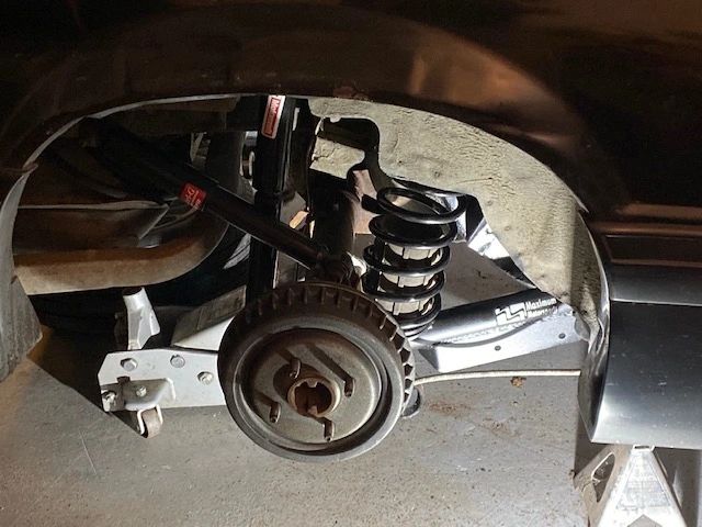

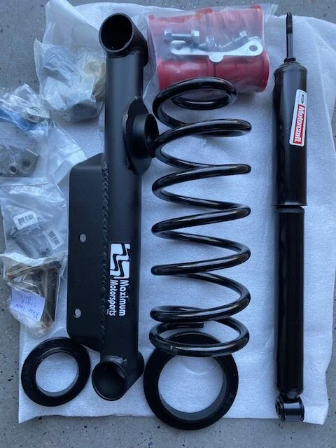

After a few months of saving pennies and collecting parts, on to the next project (and I DID take pics this time..) You may have seen a hint a few posts back, when I replaced the quad shocks. Many of you perhaps thinking "Hey man, you replaced the quad shocks, but the rest of your rear suspension looks like Ca-Ca!" And, you were right! I've been collecting the parts for months actually- for the front suspension too- but, gotta start somewhere. I like to only do jobs big enough to accomplish stuff, but not so big the car is down for a long period of time. I acknowledge, I have a short attention span- so, I cannot afford to loose steam fellas! I need that car drivable so I can get my fix of that awesome V8-sound and Man's man heavy clutch pedal feel.. Boo-ya!
Ok, sorry- too many words. Why did I do this? The suspension felt loose and tired, and the rear 'clunked' every time I hit a bump. Also, while the frame looks pretty good, the shocks & control arms, sway bar, and diff/axle were rusty and nasty. Ok, enough faffing about, it's picture time:

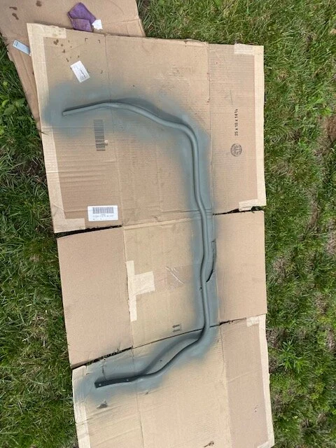

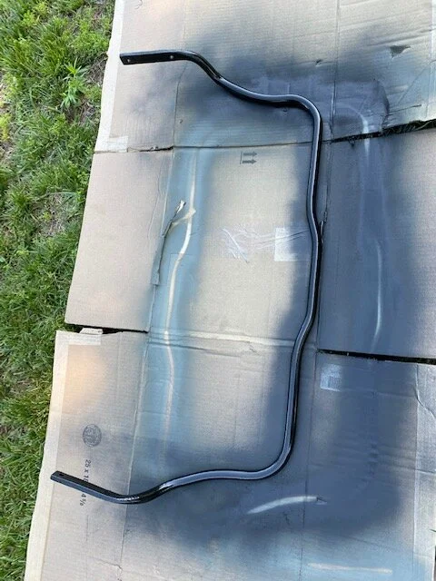

Starting with the sway bar, I cleaned it with wire brush and wire wheel drill attachment, then primer, then paint:
Next, on to the passenger side. Dis-assembly went fairly OK.. Only needed breaker bar a couple times. Here's the diff looking disgustingly rusty, but with a new axle bushing. (The maximum motor sport tool makes this easy. Also liberal prior soaking with PB Blaster, and also sanding the back of the old bearing prior to removal, then oiling it seemed to help). After the suspension was removed on the passenger side, I removed any surface rust on the frame rail/torque boxes, cleaned, primed, and painted.. Whoever bought this car had undercoated it. It looks terrible in some spots underneith the car, but after removing the old undercoating, the frame and underside actually looks pretty good. You can see, I have plenty more cleaning/de-rusting/painting to do. So far, the rusty stuff looks a lot worse than it actually is Gracious a Dios!!! Also- only benefit to NOT having a suped up engine = nice intact torque boxes?
Here's most of the new passenger side parts, lined up, ready to go in (stock Ford axle bushings, Maximum Motorsports "stock style" upper rear control arms [not pictured] & "Sport" series lower rear control arms, Moog springs, Motorcraft rear shocks, Prothane urethane spring seats. New bolts from Jegs (10.9 bolts just for this purpose [also not pictured]), and new Ford nyloc nuts used throughout- coated with anti-seize.. **Whoever wants to do this in the future- the Prothane lower spring seats fit tightly on the MM rear lower control arm, but soaking them first in hot water makes them go on nice and easy**
...and, then it was rinse, lather, and repeat for the driver's side. **Hint** even with a trans jack under the rear end, and floor jack under the axle on the driver's side, I couldn't get the rear most bolt hole (of the rear lower control arm) to line up, while spring was in place and attempting to put it all back together. I read other dudes remove the spring, bolt up the control arm, then raise the other side for max clearance to put the spring in. BUT, I tried the other suggestion I read online- which was to drink heavily, then summons crazy drunken fool strength! (Ok, I didn't drink, and I'm not THAT strong; I used a ratchet strap, which made it all line up nicely to put the final bolt in..) Finally, I re-installed the repainted sway bar, with new bolts and new replacement clip-on speed nuts.

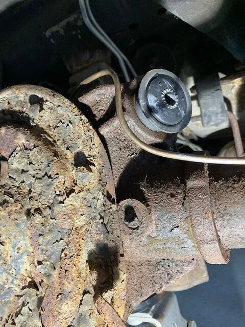

Next, I used a wire brush on the axle, and cleaned it a bit. Yes, I should have done this with the axle removed! But, I figure at some point I'll pull the axle to better clean/repaint/rebuild it. For now, I think I made it 1000% better looking- you be the judge, comparing it to the axle bushing pic in the previous post.

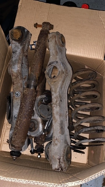

Here's all the old parts:
And here the car sits after final torquing (all bolts were left with the nuts on, but loosely tightened, then the rear wheels were re-attached, and the car was lowered onto some ramps so I could have normal ride height, but get under the car to torque all 18 nuts that needed torquing)..
So, after this pic was taken, and some test driving was done (and a few nights sitting on it's wheels) the rear end has actually settled in a bit more, and I have to say, I'm quite pleased with the ride height- if you're rocking the stock rims, and you're not a "lowered" kinda guy, I believe it is exactly at stock ride height now- which is what I wanted. Also, test driving reveals- no more clunking over bumps, the rear end feels more "planted", and the car tracks straight and true. It really made a surprising difference! The suspension actually is much easier to actuate if you push on the back of the car- which I was not expecting.. I mean, it's damped properly and does not bounce; but it is clear to me now that the old suspension was actually bound up perhaps from hardened old bushings.

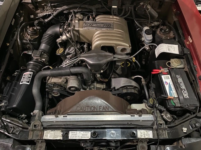

#1, I deleted the aftermarket, "hot air" intake, and put the factory airbox back into service. Yes, I know you can buy a new airbox and all related stuffs from LMR- and while I'm glad this is possible, I'm way too cheap for this. So, I did pony up for LMR's new repro airbox sticket for $10.00, but then pieced the factory airbox back together (including the original rubber mounted airbox bolts, and all necessary hoses which were previously replaced when the old air filter was implemented by a previous owner) from perhaps 3 seperate junkyard trips and findings.. These parts were all carefully cleaned and scrubbed with simple green, then reconditioned with Ballistol gun-cleaner.. (No- I'm not kidding!)
Ballistol if you've never heard of it is like an old-school German version of perhaps WD-40, only thicker with more lube? It's mineral oil based, smells like a mix between licorice and feet, and can be diluted in water to clean/lube/protect, or used full strength to lube/re-condition plastic and wood. It's great to clean firearms, because it will dissolve the powder/lead/filth, and then also lube and protect. It coats metal parts and prevents rust. Plus- totally non-toxic (it's claimed that German solders in WW I used it as salad dressing?) I like it because I already had some in stock, and it really does clean/recondition rubber and plastic- try it!
So, here's a pic of the return to the factory airbox system (after pic was taken, I then moved the upper radiator hose guard more to the left to prevent chaffing on alternator):

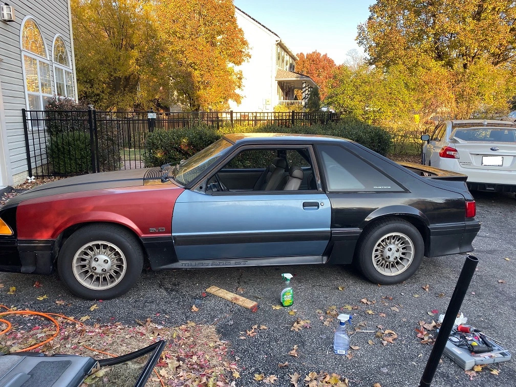

So, on the slightly goofier side- my coworkers kept making fun of my multi-colored "clown car", when I drove the car to work. I'd get all these pics texted to me, "holy crap, look at this clunker in the parking lot. HAHAHA".. So, naturally I painted it the car. Only- I'm not a painter. And I have no booth, or large compressor, or even paint guns (or skill or sense, or....)
So, here's my rustoleum job on the front fender and driver's side door. Let's just say it's a "100 footer" lol. It is now all one color again. Also- dang, it makes the driver's side door LX trim really stand out on a GT! ;-) I still need to replace both door felts/window guides/bushings, and paint the door window frames.

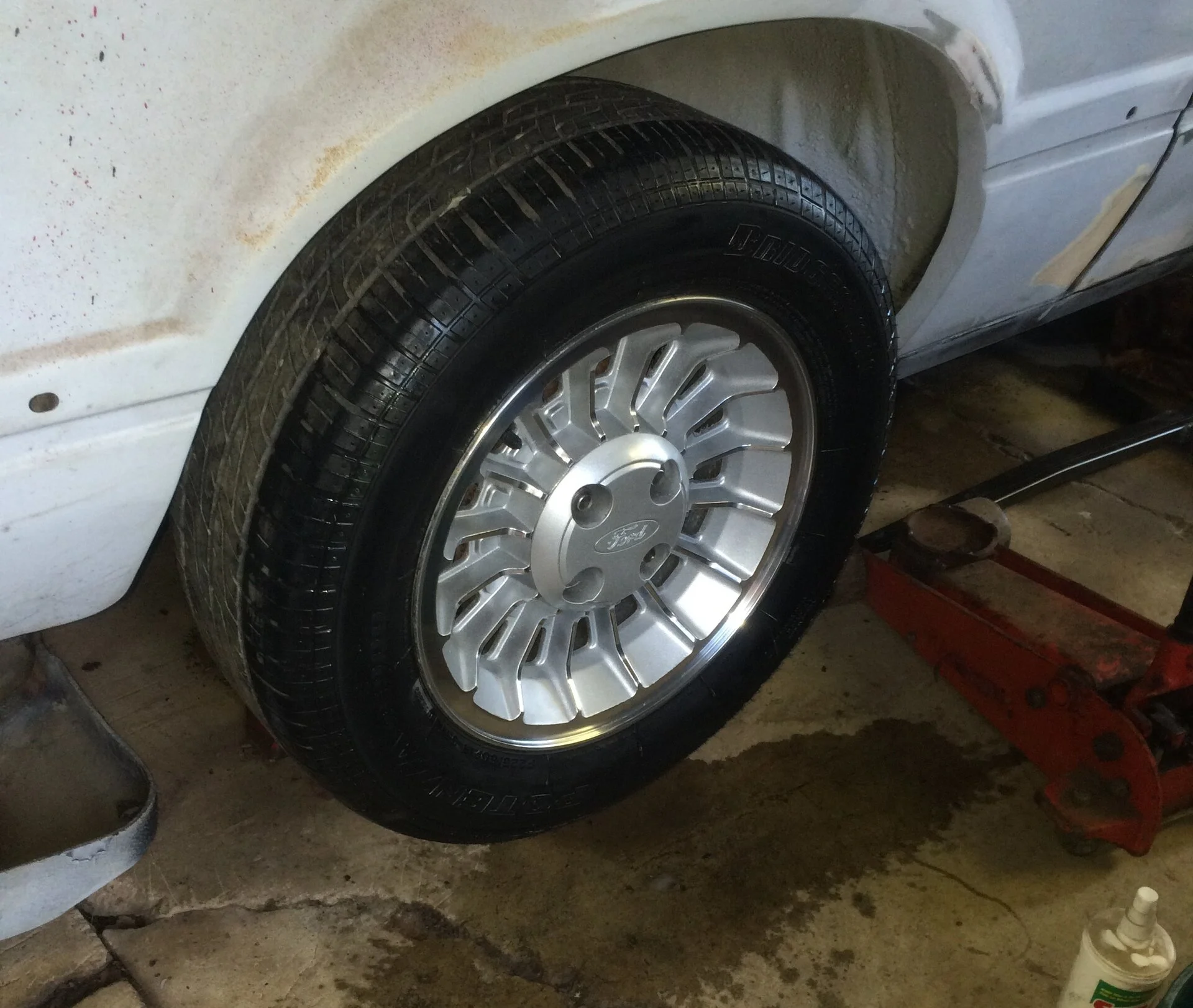

For the Turbine rims, anyone heard of or used something that was a really good match to stock color, that you'd recommend? I did score some new David Carpenter center caps (the original ones look like they're in one piece, but have cracks in them) from foxresto.com..
AND, the golden question: If I keep the stock intake for a while- what paint works well here? I don't remember this from back in the day- but, now mine looks decidedly like it's got a green tint? I've heard other guys say yellow. I've seen many paint theirs silver- and while it looked nice, it didn't look any where near the stock color. Do you all recall- were these green from the get-go? Or have they just done this over time?

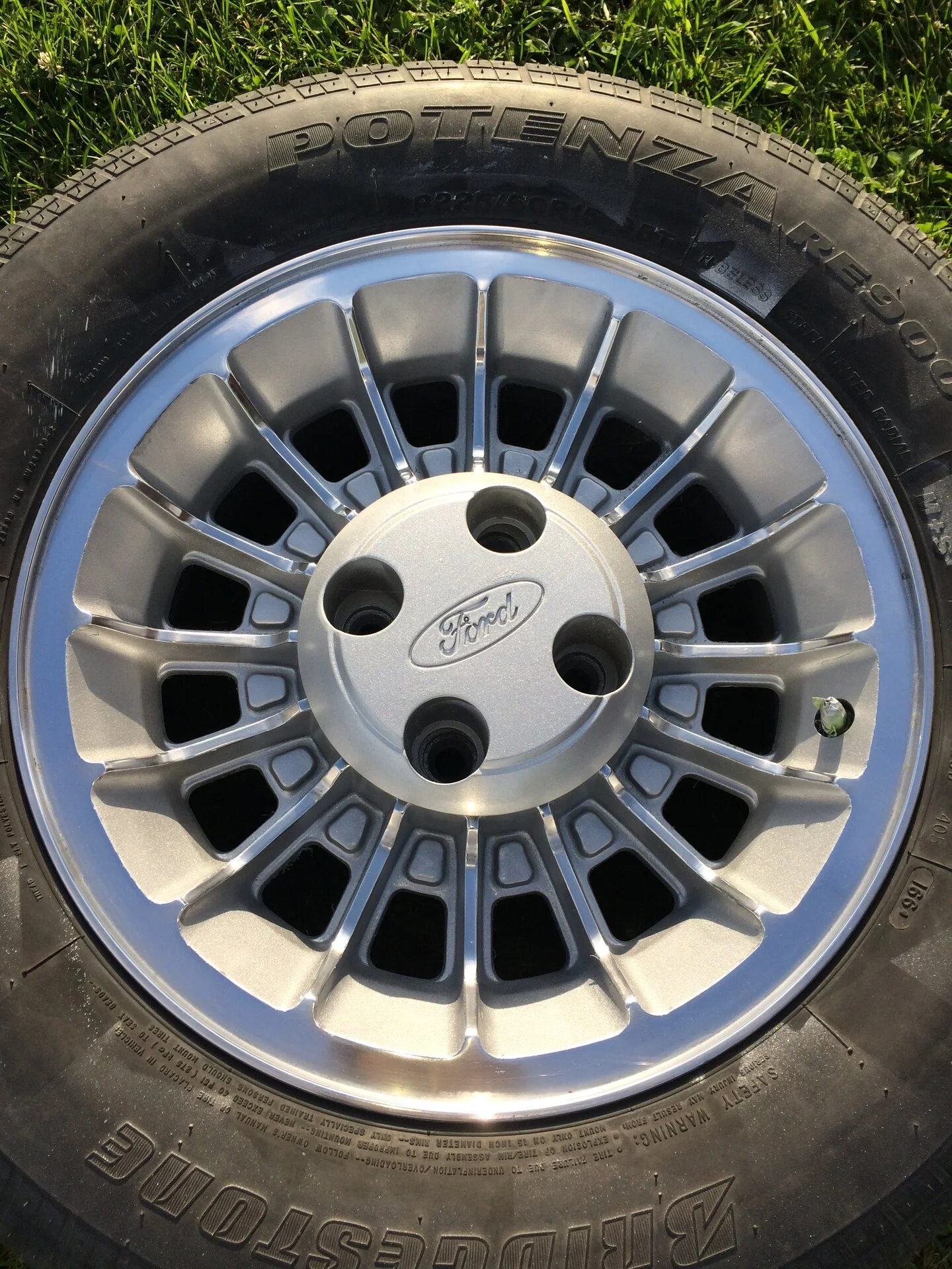

Polish the lip and fins and paint the rest...
I did this to mine when rebuilding my '90 GT. I ended up going with some 4-lug 16" CSA Mullins instead.

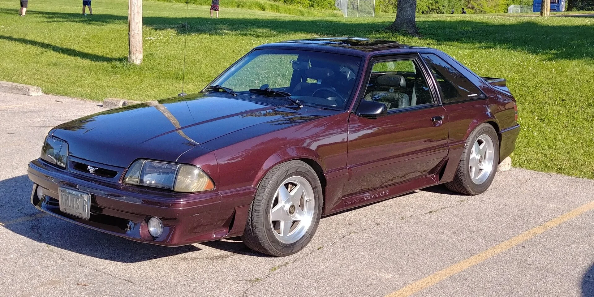

My car is a factory black on black GT, so I like seeing other similar cars progress. Where my car has progressed since I got in 2015...
I have no formal auto training and did everything myself except set up rear end gears (my brother a certified auto tech did). Painting is not as hard as many think. The prep is the biggest and hardest part. Nice thing with paint is if you screw it up bad enough, you can just repaint it again.

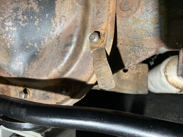

I just got under the car again yesterday, to clean up some more surface rust and prime/paint, and also to replace the rusted fuel filter holder. I used the 5.0resto mount from LMR. The bracket was a direct/100% fit and appears to be made well. It is yellow zinc coated, so hopefully will hold up nice. The wood-screw looking bolts that come with it are junk/not m6 1.0 like what was in there, so I re-used my original bolts after cleaning up the threads. Also, the hose clamp was the right size, but a different (smaller) adjustment screw (original is 8mm). While looking at the original, I noticed it was a Ford part. Probably overkill, but wire wheel and then metal polish had it looking brand new- I re-used that too. Overall, for the 41.99 that LMR wants for the 5.0 resto kit, while I am glad they offer it for folks that need it, it's kinda a rip considering wrong bolts and cheapo hose clamp.
So, now my frame rails are 100% clean, no rust, no rust-through, and primed/painted. That's good. I did discover a small area of rust through where the passenger side rear wheel well welds to the unibody at the bottom- about the size of a 50-cent piece. It's right by that box that I guess some people try to jack the car up by? The box I'm talking about is just outside where the lower control arm mounts, and this rust area is on the other side of that box at the inner wheel well. DANGIT! I cleaned up some loose stuff, and coated it in rustoleum for now. I do want to adress this properly in the future. Anyone got any experience with this? Is this a difficult fix? This is almost certainly out of my wheelhouse and I may need to take this to a body shop for that.
**EDIT** I just realized, post #90 above, the pic with the red rag on the jackstand, shows this rust very clearly. I was going back to clean up that area a bit when I found it, the rust through is only at the bottom part. Maybe from incorrect jacking in the past?
