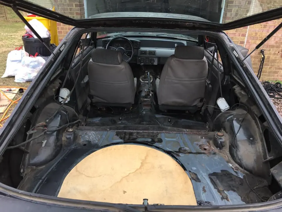

Finally I got to the point where I had a couple days off, and wanted to start reducing the clutter of boxes of stockpiled parts in the garage/closet/kitchen table/under my pillow, and actually do some work on the car and install this stuff!

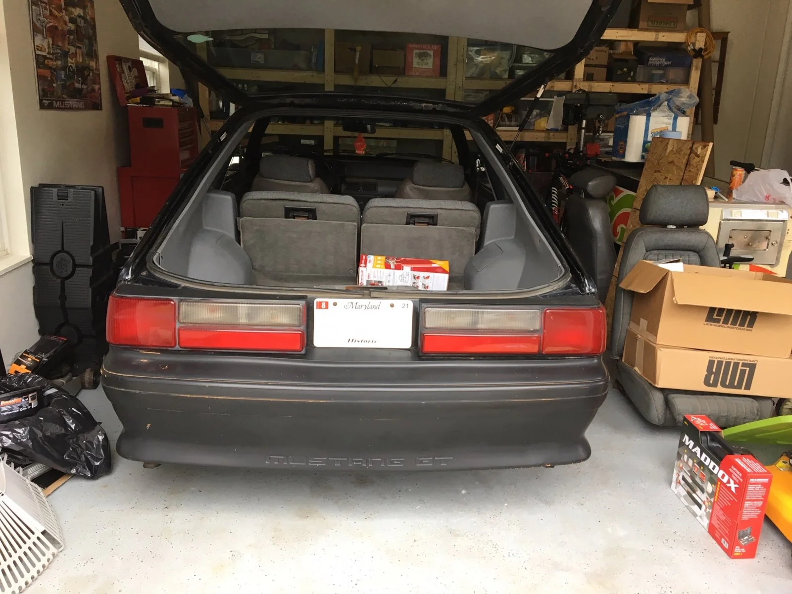

Here's what's been done so far:\
->Cleaned up the floorpan and trunkpan metal.. Put in spare tire, jack, lug wrench, and spare tire cover:

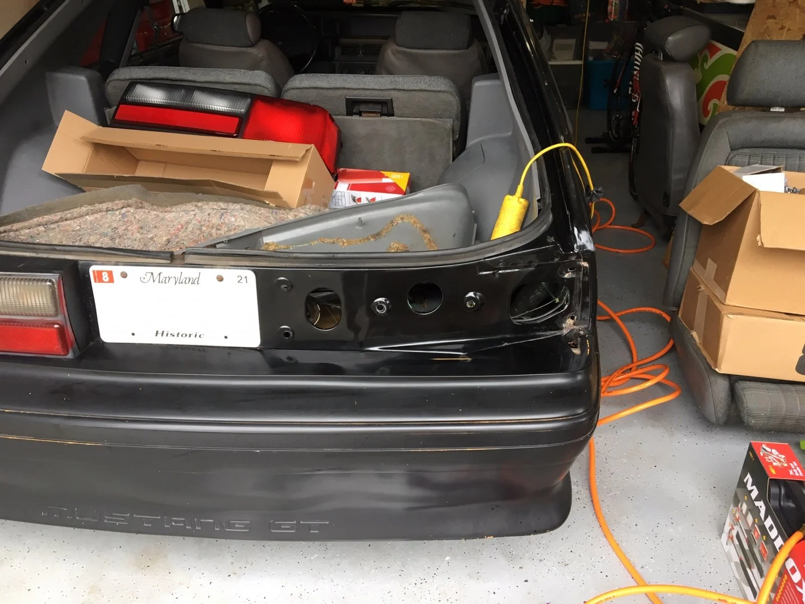

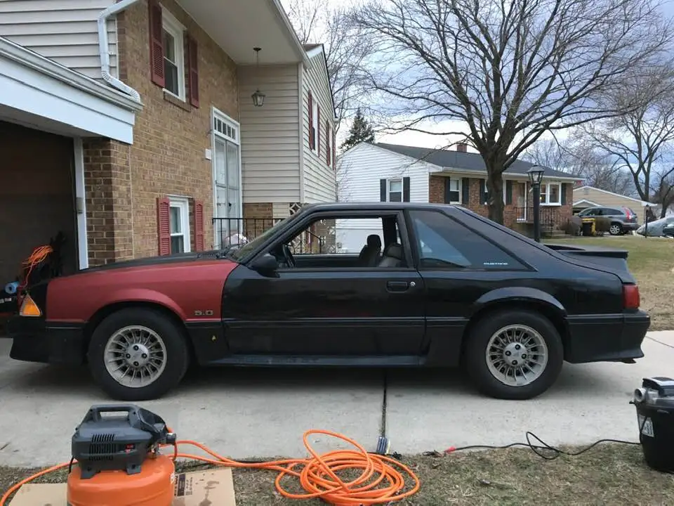

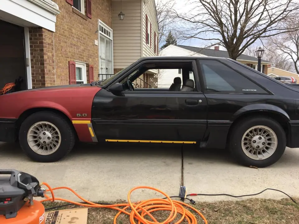

New to me Red fender installed, painted and installed ground effects brackets (yellow rustoleum was on sale!)
Body ground effects kit put back on:
Those last pics were pre-house move. Now, after moving dust has settled, I did the seam sealer, and finally opened that box of Noico sound deadening mat, and installed it on the floorpans:

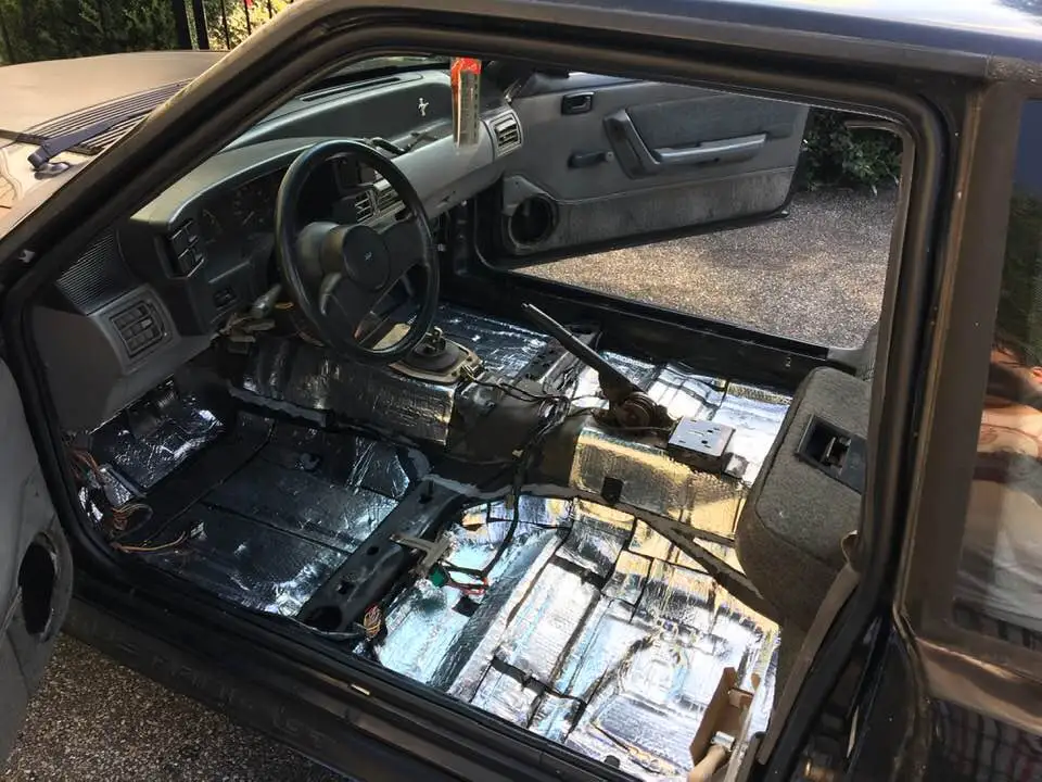

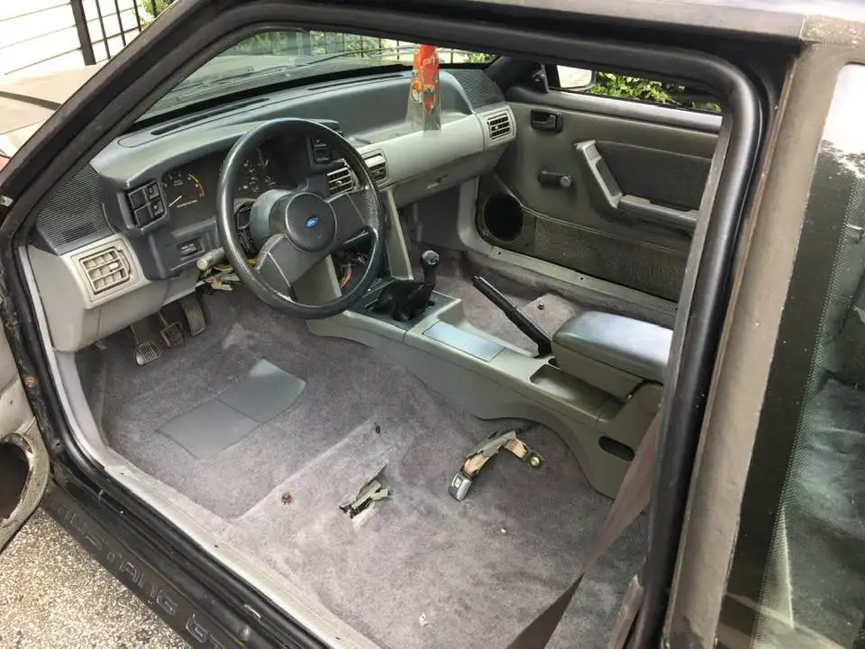

Now for the carpet install. I don't know why I put this off so long- it was SO much easier than I had thought it was going to be. Seriously, for anyone that is putting this off because it seemed like it would be hard to do and have it look right- have NO fear! Just take your time, and cut small first! I had already thrown away the old carpet- so I had nothing to use as a guide for the holes. It still wasn't hard! Made small holes for the shifter and emergency brake- then enlarged as needed once the carpet was laying in the car. Seat bolts were VERY easy- simply press down on the carpet on top of the bolt stud sticking up, and run a razor blade on top of the stud back and forth until you have a slit just big enough to press the carpet down over the stud. Perfect hole! Here's the car with basically everything done but the seats installed:
(Notice the ratty looking seat belt receivers.. I have better ones to install- just didn't have them handy at the moment this pic was taken.)
(hit my pic limit. Continued in the next post)
Ok, so here are a couple of more pics of the carpet after install. This REALLY transformed the car!!!
**I forgot to mention- before I put in the sound deadening mat, I put in all new rubber plugs in the floor pan holes.. CJPonyParts has a kit that includes them all- which was probably overkill for me, LMR sells individual plugs...**

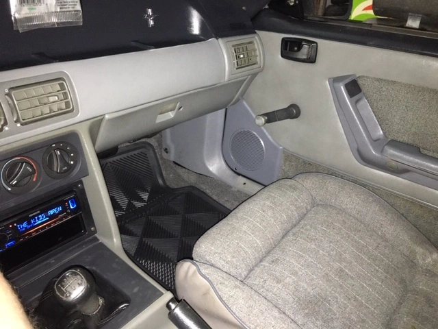

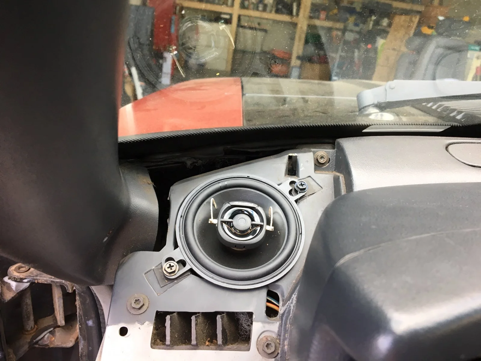

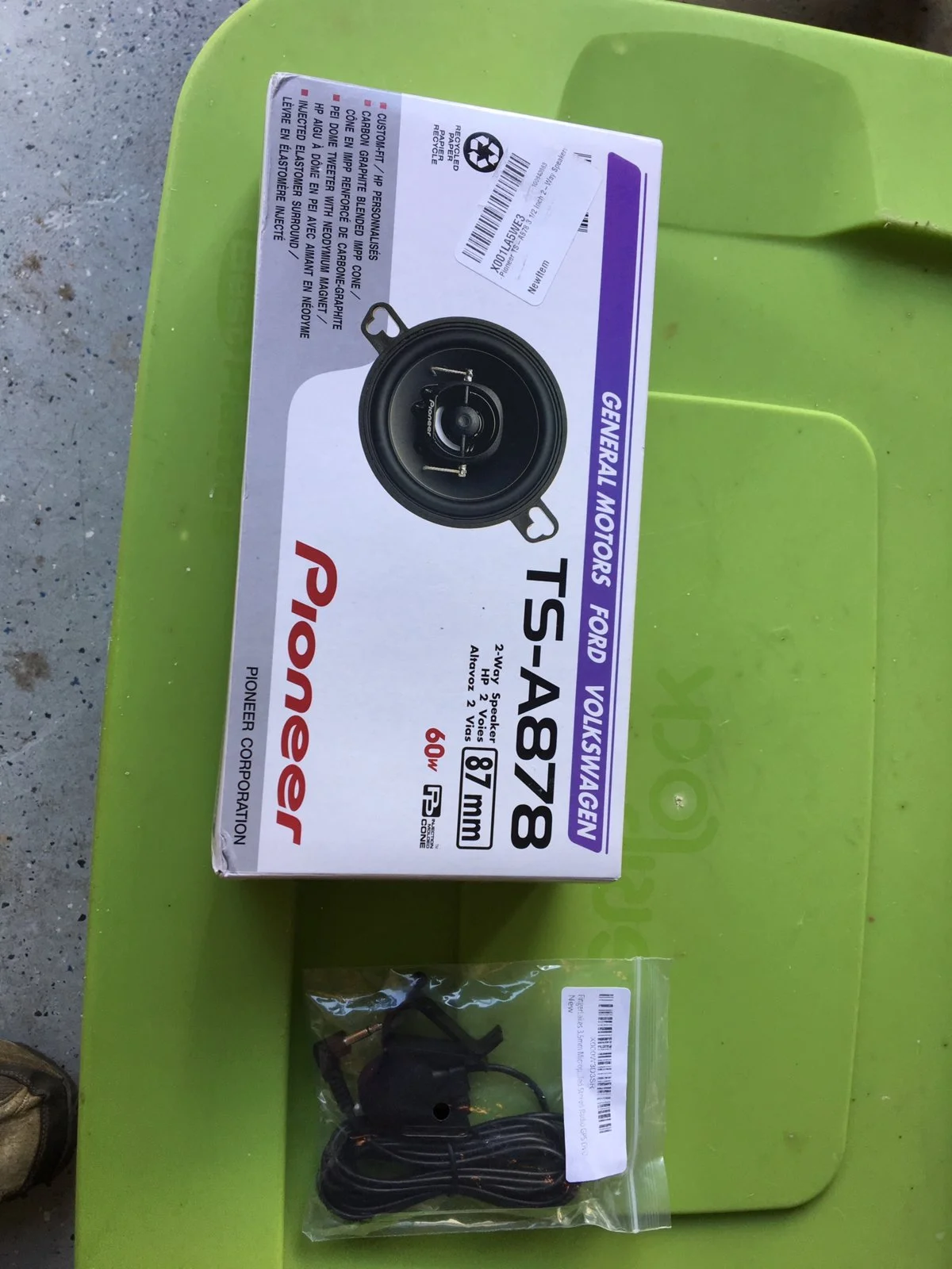

Next: Radio install. In a previous post, I shared the pics of the radio components I'd bought here and there when the price was right.. Many times, I was tempted to open all the boxes and set up the system on floor at home, just to check it out- but I was lazy and waited until the car install. I don't have any pics of the Pioneer 6x8 rear speakers without the grills, but they fit perfect, and are installed in the pic above. New speaker wires, which wasn't too bad to route inside the rear interior panel, under the scuff plate, inside the interior kick panels, under the dash, to the radio area.
I set up the radio with just the rear speakers at first.. Sounded GREAT! Much better than I'd thought. In fact, for me, it would be ample with just those speakers, except for when driving with the windows down, and not quiet exhaust, you can't hear the music. This factor (rear speakers are almost enough alone) along with my sizing up the speakers I'd bought for the doors (and finding that previous speaker installs had modded the doors such that those speakers would not mount without me pulling a MacGyver with some sheet metal), and I decided to go a different direction for the front speakers- not use the door speakers at all, and get some different/decent dash speakers (also shown is a bluetooth mic kit, 5 bucks from amazon, and works GREAT with this radio!):
New speaker wire used here too, and this could not have been easier to route... All speaker wires soldered to radio harness/connector that came with the head unit. The soldered joints were protected with shrink tube after solder, and finally the harness was made nice with wireties.. These 3.5" speakers were the perfect dash mount fit! Here is one of the speakers installed, before the grill was put back on:
(continued in next post)

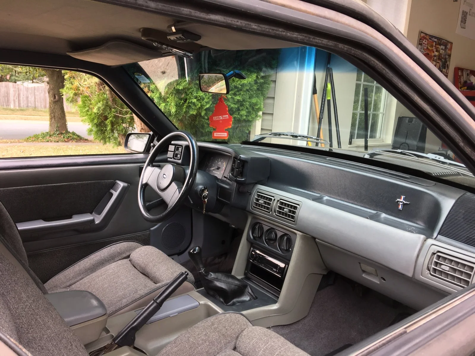

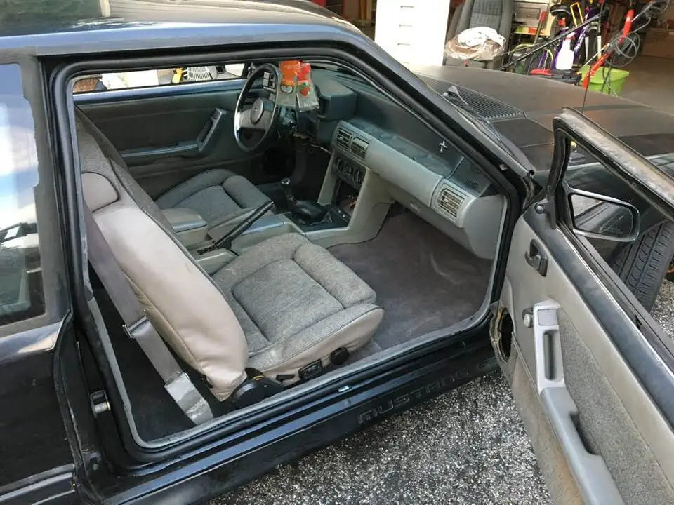

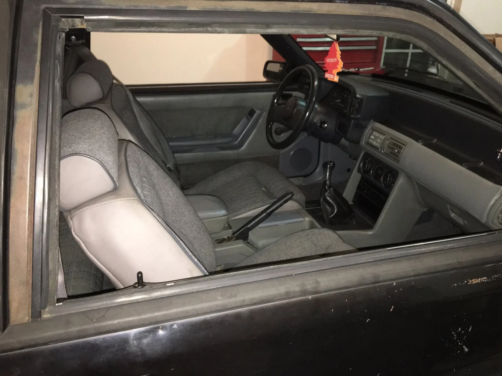

Here's how the interior currently sits:
Oh, and I forgot to mention, I also installed fresh and gapped spark plugs, new wires, to new cap & rotor. Also changed the oil and filter, and the fuel filter had been done when the fuel lines were done. I also installed the door weatherstrip seals too. Did the write-up of the seal comparison ever get finished on this forum? I think I just used the good quality ones from LMR, and they fit great.

Radio sound quality= better than expected. Clear, lots of EQ adjustability.
Radio loudness/power= ample for me. Gets easily more than loud enough (loud enough to hurt my ears, which for me is too loud) I'm sure some audiophiles will want more juice- but since I'm using the onboard amp in the radio- and am not driving any subs, just the front 3.5's and rear 6x8's, I can tell you for my opinion, the radio has enough power to reproduce the sounds and frequencies well, with no clipping, no distortion. Even pretty good bass.
Radio hands-free phone= surprisingly good! I can hear the phone with no problem. Using the little mic (mounted just to the right of the steering column, on the lower side of the gauge pod- under the switches) I've been told it sounds like I'm using a normal hold-it-up-to-your-head phone. Can't beat that for 5 bucks!
Other Radio features= fantastic for a single din, inexpensive radio! This radio is a solid buy for the low price. Although there's no CD player (anyone still using CDs?) this keeps the price down. The head unit syncs to my phone, where I keep a ton of music. It also has Pandora, Spotify, and iHeartRadio apps built in if you use any of those. Otherwise, it has AM/FM (with the radio data capability) too, and can be used with an add-on XM receiver if that is important to you. Yes, there is no nav, but, I'm sure I could just use the nav on my phone, and have it speak through the BT/car speakers.

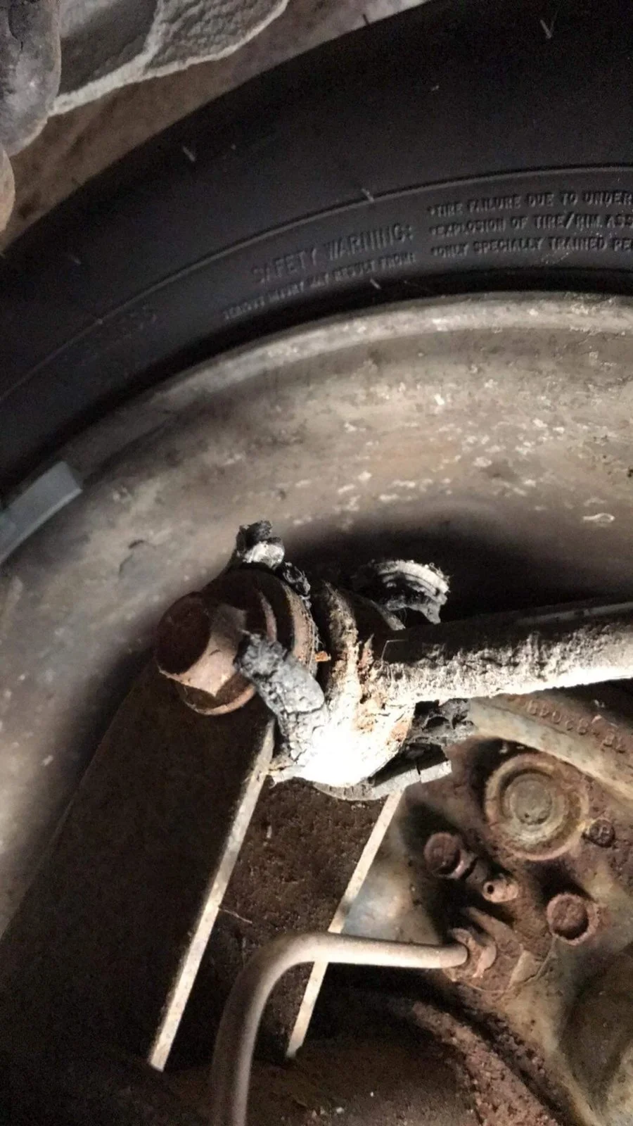

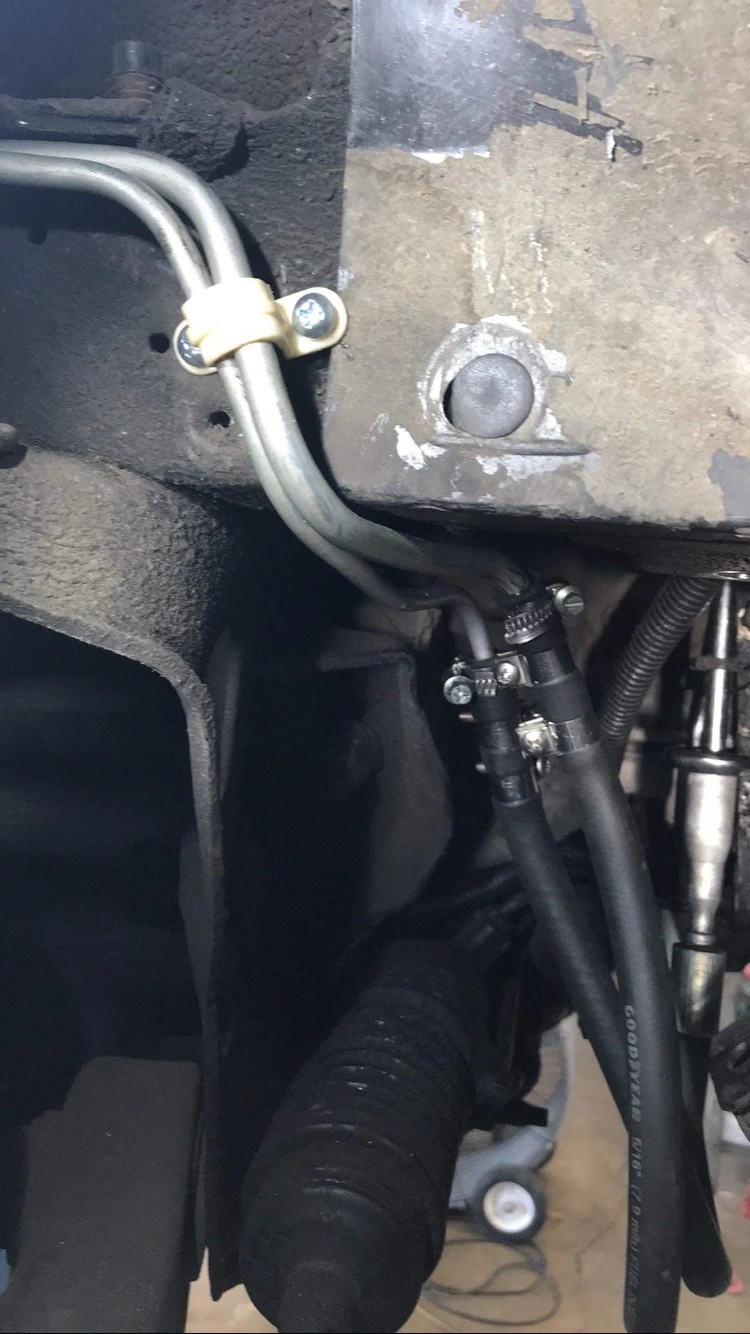

-Noticed one of my brand new fuel lines is leaking! Right behind the front right wheel, where the rubber line is joined with the metal line, it is leaking- I don't believe there is any fix for this other than a new line... @$%&!!!!!! While it's not leaving a puddle, it is getting wet with fuel. I'm gonna have to fix this. Any of you guys know how possible it is to replace a fuel line on a fox mustang with subframe connectors, without the use of a lift?

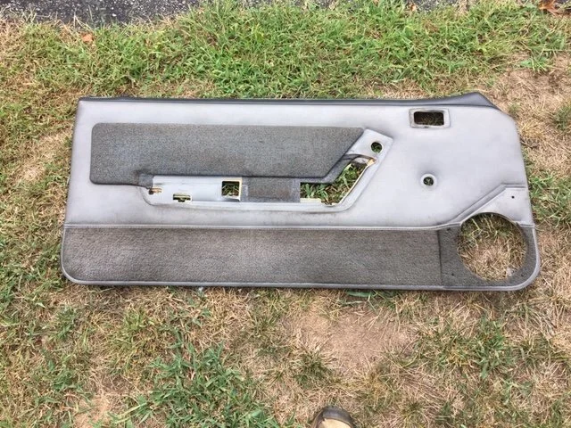

-got a lot of cleaning to do. Quick test of simple green and paper towel on door panel vinyl and plastic shows promising results. Gotta really spend some time and CLEAN!!! Need to clean the panel vents too- I don't really like to run the fan when I'm in the car until I do.
-I ordered some repro speaker covers for the doors. David Carpenter brand I believe- for around 20 or so bucks. I'll install when they come in.

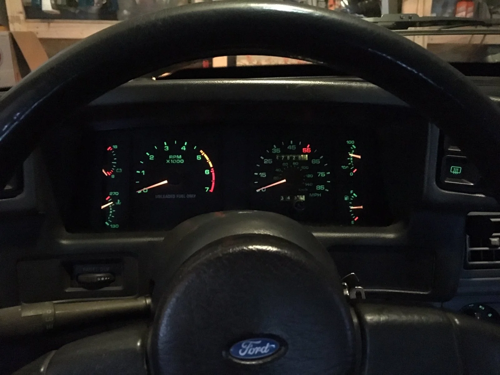

-Still need to change out one bulb in the cluster, then will put steering column plastic back in place.
Gonna tackle those fuel lines ASAP- before I drive the car more. Which sucks, because now that the carpet and radio is installed and the car is MUCH more civilized, I really want to drive it!!! First world problem, eh?

Both fuel lines were defective- at joints where the hard line meets the rubber part. I wish I could remember who I ordered those lines from- they were the non-stainless type (the thought being stainless might be too rigid, and steel was what OEM used, and might be a little easier to get to seal up if they aren't too rigid? Silly me, they freakin leaked anyways!) All I know is, the hoses say "Made in Czech Republic" on them. This isn't a dig, and I know there's a lot of great things made in Czech Republic.. It's just these fuel lines must be not too great if BOTH leaked at infancy.. A friend of mine has all the tools to make fuel lines, so he doctored up some new fittings, and we were able to fix both lines so they no longer leak. Now that I'm no longer leaking raw gasoline, on to other tasks.
(I know in the perfect world, the preference would be new fuel lines.. BUT, these are dry as a bone so far. I will frequently keep an eye on them. Thoughts?)

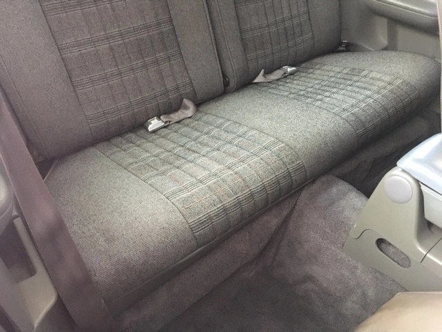

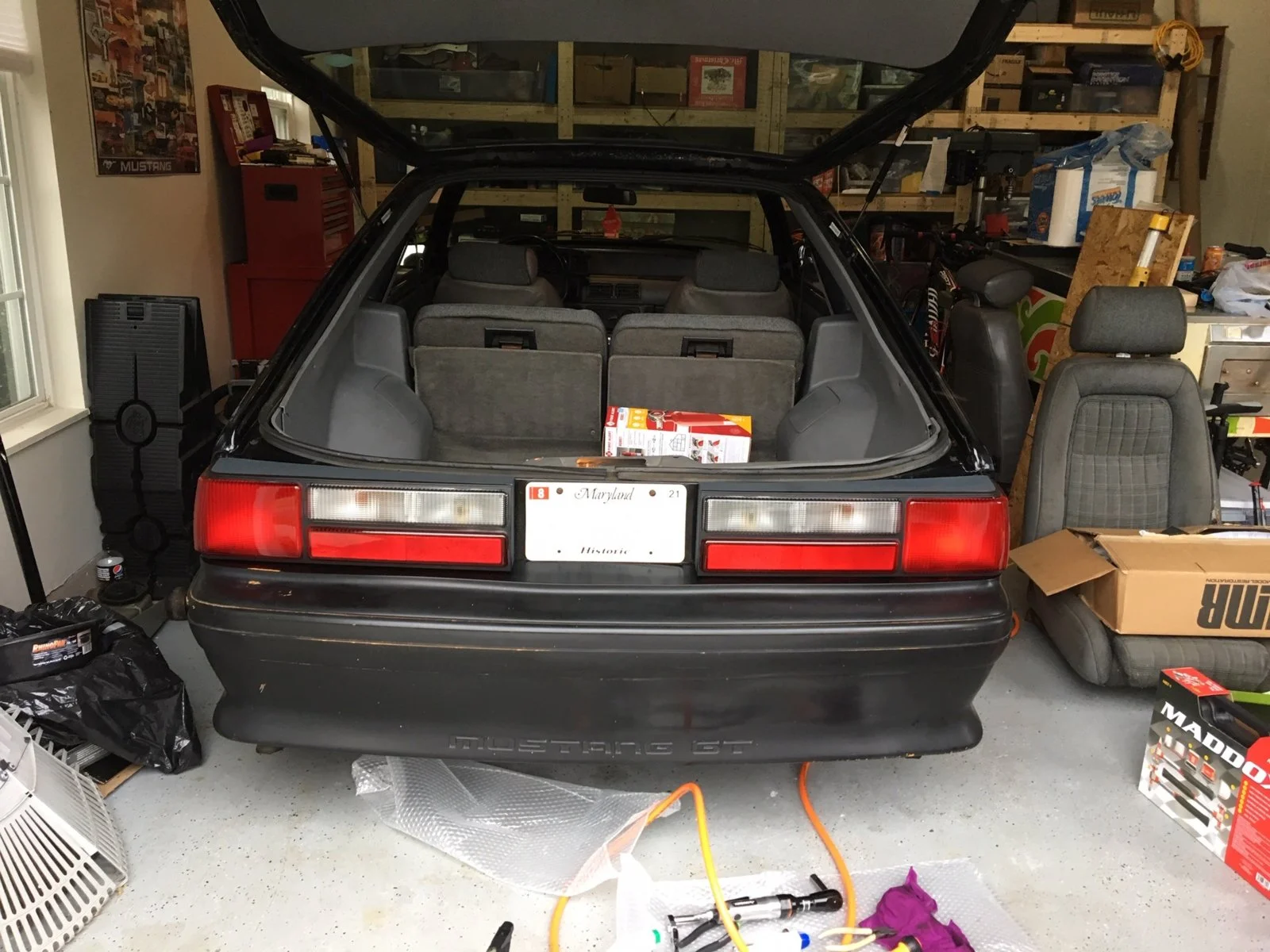

So, first, while looking at my back seat, which is all back together for the first time that I've owned the car, I noticed some various stains. Not sure if mud, grease, oil, BigMac from 1990, etc. I bought some foaming "Shout!" upholstery cleaner- which comes with a little scrub brush as part of the cap from Advanced Auto.. I hit the stains on the back seat, and was happy to see what appears to be a 95% reduction. I'll keep hitting it again from time to time, but wanted to space it out so that the fabric and cushion foam don't get too wet. Plus, the cleaner foam appears to have a deodorizer- which made my whole car smell like wash day at granny's house. It's not bad, but a little too non-car smelling. :) Don't have any pics of the stain removal here at the moment.

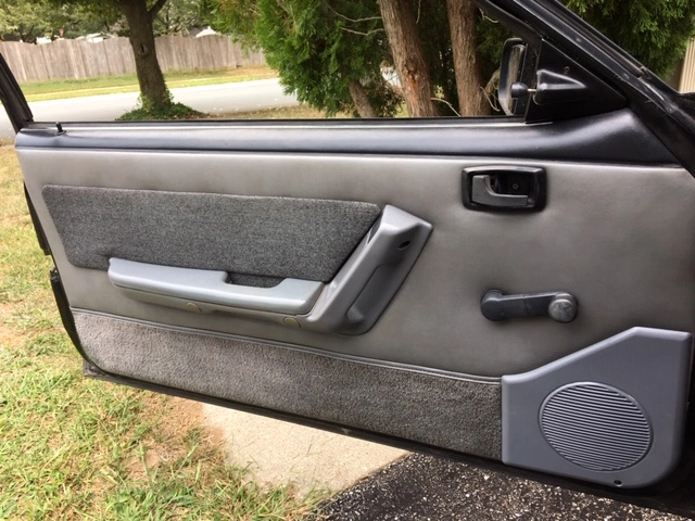

Next, I wanted to install the remanufactured door speaker covers- as my current stereo install isn't using the door speakers, and they were nasty looking holes for any casual observer to see. To install the speaker covers, you gotta take the door panels off to fasten the speaker covers to the back side of the panel, so I used this opportunity to use the "Shout!" special cleaning sauce and then re-assemble:
Before:
After:
I don't know how easy it is to tell from the pic, but this made a HUGE difference!

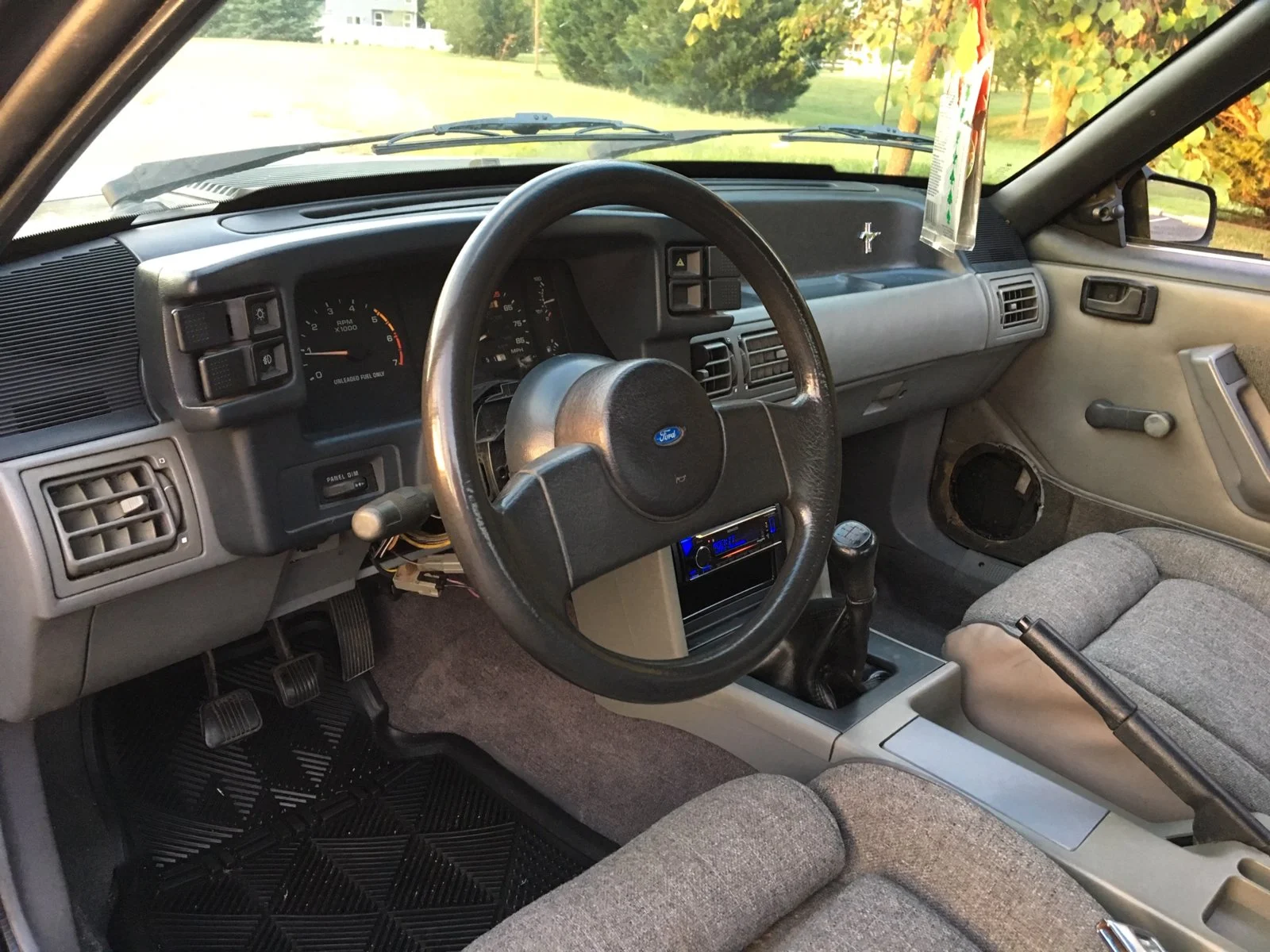

Then, I turned my attention to finishing the interior. If I may, let me stress: If you get a mustang like mine- which came with the interior completely out of it, you really should get yourself a complete interior screw kit from LMR (or wherever you buy your parts).. This has been so valuable, as 97% of my fasteners were missing, and the ones that were there were rusty or nasty.
I installed the coat hanger hooks, I FINALLY replaced the bulb socket under the fuel gauge, so that my instrument cluster FINALLY is 100% lit, and put the steering column plastics back in:
(PS: The car does not overheat- never seems to go above the A in NormAl.. When you run the car, then turn it off, then turn on the lights, the cluster shows like this pic- if I turn the car back on and either start or don't start the motor, the temp gauge goes back to A in Normal.. I'm guessing this is a characteristic of the car's electronics?)

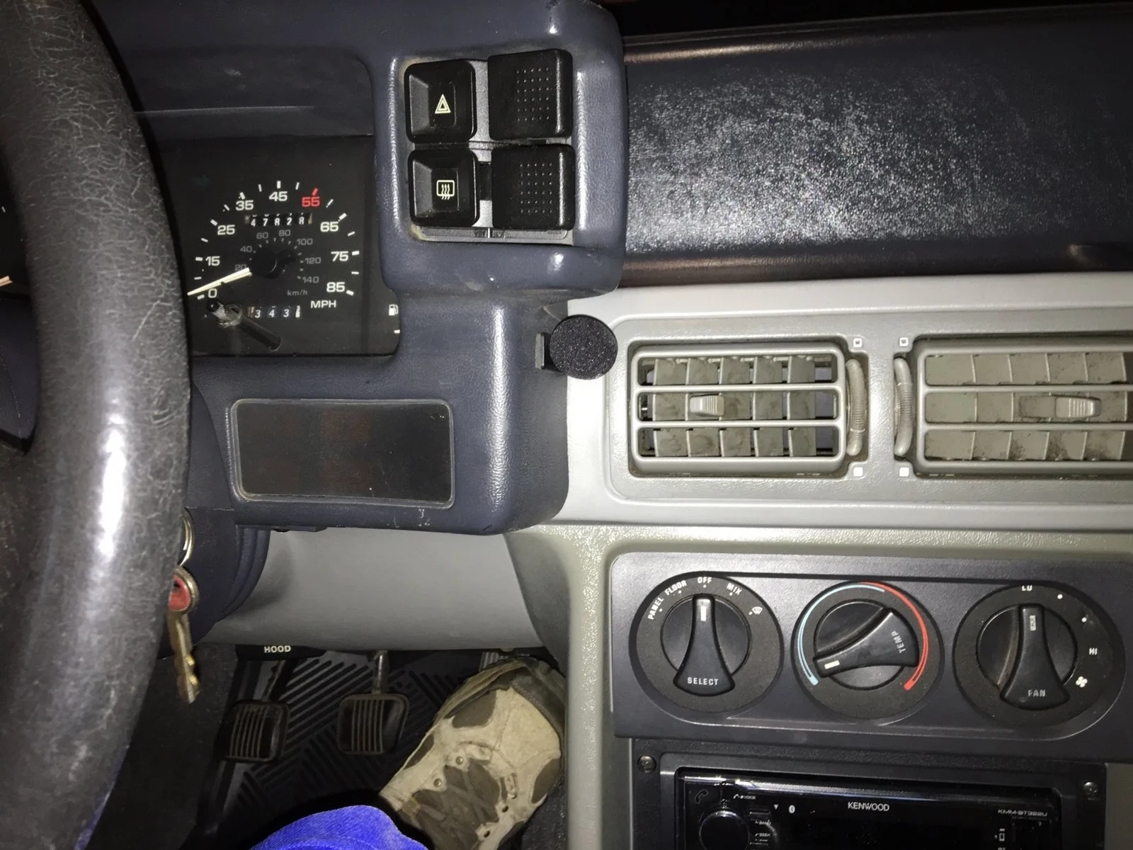

And, notice: We now have bluetooth handsfree calling from this old machine!!! Here's where I mounted my mic. I am totally digging the single DIN, Kenwood BTT322U. I got it for like $69 bucks on sale, and I was at first mad at myself for cheaping out/not getting a double DIN touchscreen NAV number. BUT, this has left me with cash to do other things, and, all things considered is totally more-than-adequate for the car.

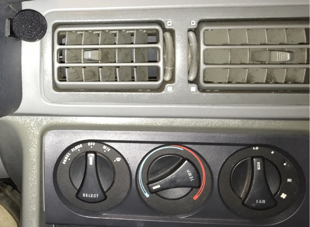

(PS: D00d! I gotta clean those vents! Seems like they might be a bit brittle to remove.. Q-tips and simple green?)

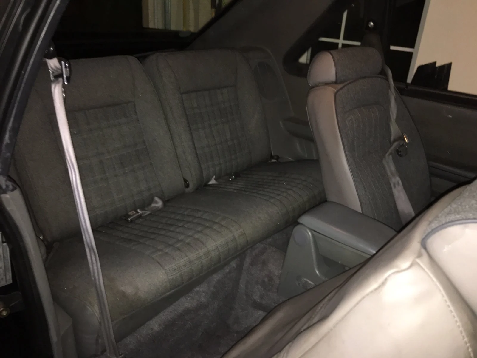

So, here's the backseat again- before cleaning:
..and, after cleaning (still need to hit it one or two more times, but this is after perhaps 3 cleanings with the Shout!):

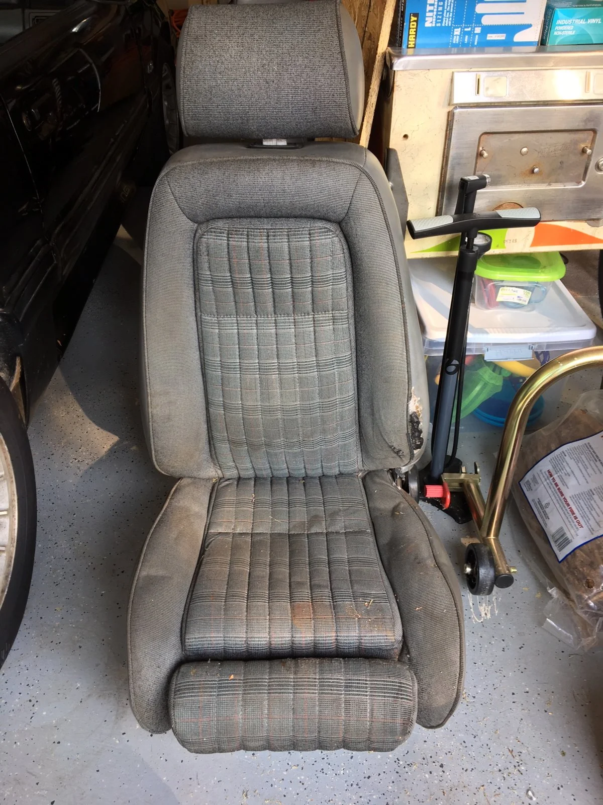

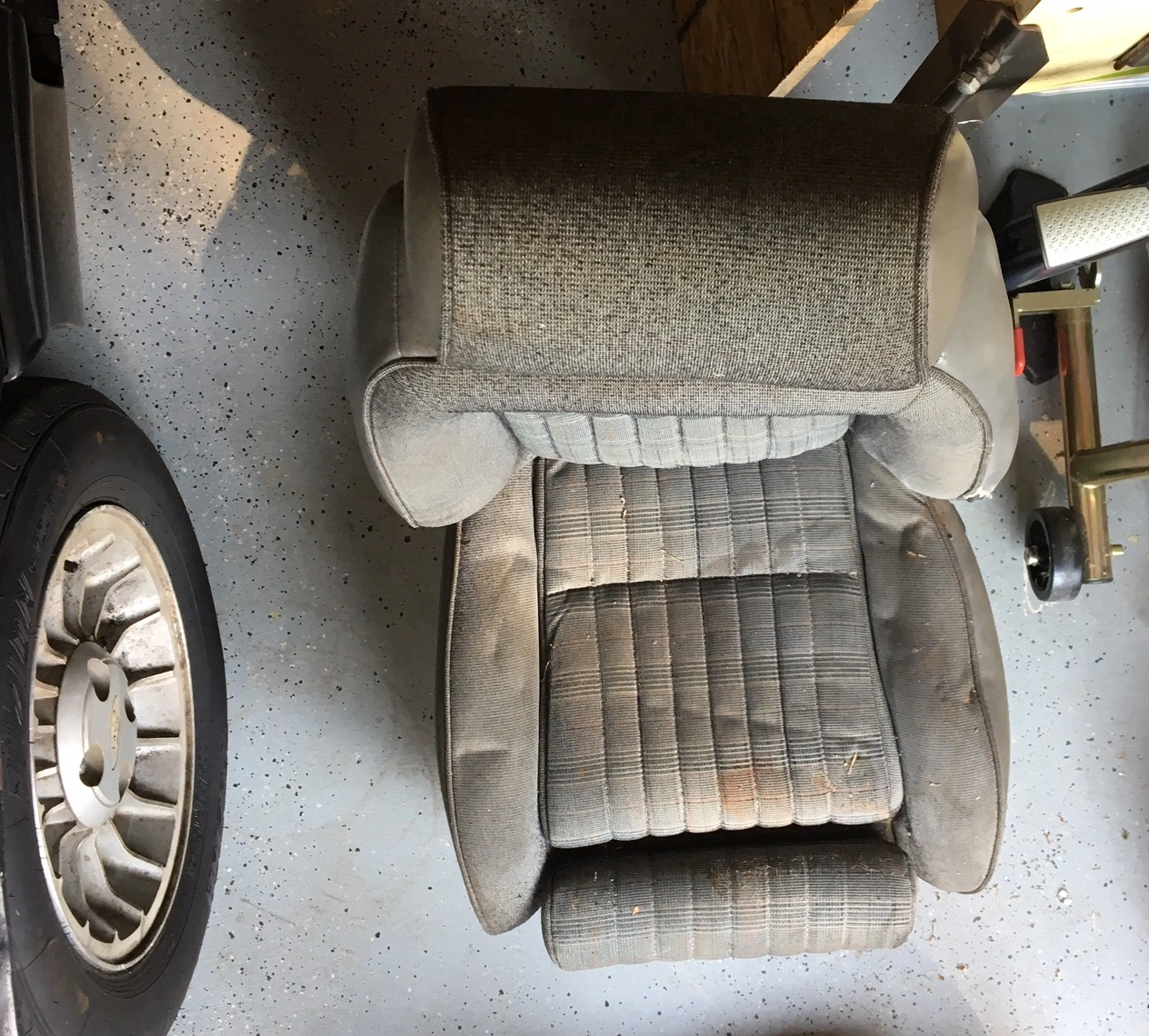

As for my front seats.. You may remember, an earlier post I mentioned I'd bought recovered seats from the guy who has a mustang junkyard- $75 bucks. They look pretty good- no tears, but, they don't match the grey plaid like my original seats do. The original passenger seat is great- no tears, not too stained up (I'll need to use the foam cleaner on it, but, overall I think it will clean up and look fine!).. The driver's seat however, has a tear in the bolster vinyl, and also is twisted (the replacement seat is twisted too- must be common? I know I mentioned this before, and in this thread someone mentioned it was their floorpan cracked. However, I've just put in new pans, and also new/reconditioned seat reinforcement panels to match stock, top and bottom.) Here's a couple pics of my seat- the top-view so that you can see the twist...
(Yeah, I gotta clean it up too!)
(see that twist?)
Wonder how that twist happens- broken seat frame? I may call around a couple upholstery shops to see what they'd charge to recondition the seat.. I saw a guy selling mint seats like this- same color and pattern, but he wanted $500.00 for both. I'd rather fix mine if I can do it for cheaper. The whole theme of this project has been, keep this car close to stock, and make it as nice as possible without just blindly spending $$$$..

Just an FYI - the seat is an easy fix, but a bit time consuming. Remove the seat covers that are held on with hog rings. I HIGHLY recommend throwing the covers in the washing machine, it cleans them excellently. Remove the foam (consider replacing if it is too far gone - however it isn’t particularly cheap) and once you have exposed the seat frame you will see where the spot welds have separated. Fix these areas (reinforcing welds on both sides) clean up any rust and repaint, then put it all back together. You will have to buy hog rings, they are not reusable and you will destroy them in disassembly.
There is a good write up with pictures that walks you through here...
That’s a link to how my seats turned out after washing them. Hand washed for the major dirt, then through the washing machine.

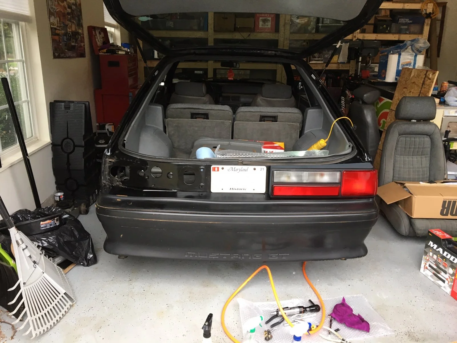

Here's the old tailights (what the picture really doesn't show is- yellowed, dried & cracked lenses, badly broken stop lamp section, broken off mounting tabs, etc.):
In progress:
Tailights done:
Gotta hand it to whoever makes these taillights- supposedly original tooling, made in USA? They look great! The main difference I could tell is, my originals were black on the top (which you cannot see once the hatch is closed..) These new ones are grey on the top. The lens portion appears identical (but new of course, and un-broken). They appear to be sealed up well, and they fit great- literally plug and play. I'm not sure if the pictures do them justice- but they really look MUCH better, and look fantastic. If you are on the fence about these (like I was), I highly recommend them- no buyer's remorse.

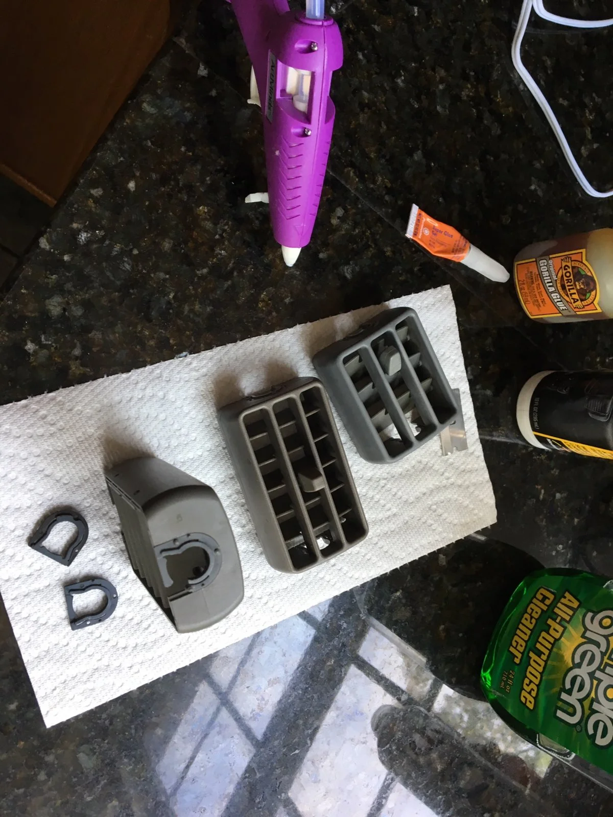

Remember when I showed you how my dash vent louvers looked like they had syphilis?
Well, I took them out, and cleaned them with simple green, soap, water, and scrub brushing.. I then dried them, and armor-all'd them. They look great now, but, I broke the clips on some of them when I was removing them.. Online searching for these clips yielded nothing (not surprised!) and replacements can be bought online but I'm trying to not spend a ton of money to fix everything via replacement (replacement vents- which are hella expensive, and not smoke grey like my interior...) So, I decided to think about this for a bit, and while I had the vents out, I turned a few paper towels black with the dirt that I removed from the interior of the vents.. YUCK!
While I was searching online for the vents, I stopped by this forum, and read for a bit- ADD took over, I admit! BUT! I read someone here asking how to make the seatbelt light on the instrument cluster not light up. Wait?! What seatbelt light? I check mine (I looked at an old spare broken cluster I had bought months ago for parts, and confirmed- there is a seatbelt light. I consult my "Ford Electrical & Vacuum Trouble-Shooting Manual" scored off ebay many moons ago- and it turns out, the seatbelt light, and my non-functioning "chimes" are part of the same circuit. I like chimes! (In the voice of Arnold Schwarzenegger: "GET TO DA CHIMES!") Seriously, I know this might sound cheesy- but I want the seatbelt light, I want the chimes.. I want this car to be 100% (or as close as practical) to what woulda been in service in the early '90s when my buddies all had these cars..
So, after confirming at the module connector power, ground, and key in ignition signal, I took apart the chime module itself. a busted varistor and a chip that was split in half, as well as a large burn mark made me realize- the chime module let out the magic smoke long ago! (I have no idea how this could of happened- someone shorted part of the car, but wouldn't a fuse have saved it? OR, perhaps someone welding on the car without disconnecting the battery?) I decide to go BACK to the ghetto junkyard in Baltimore, because I know there are 4 fox cars there, and that would be my best chance of getting a chime module cheap. Also- I can see if any of those cars have the dash vents without broken clips. They had a chime module out of a same year 'stang, so I gravved it. Also they had many vents, but none the right color. I grabbed some anyways, with good clips- hoping I could make the clips work with my original vents.
I made it home from Baltimore without any stolen tools or bodily injury, (gracias a Dios!) plug in the chime module, and the seatbelt light and chimes are now WORKING! Yeah! Now for the vents:

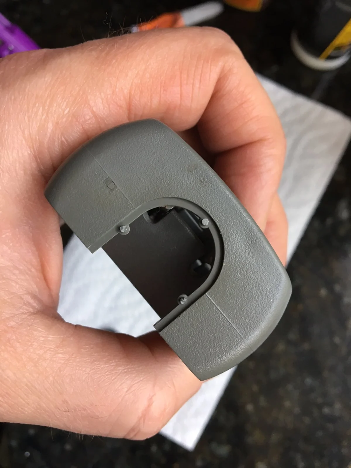

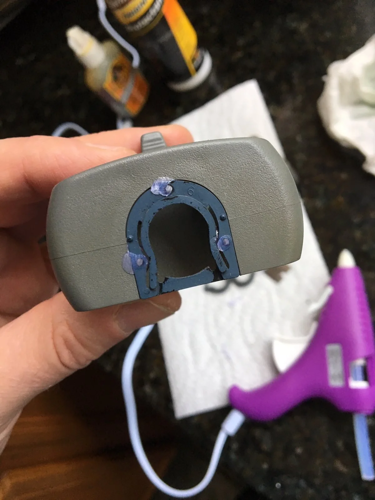

Here's what I'm working with: clips I salvaged off wrong color vents with good clips- you just have to shave off the little plastic beads in three places on each clip- and then it comes off the vent. Just a standard razor blade seems to be the right tool for this.
I borrowed my daughter's glue gun, put three spots of hot glue on each clip (one hot glue blob on each clip hole- on the side of the clip that goes against the vent), and then hold it in place (I degreased both plastic clip and vent with simple green first). A little bit of the hot glue goes through each hole in the clip with the pin from the vent, and dries on the other side. The unbroken clips seem to be fastened pretty well to the cleaned vents (yet it is "serviceable" if the clips ever get broken again. This is why I used hot glue and not epoxy or super glue..) Awesome!
I did this to each original, cleaned vent where there was a broken clip, trimmed off the excess hot glue with a razor blade, and then gently/carefully installed them without breaking them. If you're patient- it appears to install without breaking every time (or at least on all of the ones I had to repair).. Here's the finished product- cleaned, re-clipped, installed.
