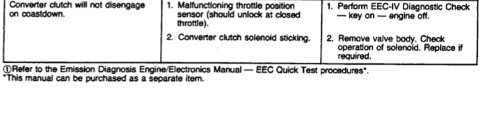

Found the attached in a diagnostic manual, suggests tps or converter clutch solenoid
No codes for tps, but I’ll voltmeter it just to be sure…

My experience in used cars for 20 years is that TCC Solenoid is rarely the actual issue - they get jammed up my foreign materials in the fluid more often (such as burned clutch materials) which is why I would recommend a complete overhaul as opposed to going in and replacing the solenoid.
