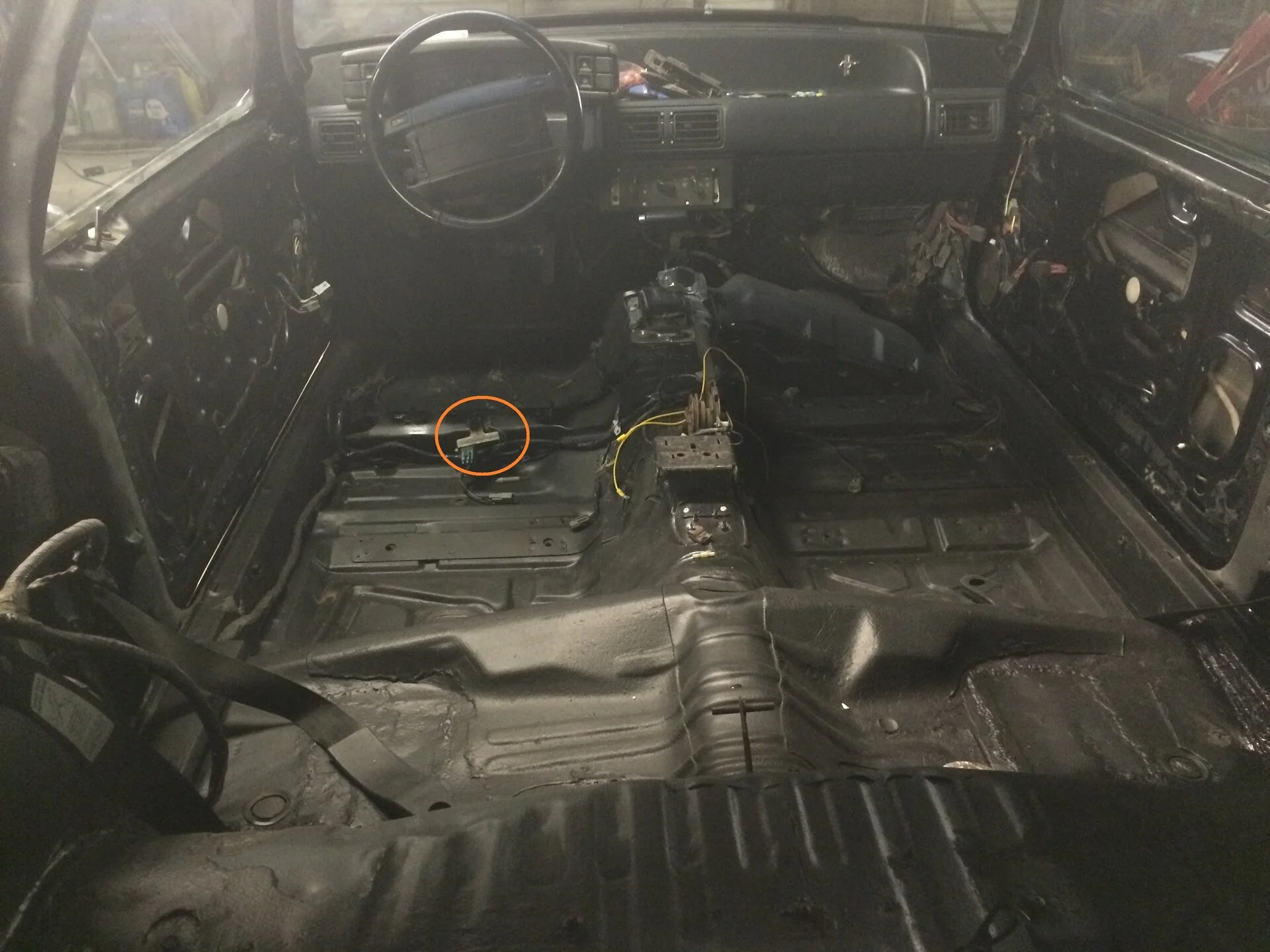

Also, just found out there is apparently a fuel pump relay under the drivers seat. If I can get to that and pull it would the draw go away if the fuel pump is the issue? Assuming it even can be the issue....
If you pull the fuel pump relay, the fuel pump will not get any power. So yes, if you are getting the draw and then pull the relay and the draw goes away, it is something in the fuel pump.
Did you say you still had the stock alternator? If so to check, pull all the plugs from the alternator (I don't remember how many as I went 3G when putting my 90 GT back together - I bought it in pieces).
Move the seat all the way back. There is a bracket that the relay mounts to about middle of the seat (width wise) just behind the front seat mount structure on the floor. Undo the 4 seat mount bolts if you want if it is your first time (it helps to see the plug and relay), but I have disconnected many times without removing the seat.
Bracket and relay circled
