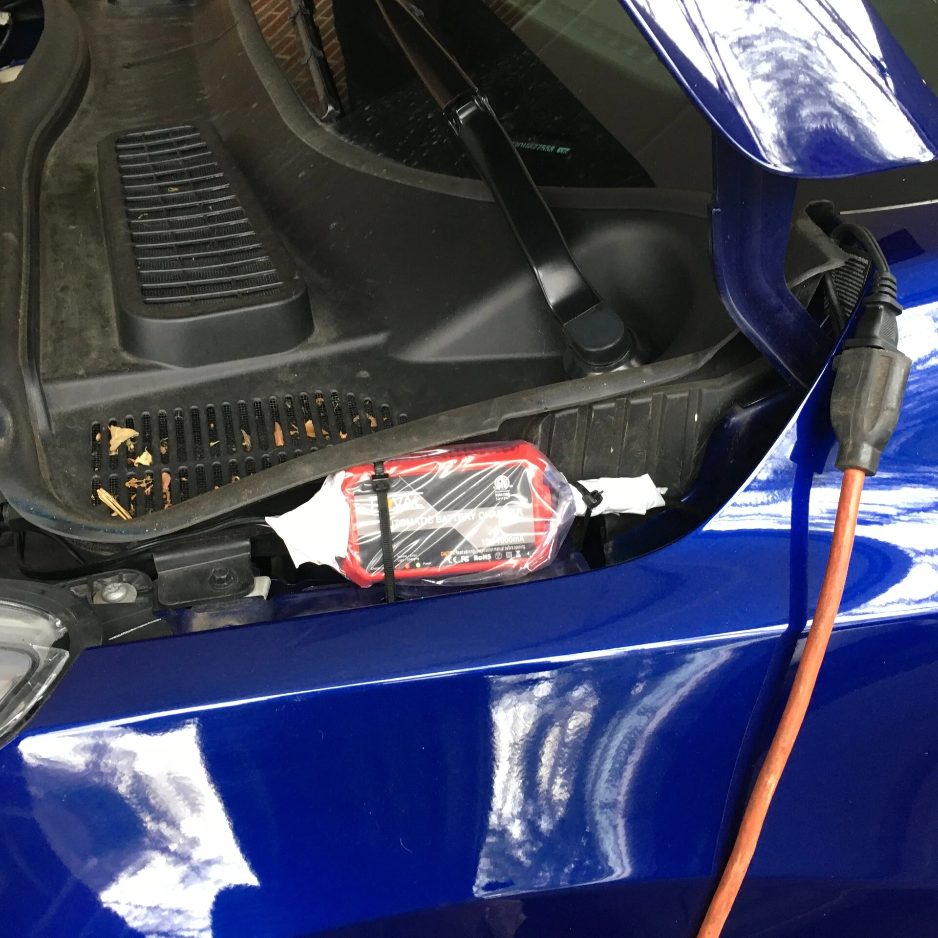

Here’s the Foval installed in the 2013 Escape. Believe it or not since new it’s had a defect in the sunroof motor which causes a parasitic draw of 200 milliamperes. I got tired of remote starting it every other day just to keep the battery up. So that, and the fact it doesn’t get driven enough is the reason for the float charger install.
On this install I have it wrapped in a ziplock baggy to provide some moisture protection. Don’t worry about it overheating because it’s only a 1 amp trickle max and hardly develops any heat.

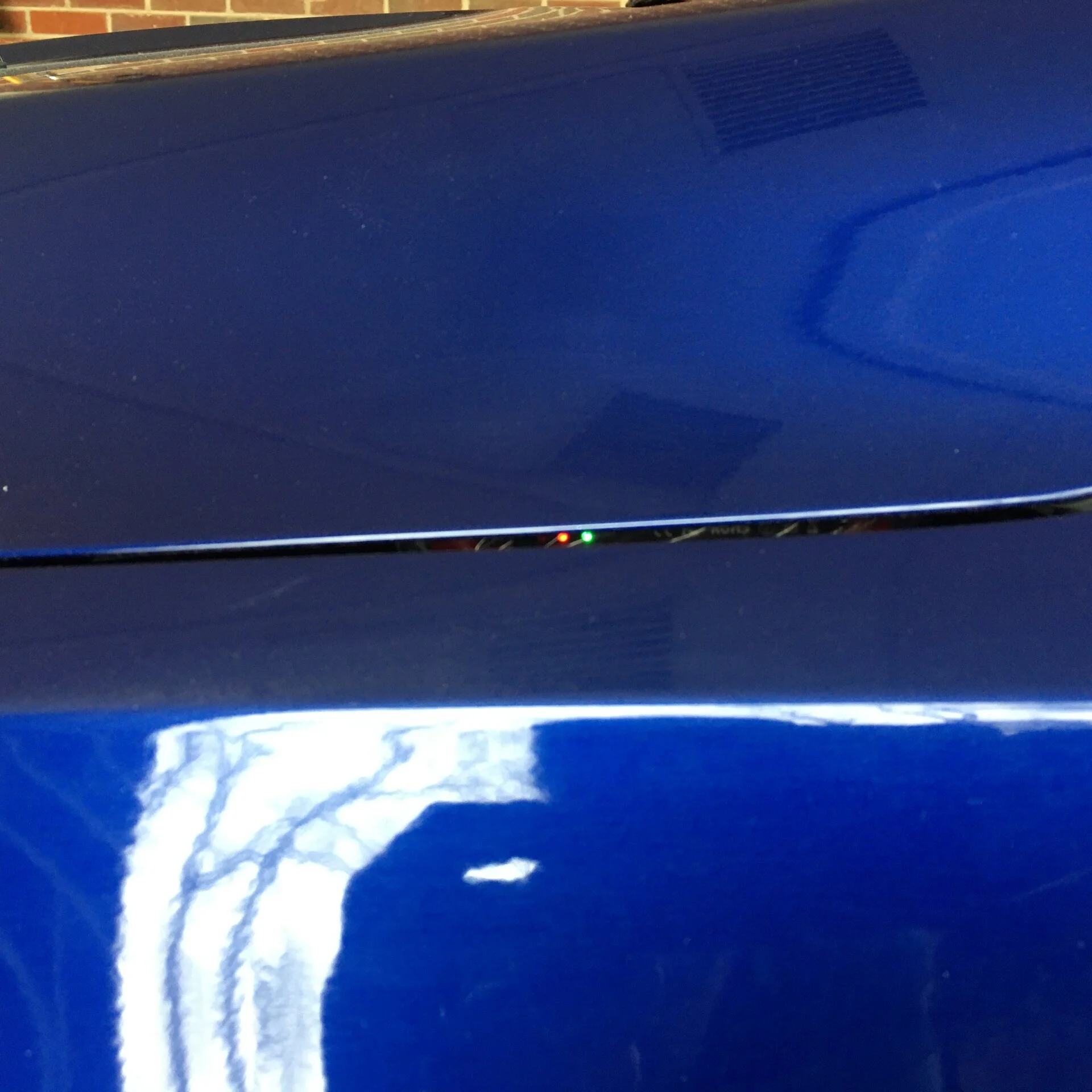

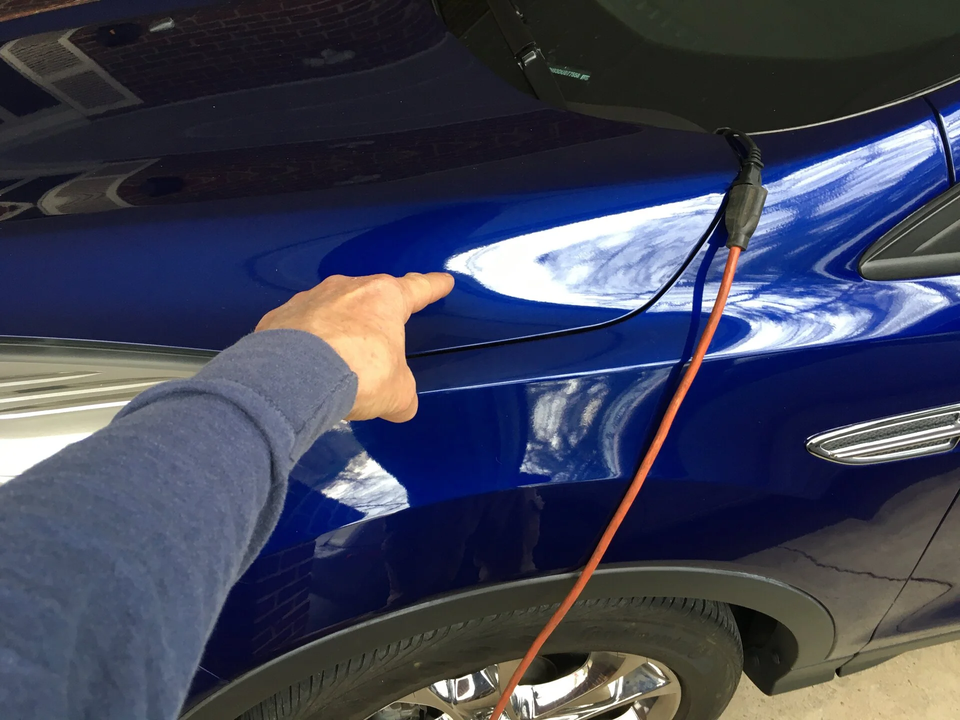

The cord peeks out of the cowl for easy connection. The position of the charger even lets me monitor the status lights through the body seam when the hood is closed.
