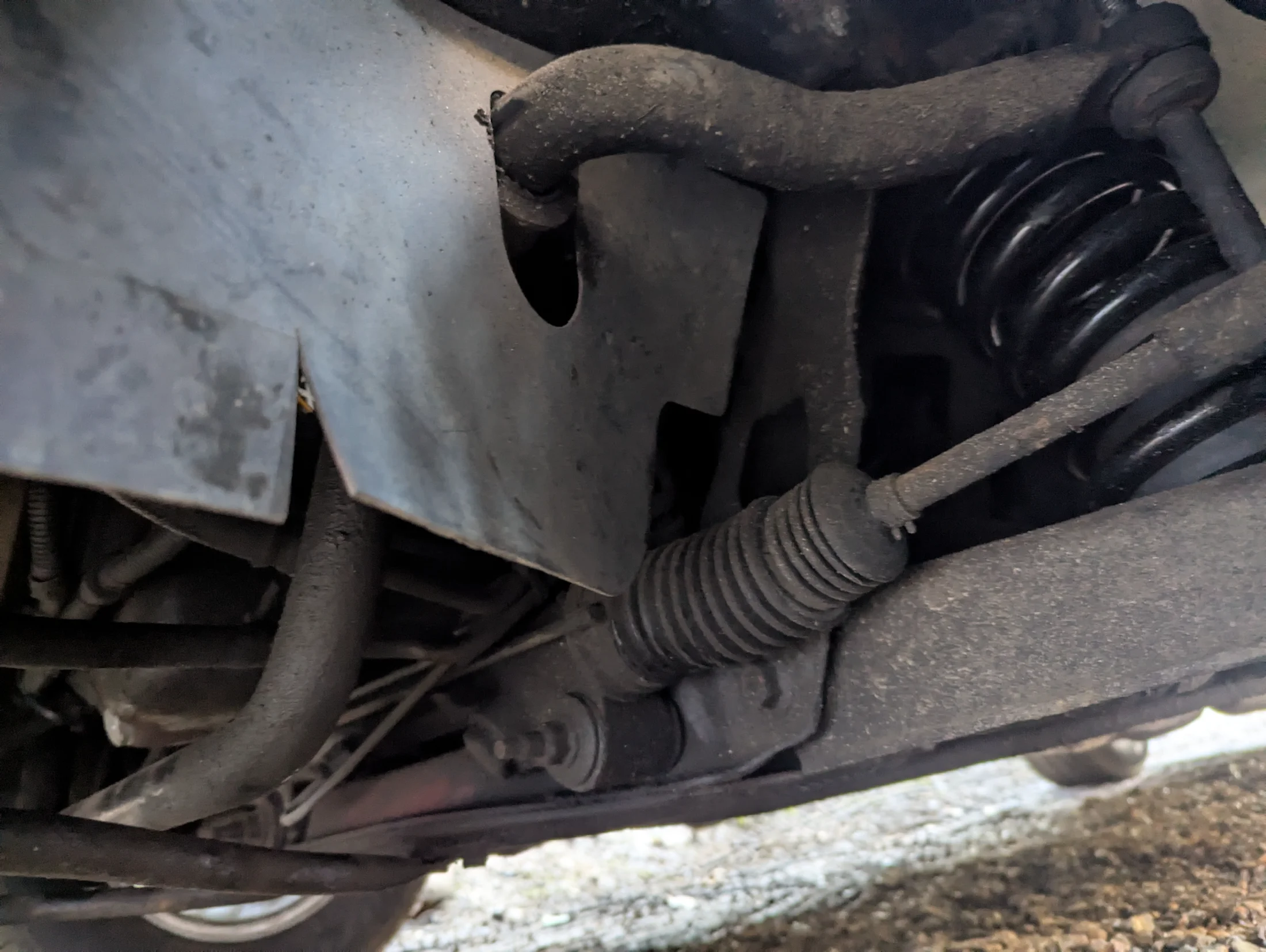

Hi again, does this sway bar look normal size? Wondering if a previous owner removed the stock one and wanted a firmer ride over stock as this one seems big, thank you
It's been a minute since I've been under my 87, but it looks close. Have you measured the diameter? Doing so would confirm if it's the original size.
Or 1.3125" which confirms the one the OP has on his car is the OEM piece. Just by looking at the sway bar bushings on the frame mounts and what appears to be missing isolators on the top of the end of the sway bar where the sway bar end links are I would say you need all new bushings for the sway bar including new end links and the lower control arms probably need new bushings as well.
