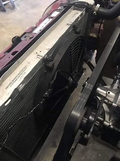

I thought water pump too, this is the 3rd one we have changed. No underdrive pulleys, I did delete the A/C though. Yes, there is a overflow bottle on the car. I have a attached a picture of the fan on the car, I am wondering if it needs a better shroud? What is your process on burping the system?

that fan is most likely your problem.
1. it doesnt cover 1/2 the surface area of the radiator
2. there is no shroud
3. I bet it doesnt pull sufficient CFM You want at least 2500 cfm. The stock clutch fan pulls 3000.
I didnt ask about A/C delete. If you are running an underdrive crank and water pump pulley, remove them and put the stock ones back on. They are a waste of money and cause cooling problems.
EIther put a stock clutch fan back on or get a mid 90's v6 3.0liter Taurus fan and a flex a lite 33054 controller, and I bet your problem will be solved.

Did the Taurus fan and FAL controller. Seems to have fixed my cooling problems. Let the car sit outside at idle for an hour and it never went over 180*.
