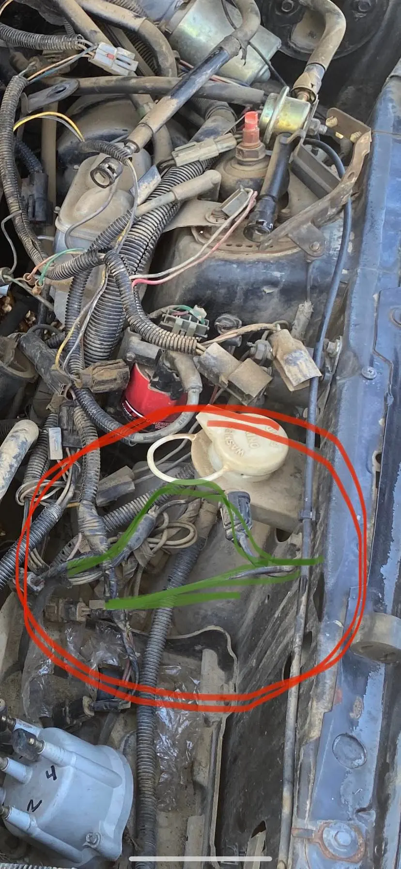

Might be your black ecu ground connector "green in pic" ?? Mine was running fine I moved a couple wires close to it to secure to fenderwell n no spark or injector pulse?... I pushed it together n it moved so little I wasn't sure it moved at all, hit key n it started right up. This is pic is an SVO so yours may be in a diff place ??

thanks for that info I'll check my ecu ground connector.
