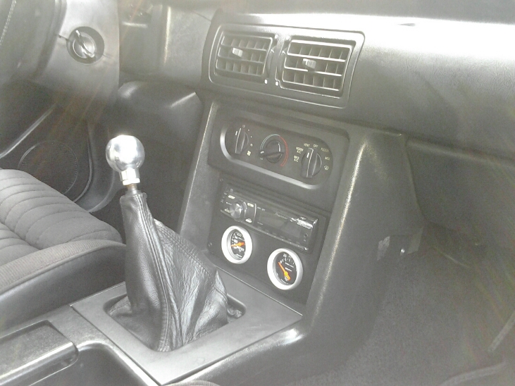

well, I got my gauges installed today. Turned out pretty sweet.
