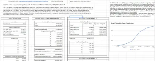

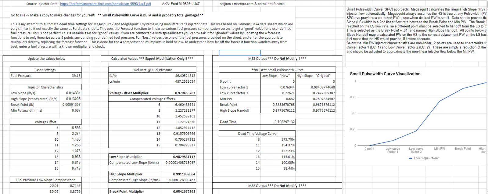

I just plugged in the calibration info for the 47lb'ers so just wanted to show my result here for a sanity check

looks correct, did you just link the injector data to the table or did you have to manually input the data?

Cool, I manually entered the data from the calibration sheet into the MS calculator spreadsheet. I copy pasted everything so it should be right, but I know you're running the same injectors so just wanted to show what I had in case it looked different that what you have.
