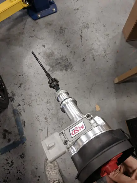

Hey guys, so it was a hell of a night lol. I pulled out the distributor to put the MSD break-in lube on it that I forgot to do when I installed it and had trouble getting it to come out all the way (as @General karthief and @Noobz347 know because they helped talk me through it). After a little pulling I was able to get it out, but the damn oil pump shaft came out WITH the distributor :(
No bueno! I tried to look in with a flashlight and used a small magnet to try and see if I could pick up the clip (or likely pieces of it) but was unsuccessful.
As much as I hated to do it, I just went ahead and put things back together because there's no way I can pull the oil pan at this point. I started it up and oil pressure was good and I didn't hear any strange noises or anything so I went ahead and set the initial timing and took a datalog.
I'm just hoping that the clip/pieces fall to the bottom of the pan and stick to the magnetic plugs and I can pull them out with the next oil change. If you guys have any recommendations, please let me know. I know it's silly to chance it but I JUST changed the oil from the first several days of idle tuning and really don't want to change it again already :/
Buy a new oil drain pan, drain the oil, then pour it back in the engine with a screen on the end of the spout? I'd be a nightmare if those pieces hurt the engine. Probably worth the 10 bucks to check it.
Great idea! Damn I'm tired, it seems so obvious... Thanks man, I'll do that tomorrow night.
