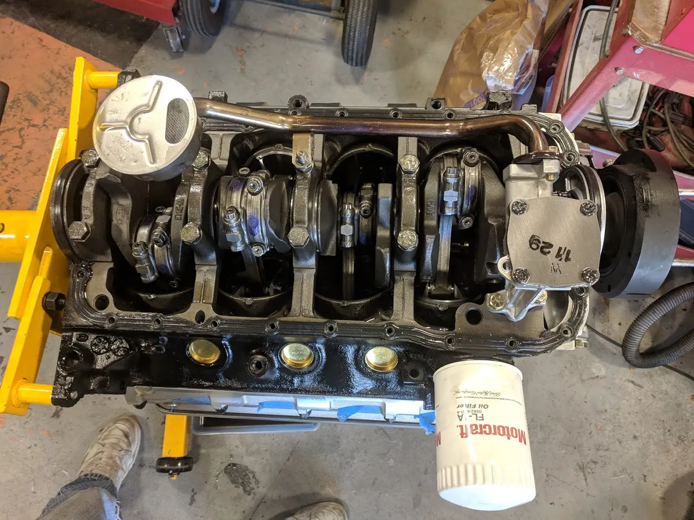

I drained the oil as soon as I got to the shop today and strained it out of the oil drain pan and found no retainer clip or metal pieces. I then tried to use a flexible magnet in both the front and rear drain plug areas along with the strongest magnet I had dragging along the bottom of the pan and had no luck finding the retainer :/

Oh and I just dug through pictures from back in January when we pulled the pan off to weld in the turbo oil drain bung and I was happy to see that the oil pump pickup has a pretty fine screen on it! That makes me feel at least a little bit better about the clip not getting sucked up into the pump :)
It was so long ago at this point that I couldn't remember what the pickup looked like and google images had me worried with pictures like this one that didn't appear to have a screen at all.

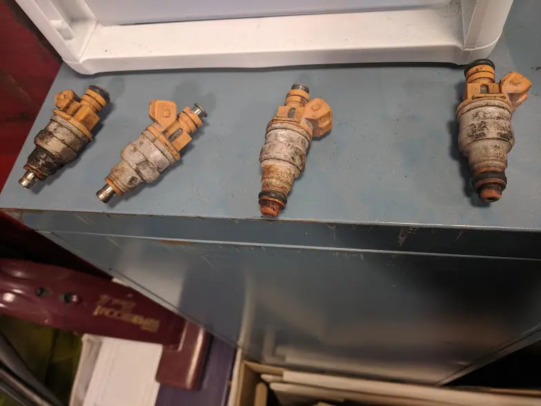

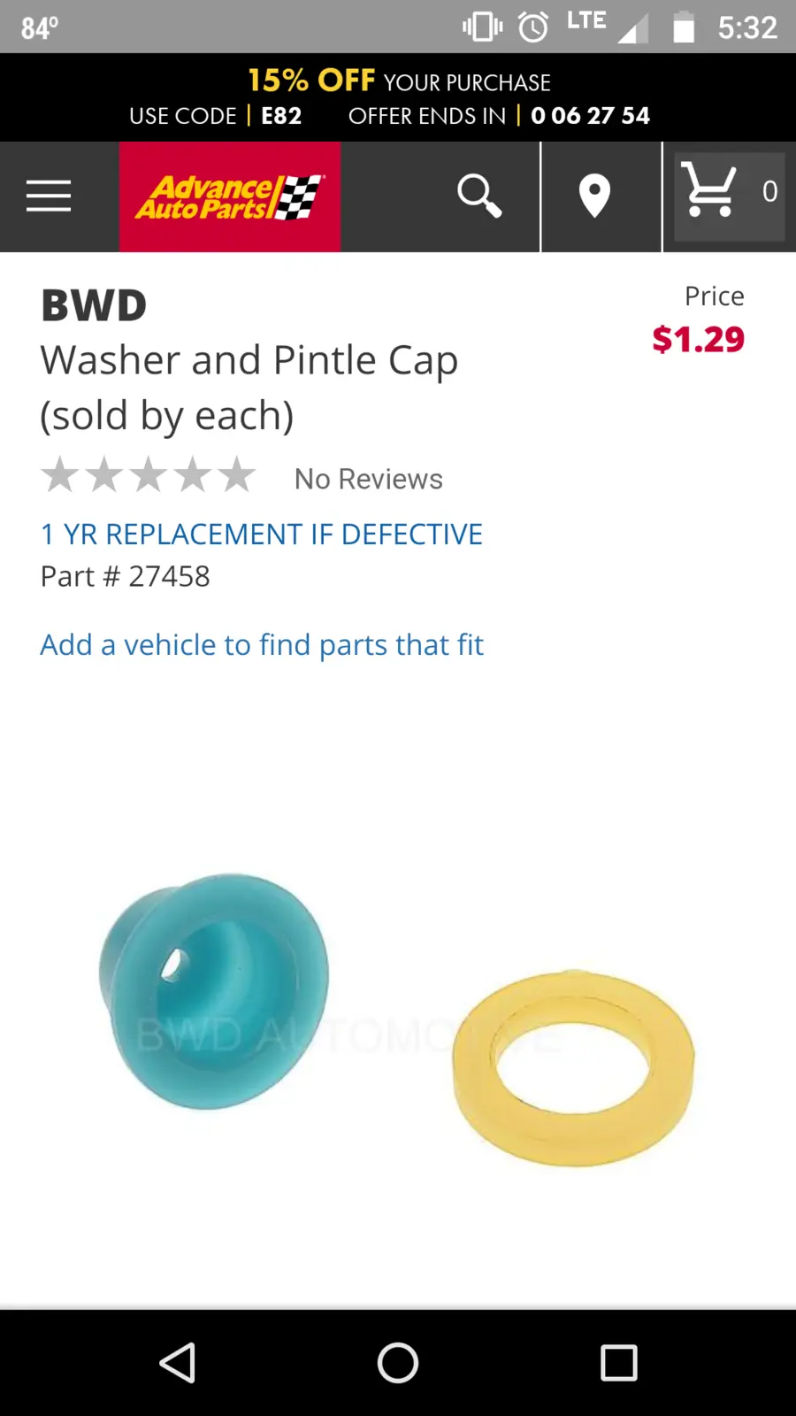

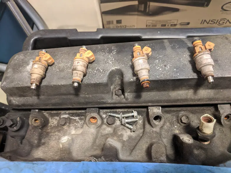

Well, just my luck... It seems the injectors in the old engine have been there since 91, so when I pulled them out half of them left the tips inside the lower intake.
The only thing I can think to try to get them out would be a pick tool, but no doubt I would mar the little caps if I tried to do that. I might just put them back in the old motor unless you guys can tell me that those caps are just for show lol.
Let me know if those caps are "optional" haha and I can still try em in the new motor but at this point I think I'm gonna have to find or borrow some injectors to test with :/
