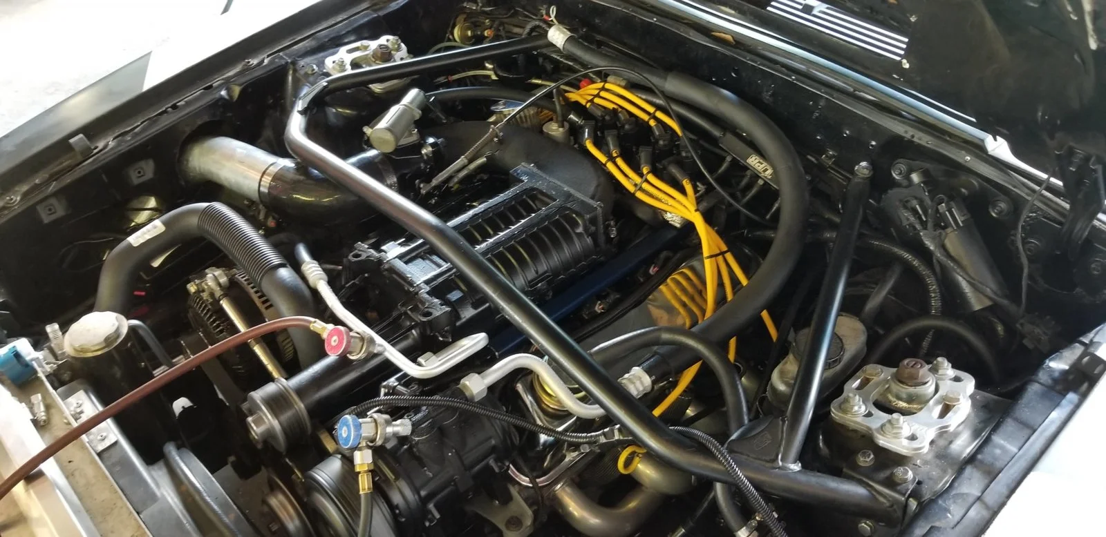

Here is a picture of my engine, this is tame compared to some of the stuff i have gotten to tune.
That is a 306CID SBF with a JAG M112 Blower with EFI and coil pack ignition.

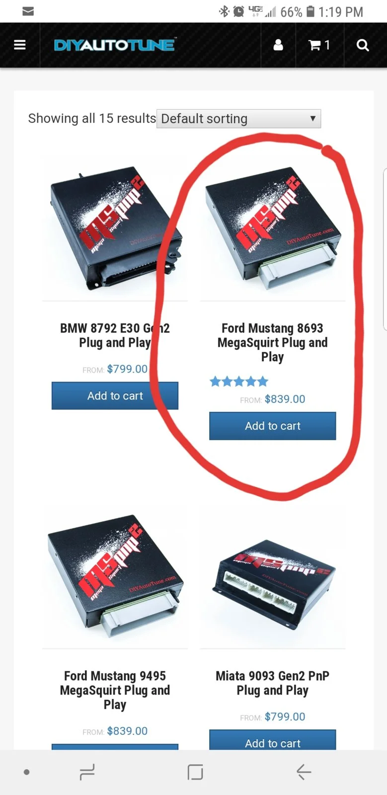

With mspnp2 you literally plug it in the factory location, upload a tune file, and turn the key. It also gives you a way to monitor everything....and it automatically adjusts to temperature ranges instead of having to adjust the carburetor.
All the stock stuff could go back on top of a built bottom with a nice camshaft. None of the rest of the car would have to be touched. You could do this for around 1k. vs all the money to purchase stuff to go carbed. The resale stays higher...and driveability is better than stock. The MS will also allow adjustments for anything you may want to do in the future. Supercharger....no problem. Turbo no problem....LS engine....no problemn....Viper v10...no problem. It also can be easily moved to just about any car. Want to put a Ferrari motor in a model A....no problem.
