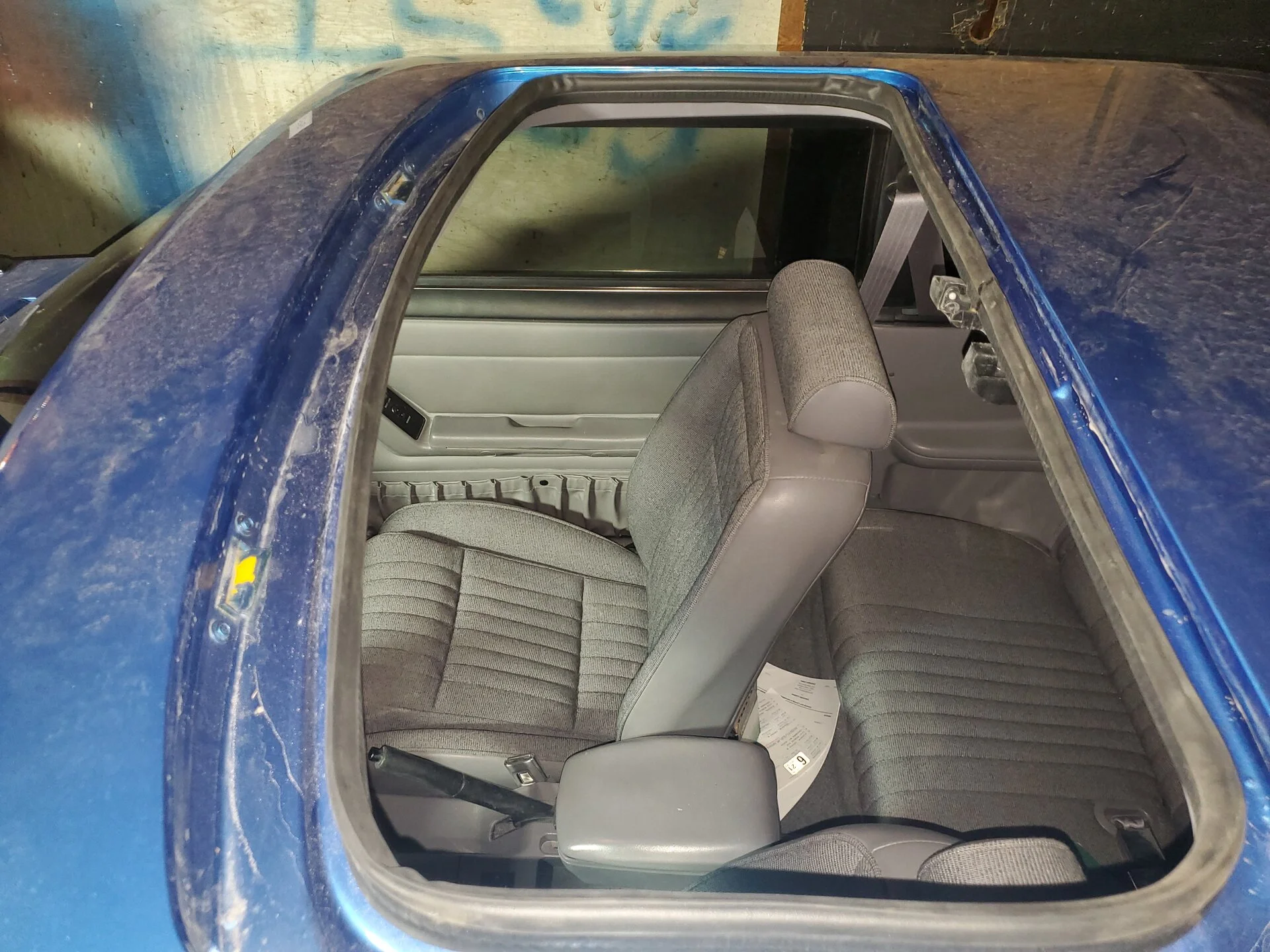

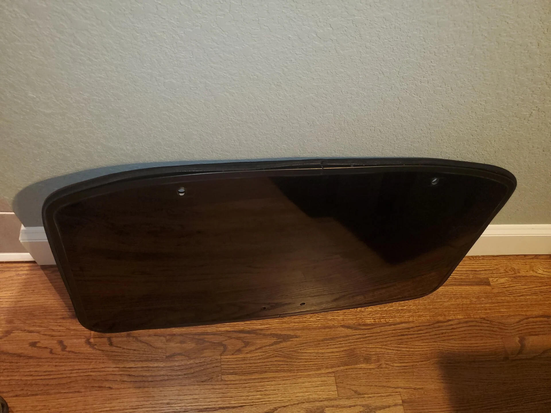

The sunroof is stripped down, painted, tinted, and the new weatherstrip is installed. The sunroof glass has some scratches in it. There is a company here that can polish glass so I'm going to see what they can do.

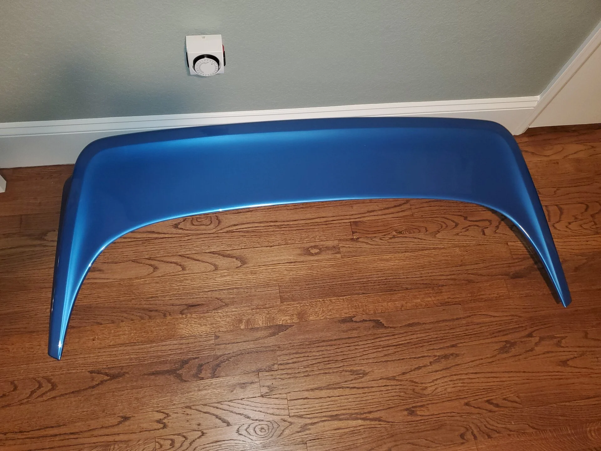

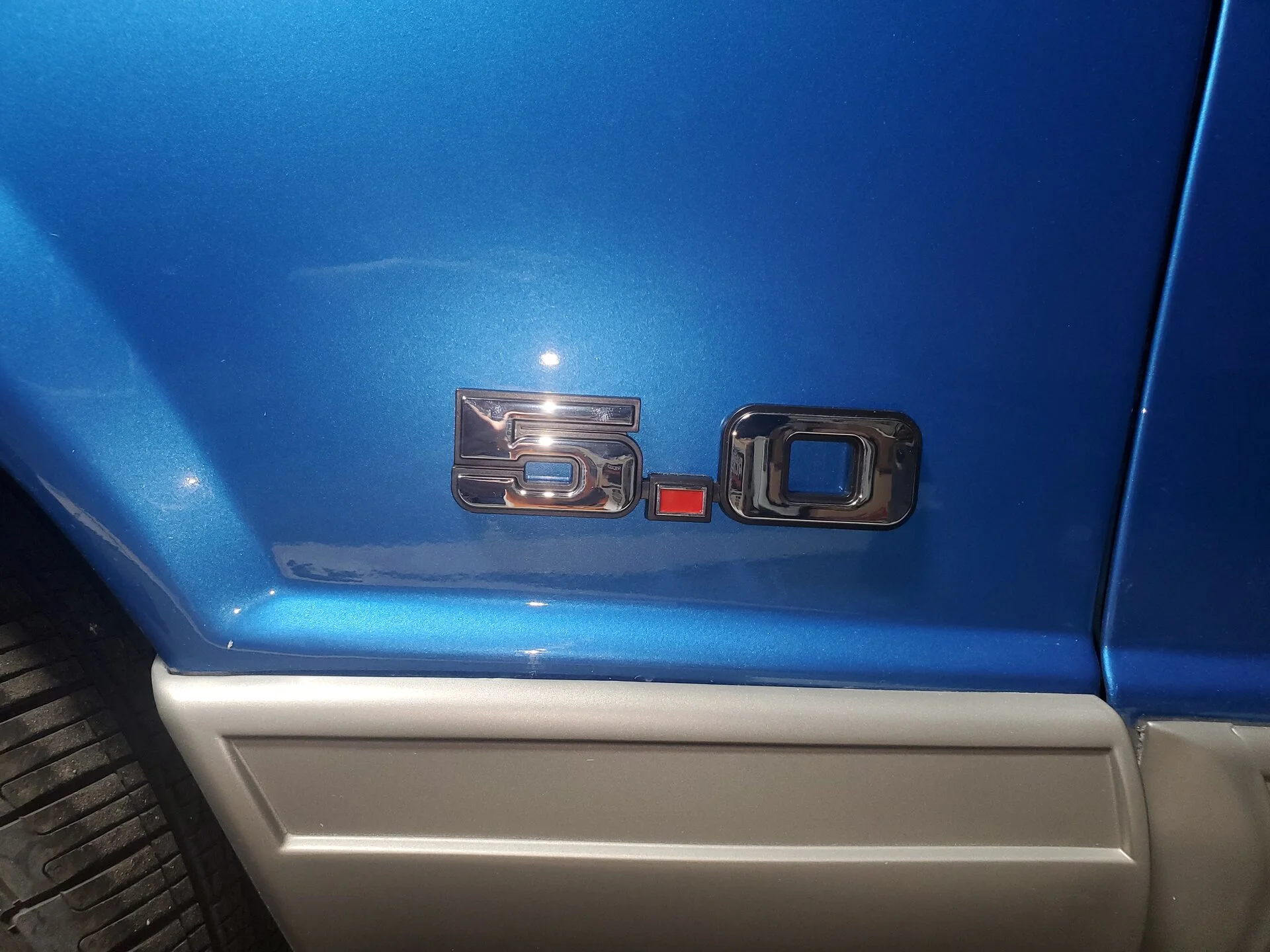

I put the 5.0 badges on, cleaned the smoke damage from the rear spoiler as best as I could. I think it turned out decent.

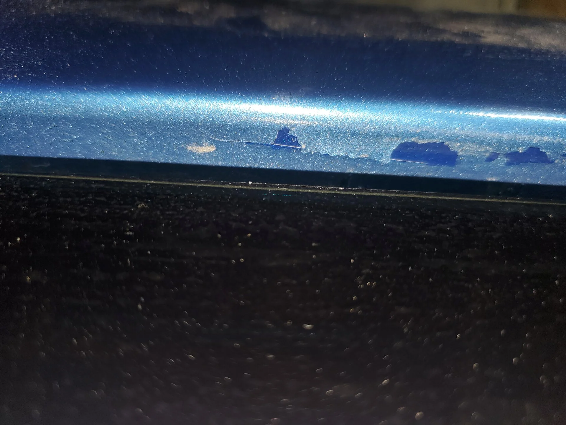

I also noticed I have some paint peeling already. This picture is under the windshield moulding on the top left area. I'm going to see about getting some black primer from a glass shop and applying it before touch up paint. There are a few areas that need touch up.

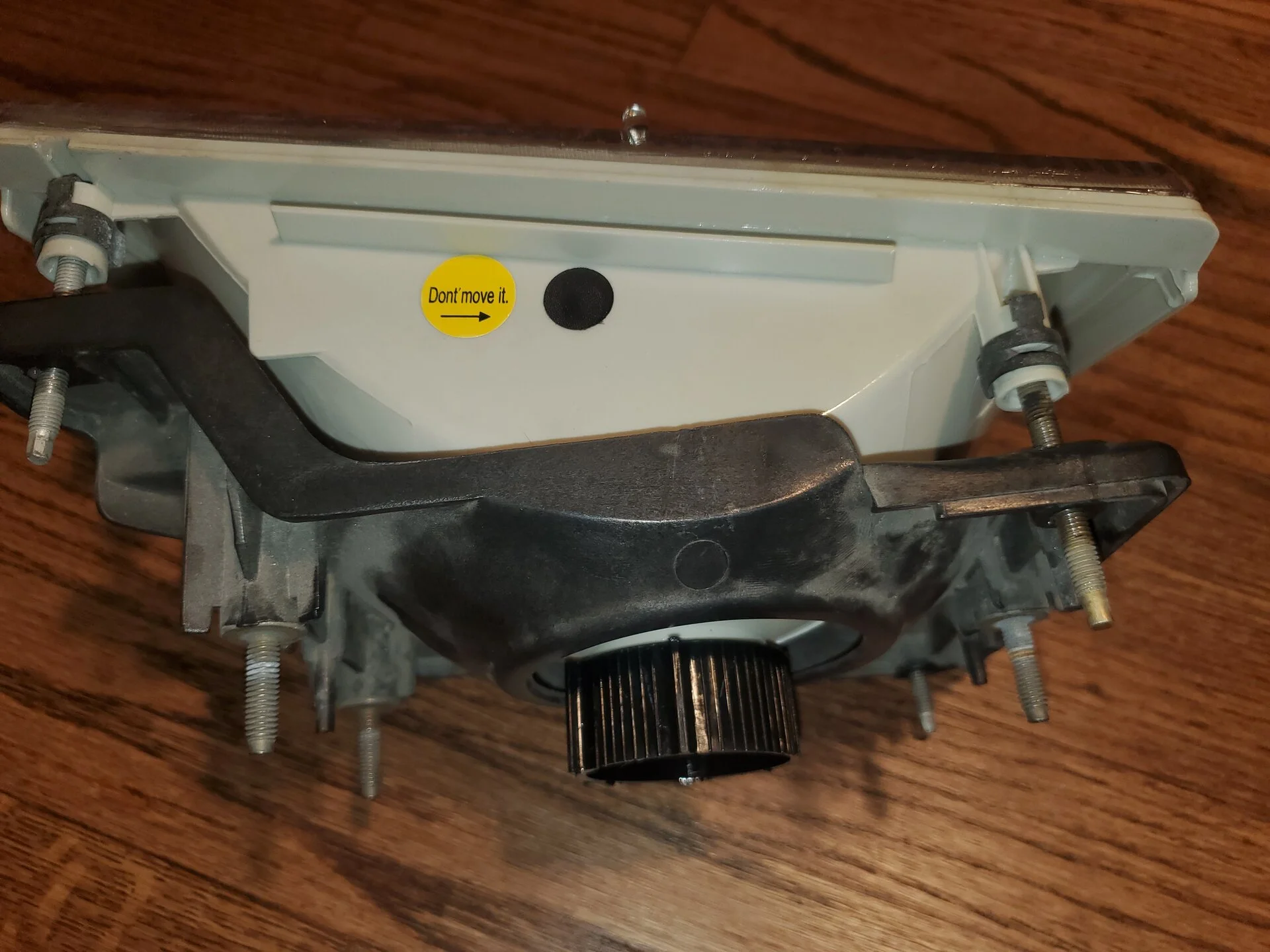

I would also like to know approximately where the torx screw in the headlight adjusters should be set at. Do I just center it in the headlight bracket, or is there an actual measurement?
It doesn't have a 5mm hex end to be able to adjust it once the headlights are installed. Top right in the picture.

The headlight seals that go around the headlights don't fit, they are too narrow by at least 1/4". Chinese parts... I'm going to return them and apply some rubber conditioner to the OEM ones.

I installed the sunroof glass a bit ago. The new weatherstrip pieces are TIGHT. It closed with some effort, and I'll leave it that way for a while. Hopefully they relax and loosen up.
