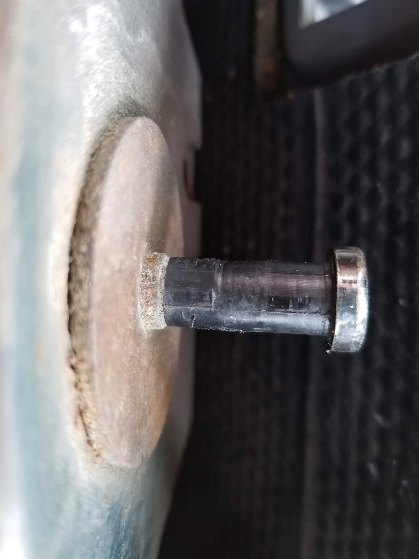

Finally got some time to look at it this morning and I looked at the strike and I could not see any evidence that it had moved, or that it was excessively worn:

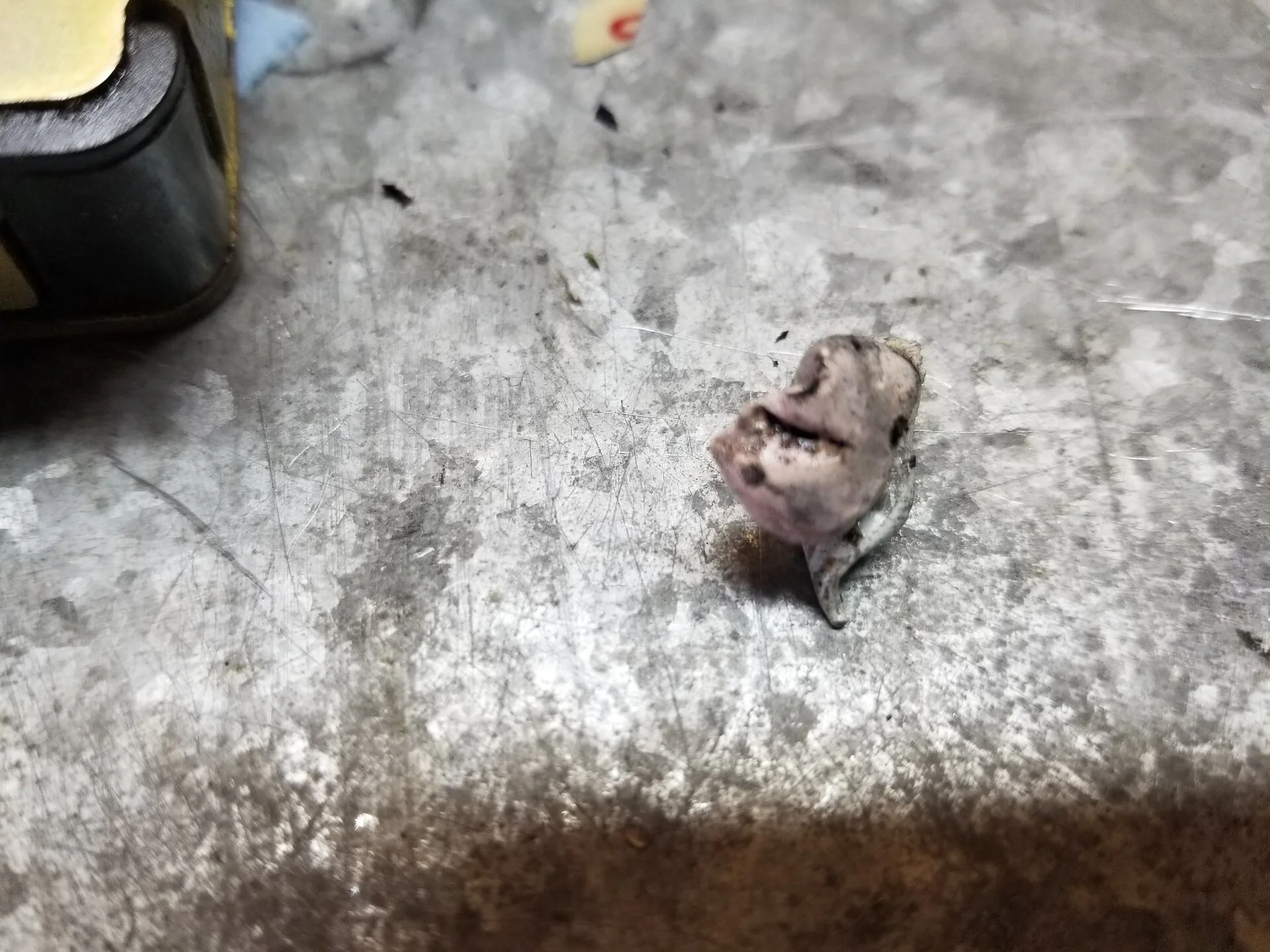

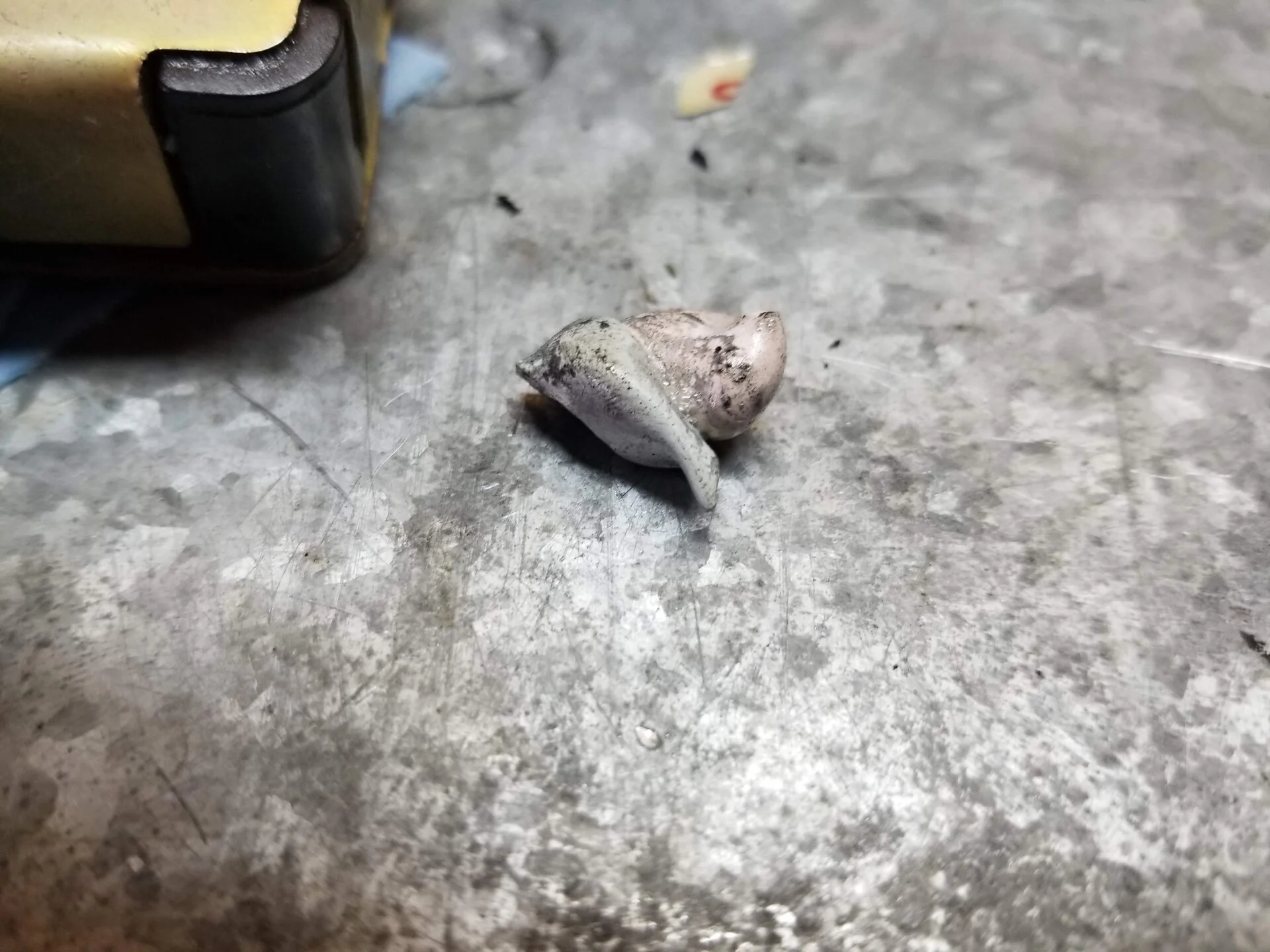

So I decided to remove the latch and try to figure is something had broken inside and if there was anyway I could figure out how to repair it. So once removed and sitting at my workbench I took a look inside the top of it and saw what appeared to be some old dried up sealant that was causing the latch not to lock in place:

A couple seconds with a screwdriver and I had this thing removed. Tried to operate the latch manually with a screwdriver and it worked! Unlatched it and it opened! Repeated the process a couple of more times and it performed as expected. Re-installed the latch in the car and tried it manually again and all seemed well. Closed the hatch and it seemed fine. Used the key to open it and again it worked fine. All good!

Any idea where the sealant came from?
Reactions: Mustang5L5
Lubriplate gummed up a door mechanism in my Stang. The white grease solidified, and that door had been coated with it, probably for a power lock solenoid issue. With some hatch dust, it could have looked like sealant.
That looks like it could have been factory around the edges of the hatch panels.
That looks like that goo that is stuck between like, say a trunk (or boot if you live, you know, down there :jester: )skin and the inner brace.
Oh, and there is a plastic sleeve that belongs on that stricker, right?
The mid 91 up do not have the sleeve. I was worried about that when I got my car and was tightening up hatch rattles.
