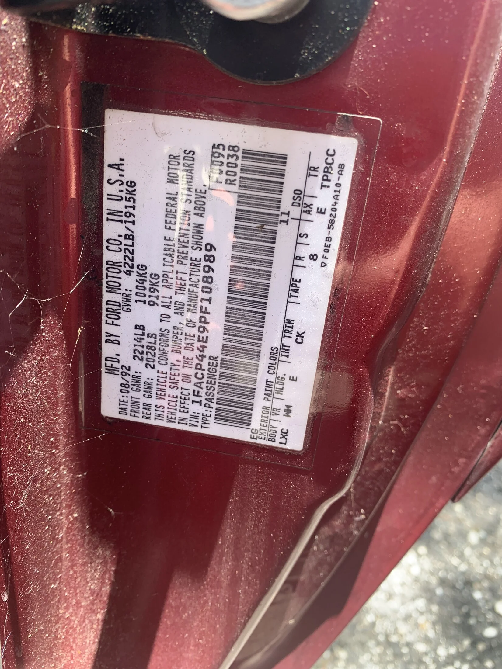

My door tag lists my interior trim as “CK”. I’ve searched and searched and the best information I’ve found was that it is white/red. I’m repainting all the interior trim and LMR had the exact white but now I need to order the red and I can’t tell if I need “scarlet red” or “ruby red”. LMR doesn’t list a “CK” interior for my year.

Date - 08/92 = August 1992 build
GVWR - 4222 lb/1915 kg = gross vehicle weight rating
Front GAWR - 2214 lb/1004 kg = front gross axle weight rating
Rear GAWR - 2028 lb/919 kg = rear gross axle weight rating
F0095 = 0095 lbs front accessory reserve load
R0038 = 0038 lbs rear accessory reserve load
Exterior Paint Colors - EG = Electric Red Clearcoat Metallic
DSO - 11 = Boston district sales office
Body - LXC = Mustang LX 2-door convertible
VR - WW = White convertible top
Mldg - E = Electric Red bodyside molding
Int Trim - CK = leather Articulated Sport seating, low-back front buckets (C), White and Ruby Red interior trim color (K)
Tape - [blank] = no paint stripes
R - 8 = premium AM/FM stereo radio with cassette tape player and digital clock
Ax - E = 3.27:1 axle ratio, Traction-Lok (limited slip) differential
Tr - T = automatic overrdive transmission (AOD)
PB = front springs
CC = rear springs
PB = front springs
CC = rear springs
Awesome, thanks!
