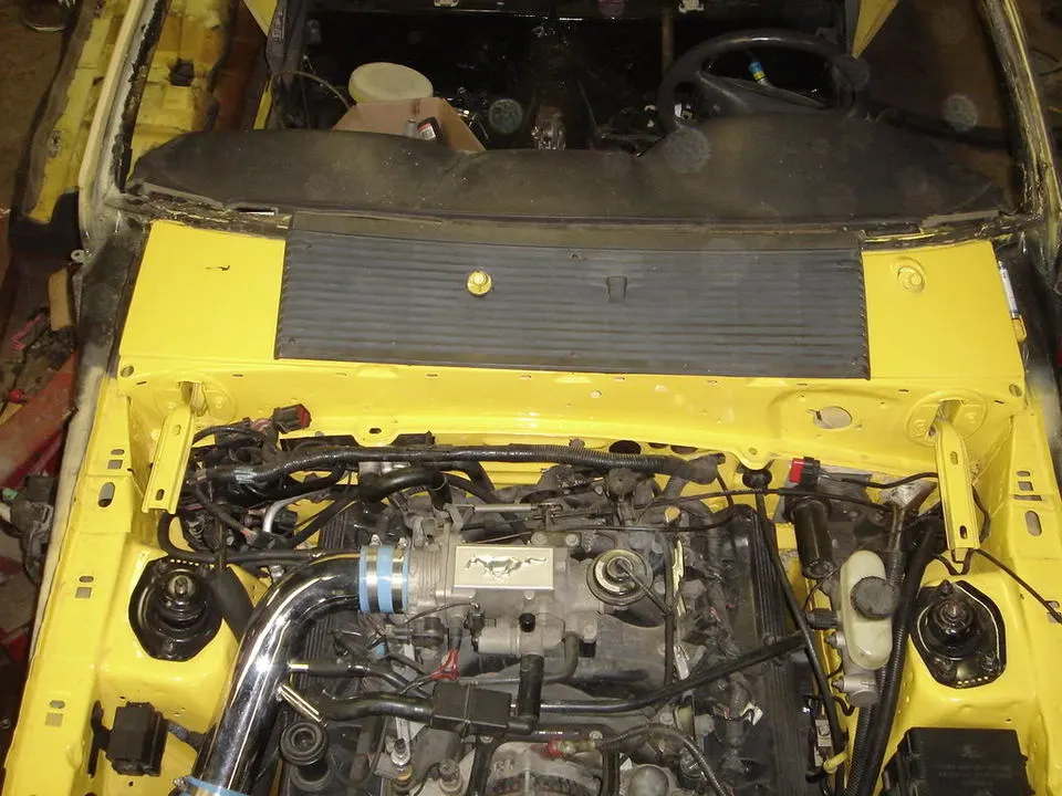

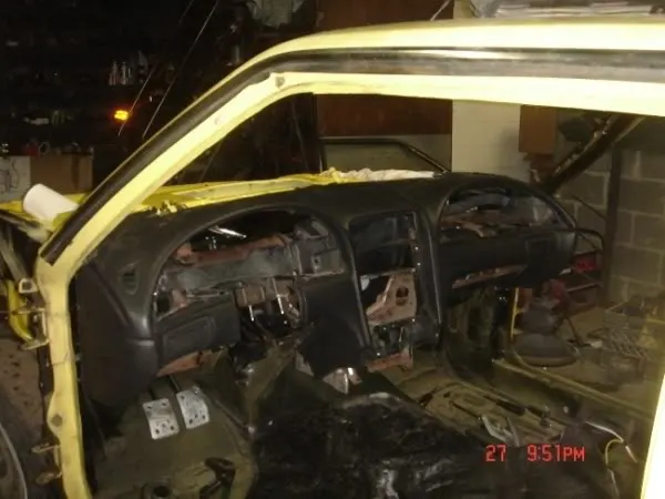

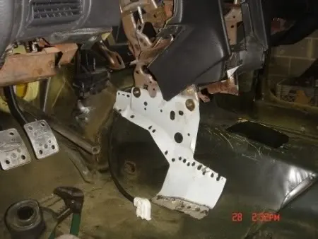

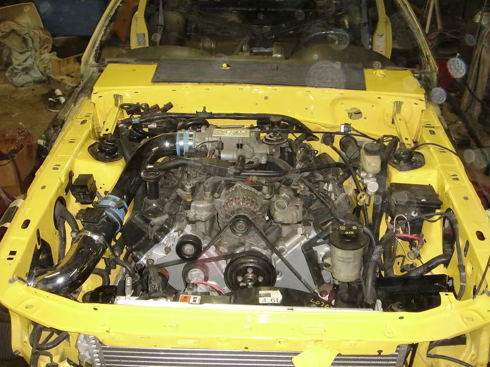

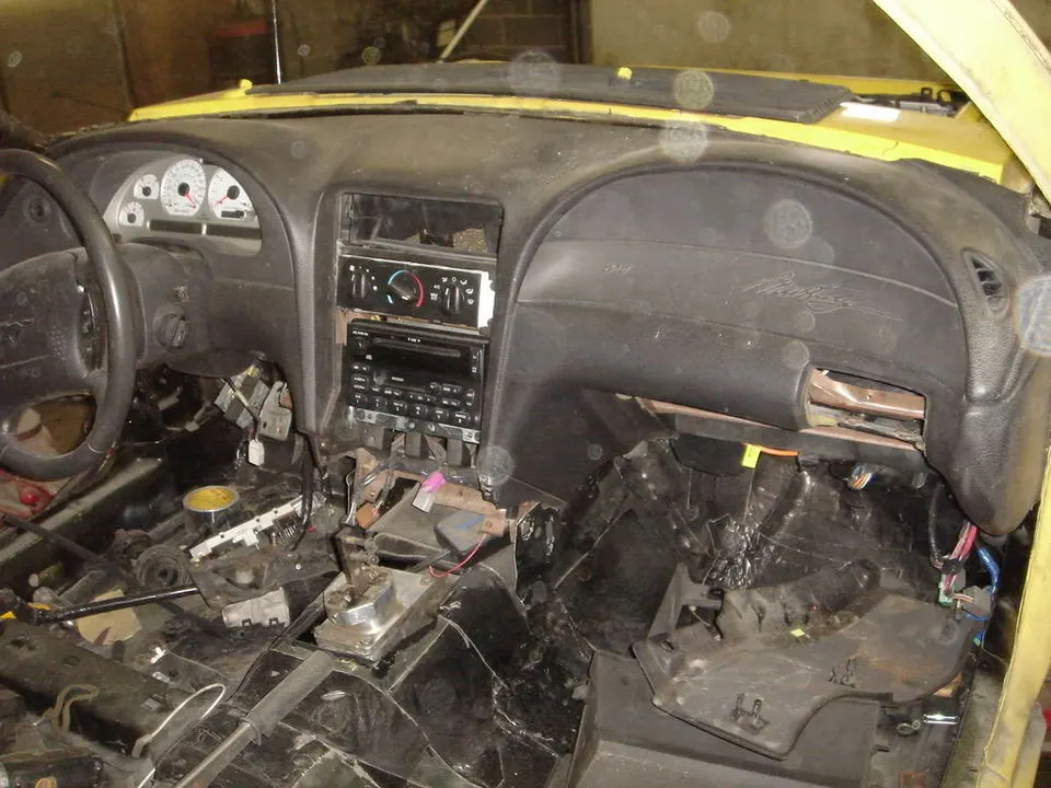

I did it. I do not have a problem with door handles. I must have made it fit tighter than anybody else. This took over 10 hours to get it fitting properly. If I had to do it again, I would know exactly where to cut it and trim. I could do it in less than half the time! Enjoy!!
Money shot:
2001 GT drivetrain COMPLETE!!!!! (Notice my airbag fits perfect as well. It isn't all wrinkled like that pic above. Plus, that one looks blown, but still wrinkled from being too tight of a fit.
Money shot:
DUDE YOU ARE THE FREAKING MAN, THAT IS AMAZING. I HAVE SEEN THIS DONT BEFORE BUT DAMN IT DOESNT LOOK LIKE ANY FUN.
Thank you!!! It has not been fun. It has been a rude awakening learning experience. Without a welder, grinder, air chisel, many years experience working on stangs, and my salvage yard, this would not have been possible.
If I had to do it over again, I would have started with an 87-93 coupe instead of an old 81. I say this because many things on the 87-93 firewall are closer to a 94-04 Mustang, than the early 80's Mustangs. Plus I am putting 87-93 body panels and glass on it, so I have to drill holes to mount certain moldings, and I have to fill holes in the rockers from the stupid rocker molding they rivet on them.
