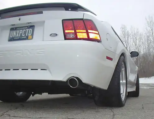

SVT32VDOHC waiting for the next hack atta Founding Member Nov 22, 2001 3,501 28 119 Motor City May 6, 2010 #4 May 6, 2010 #4 18x11.5 with 345's without mini tubs. You'll need a small spacer, extended lugs and rolled fenders. This is my tuner's car. I've seen in plenty of times.
