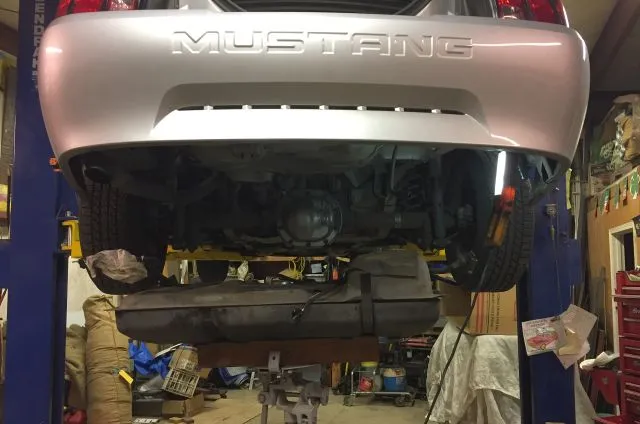

OK, my friend and I went through the whole system and voltages are all good from the front to the back. I went out and bought a new fuel pump today and will install it tomorrow thanks to my friend who has a lift in his shop it should be a piece of cake. I'll report back with the outcome.
Got the pump installed in about 2 hours after making another trip to the parts store for a new filter and a rubber gasket that that the filler tube goes into the tank. The car started right up!
