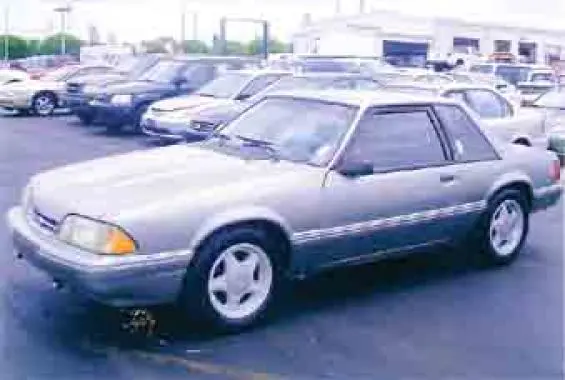

Heres a pic of my baby when I first got her 2 months ago for 1500$.

I hope you don't get to upset and just because you're a looker :nice: don't mean I'll go easy on ya :D I really don't dig most of the work done on your car but its your car to do what you want. All you need now is a Turbo Charged 2.3L to drop in that thing and then you could have some fun with the GT crowd ;)
