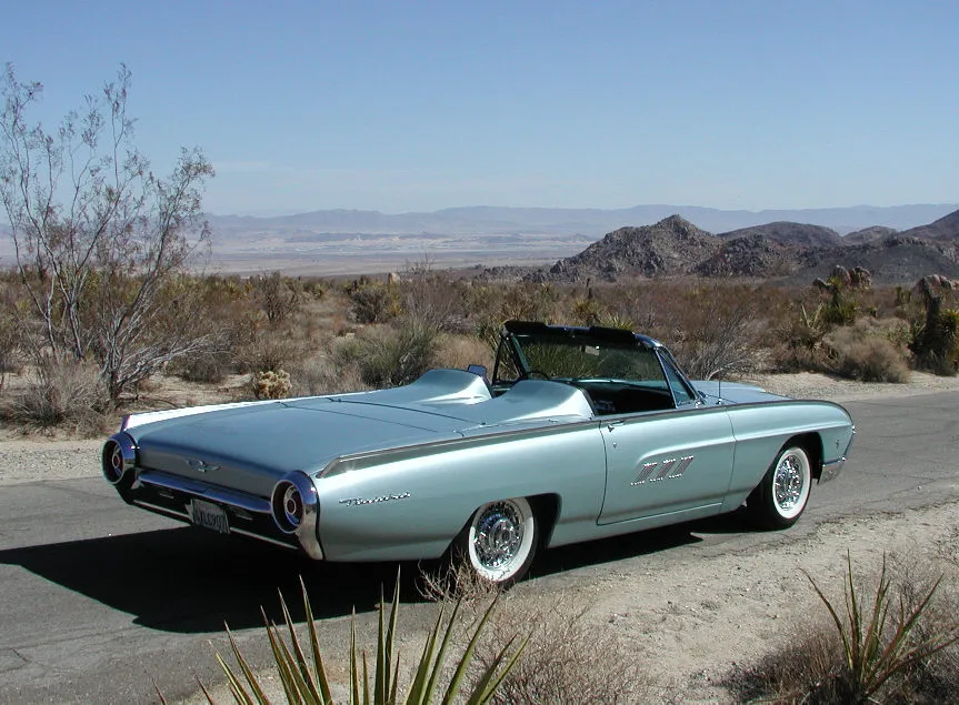

I'd always told myself that if I ever had a convertible ( which I'll never have) I'd make it into a roadster ala' 63 T bird.
