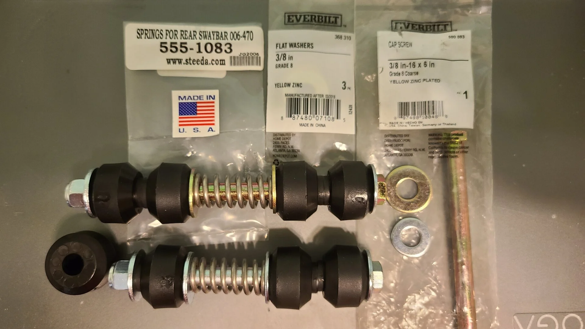

Warhorse, My Addco rear bar and Steeda springs for the end links arrived (actually, so did my rear upper and lower control arms). I know the Addco bar is not sold with the springs, but the Steeda springs are supposed to make the Addco links adjustable. Well, unless your adjustable bar end link bolts are a lot longer (these are 5-1/8"), I'm going to need some advice. The Steeda spring has a free length of 2". If I take the end-link bolt from the sway bar kit, and stack a washer, two bushings, a washer, the spring, a washer, and one more bushing (I am now leaving off another bushing and a washer) I have to compress the spring 1/2" just to get the nut on a couple threads.
Is your bolt longer, or is there a trick to this? I expect the bushings to compress, but the last bushing and washer add an inch to the length. That should be pretty close to squashing the spring flat. I don't expect that much compression. Also, without the spring, I expected a sleeve between the upper bushings and lower bushings... apparently not... It's not shown on the instructions, but every end-link kit in their catalog shows a sleeve, not that there is room for a sleeve. And, from looking at their diagram, no sleeve gives the 1.75" "Functional Height" shown on the specified end links (45-013-BU) for my bar.
How long are your end-link bolts? Any suggestions?

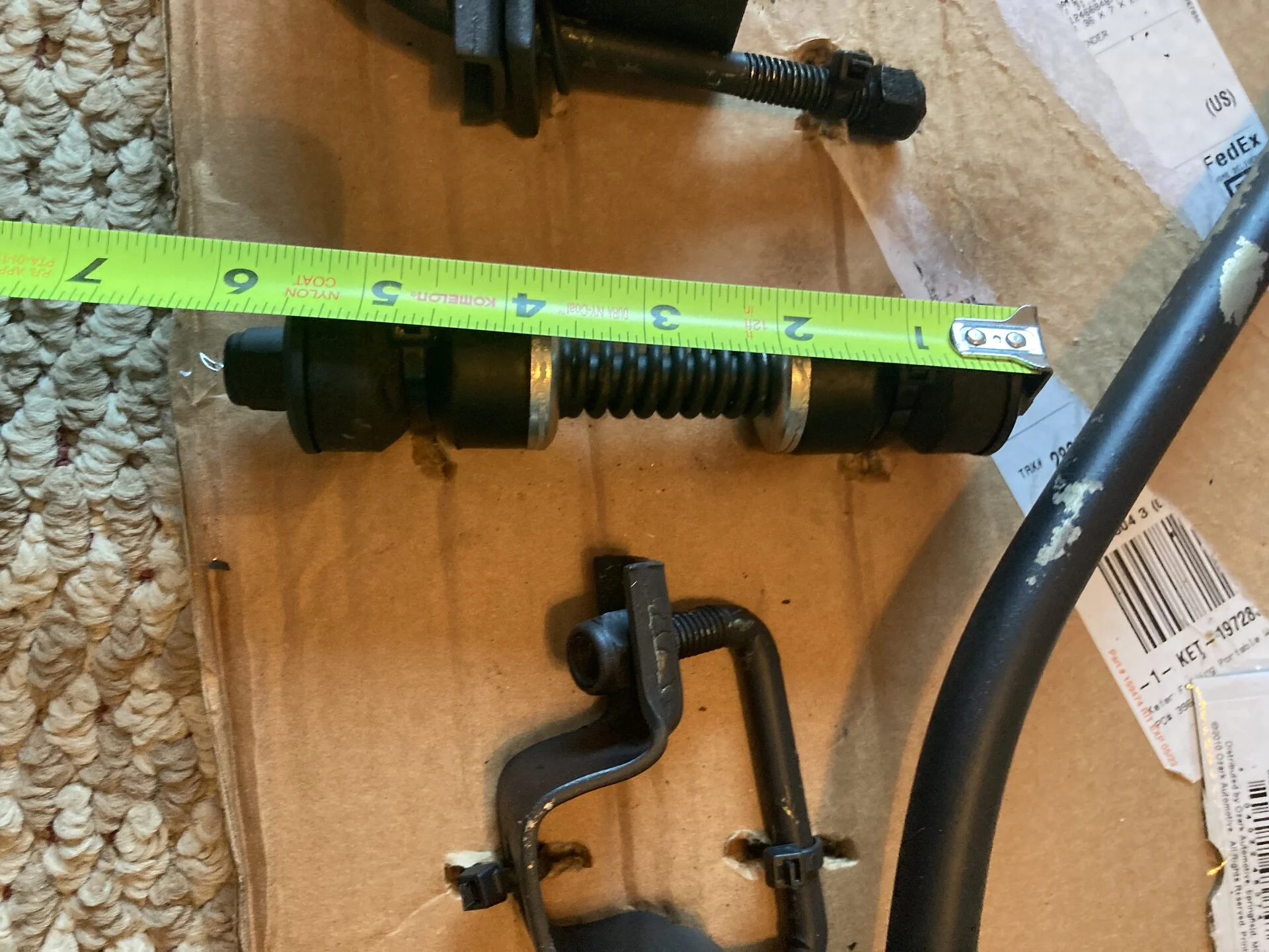

I'm helping a friend with his car today, so there are a few more things I want to check/research when I get home, but I measured the bolts on my 1STA (on the car, so it was hard to get an exact number). They are roughly 6.25".
The 3/8 x 6" bolts are perfect for the Steeda springs. My attachment shows one end-link with the 5" bolt and one with the 6" bolt. I also upgraded a couple of the washers. Some were a smaller diameter. I also show what I bought (in case it helps anyone else). Of course, I'm just gathering parts right now. In all likelihood, it will be weeks before I install this stuff. I'm prepping the body for paint, doing some interior work, getting a new top, and need a new starter.

I'm looking for a 3/8 x 6" Grade 5 bolt today..By the way, don't hesitate to add anything you come up with. ;)

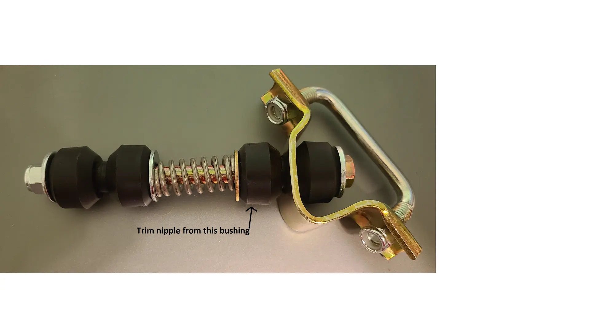

I wanted to be sure I could make the adjustable links, and have them fully uncompressed, so I could minimize the effect of the add-on bar because I was worried about too much oversteer. If I do get too much oversteer with the links fully soft, I will look for a smaller bar in the factory position or try removing it.
I was looking for Grade 5 bolts, because that is what Addco sent. I ended up with Grade 8. I can see no downside to them being stronger. If they were the weak link before, now something else is, but the overall point of failure only moved up.
If I read what you said correctly, I need to cut the nipple off of only the second bushing (with the top bushing being the first bushing). See my attachment to make sure I understood. Thanks, I would never have had that instruction

You are correct, only cut the nipple off of the 2nd bushing in the location you tagged in the photo.
Also, it looks like you still have the metal sleeve installed (inside the spring). When using the spring, you would not use the metal sleeve. The sleeve won't allow the spring to compress.
About an inch longer. That makes perfect sense. Very helpful. Now you helped two friends with their cars today. Thanks. :)

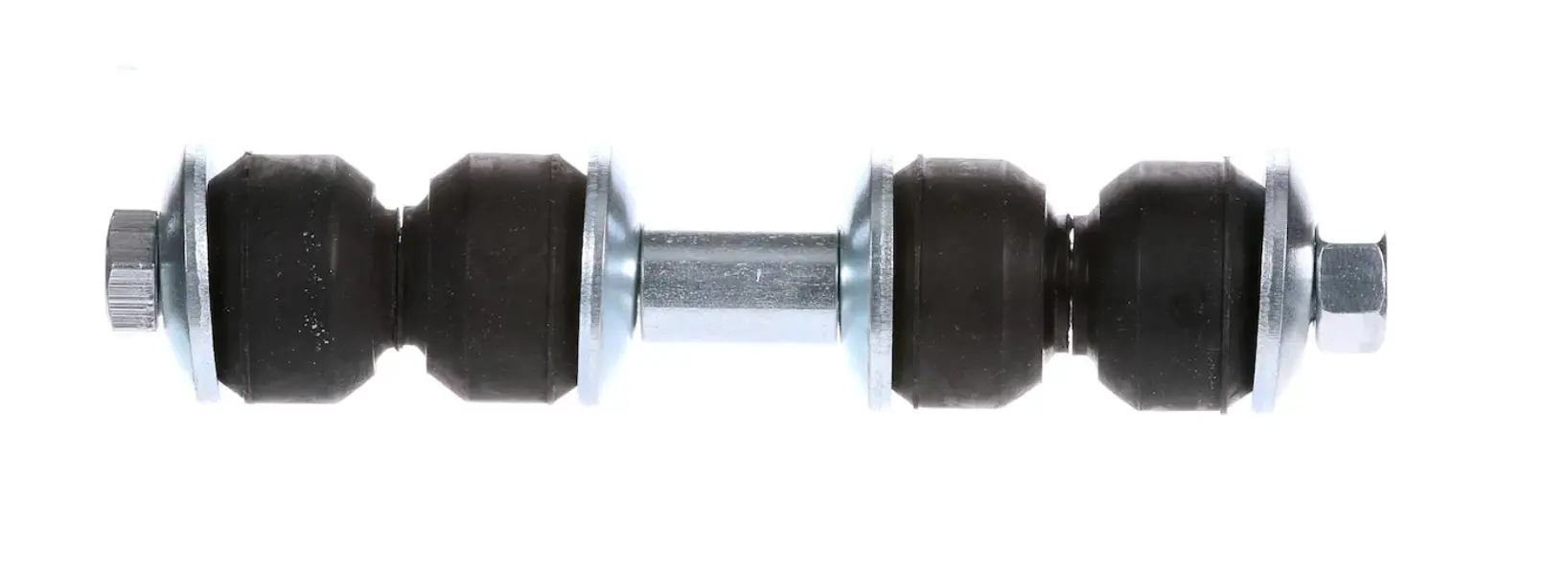

This is a new bushing link @revhead347 (Kurt) sent. The part number for the updated bushing (and I’m not sure how much of the link kit) is MasterPro K5342 Stabilizer Link. If I have to trim, the pic Bill posted will help.
Very interesting. Thanks. I found, and have attached, a picture of the MasterPro part. It does not include the spring, but looks to be the right length, They are $8.99 each at O'Reilly's. The 6" Grade 8 bolts I bought were about $3 each, the Grade 8 washers (optional) were $0.40 each. It's a cheaper path, unless you need new bushings, in which case MasterPro is the way to go.
