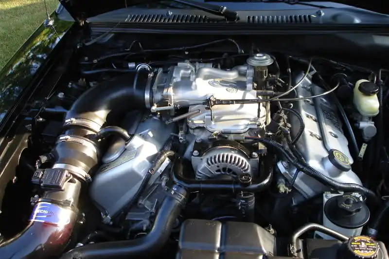

oh and above all, a 4v motor looks so much sexier in the engine bay than the 2v.
No offense guys but to me these photos really make the SOHCs look like a piece of crap compared to the cobra motors.

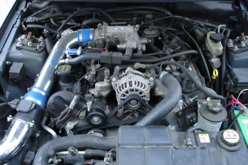

i know it doesnt look good on the 2 valvers, but its the only engine pic i had of my last mustang, and that was after it had been sitting in the gravel bodyshop parking lot for a week and a half
i will find out about the power when i get it dyno tuned in a couple weeks.:D
im hoping for 355-360rwhp and 370+ tq
