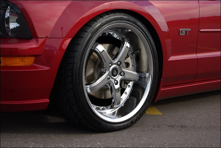

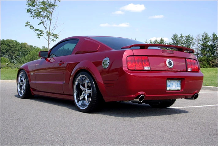

I've attached a pic of the look (wheels and car heighth) I'm tying to achieve in case it helps to answer my questions. Also, this is my first post so I apologize if my post is not formatted correctly. Thanks in advance for any help you can give me!

You will want an adjustable panhard bar to center the rear end. It is off from the factory and lowering with wider wheels could cause clearance issues. Lowering 1.5 inches is no problem; beyond that I'm not sure.
