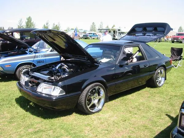

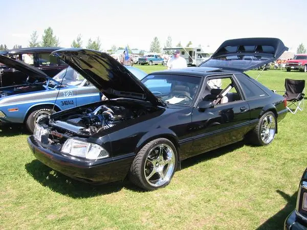

2000 Cobra R's on a racecraft lowered fox. 18*9 with 255/35's all way around. No clearance issues at all in the back, will rub slightly in the front when turning lock to lock, which is not an issue for me.
