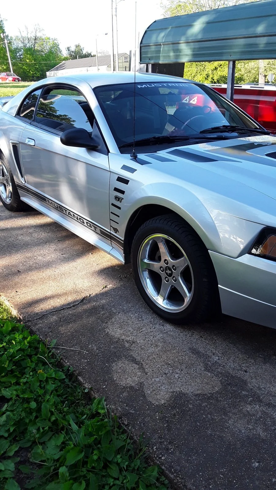

I have 2000 Ford Mustang GT with a 4.6 under the hood. I am having trouble with my AC not blowing cold. My Pressure test said my Low side is at 36 and my High side is at 50. Why is my High side so Low?
Next:
I changed the heater core 3 months ago. What a deal and no shortcuts either, dash, steering column and all had to be dropped and moved ect... Well yesterday my heater core went out again. So Fun fun!! I get to do it again this week! What is causing this to happen?
Last:
I have a O2 sensor bank 2 that is dead. I can hardly reach it or get the sensor wrench to fit in there to get it out! Any suggestions?
I have the next 2 weeks off work due to the holiday and I'm ready to turn some wrenches and get my car back to where it needs to be! I would love some feedback about how to and what to and dont do's!!!
Thanks A Bunch Misti May!!
