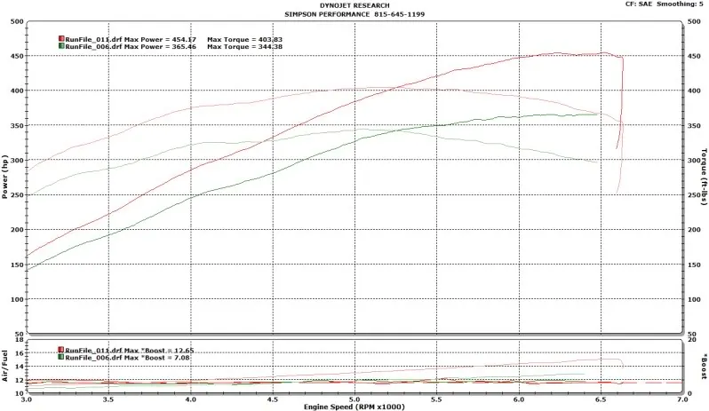

My opinion if you're using boost...The modular blocks and cranks are very strong and durable. You'll have to upgrade your fuel lines and probably convert to a return style system before you make enough power to break those. The weak link is the rods and pistons. Depending on the compression ratio, the timing, and whether or not you're using some kind of aftercooler or intercooler or boost cooler or meth injection, I'd say you're at the limit with 12lbs and 400-450 hp at the wheels. Anything more and you're definitely pushing the limit. Any 4340 H-beam rod should be able to handle around 750 hp at the wheels and maybe 900 at its max. Billet rods are all but unbreakable. Steel pistons can handle 15 lbs of boost all day without breaking a sweat. I'd say they can max out around 20-25, maybe more. My advice is to keep the compression low to moderate (like 8.5:1 - 9.5:1), watch that timing, keep high octane gas (91-93) in the car, keep the AFR in the appropriate range, and get a cooler. Make sure you have a safe everyday tune for the car...
