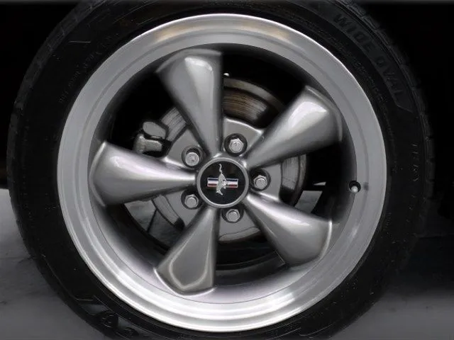

I have found the paint code to the 2001-2004 Bullitt wheels. I have these on my 65 Mustang Fastback and a few of the spokes have nicks in them. I called Ford Racing Products, gave them the part number of the rim, and the paint code is 3NSEY9A which cross references to PPG 907188, Grey Metallic. It matches perfectly.
You'll probably need to get this mixed at your local automotive paint supply store as it was nearly impossible to find it on line.

The color changed between 01 and 04. So the paint matches which one?
As I've also been searching for the correct paint color for '03 Mustang GT bullitt wheels, I went to my local PPG paint store this AM and pulled some color chip cards. PPG 907188, Grey Metallic matches my factory painted 2003 wheels perfectly.
