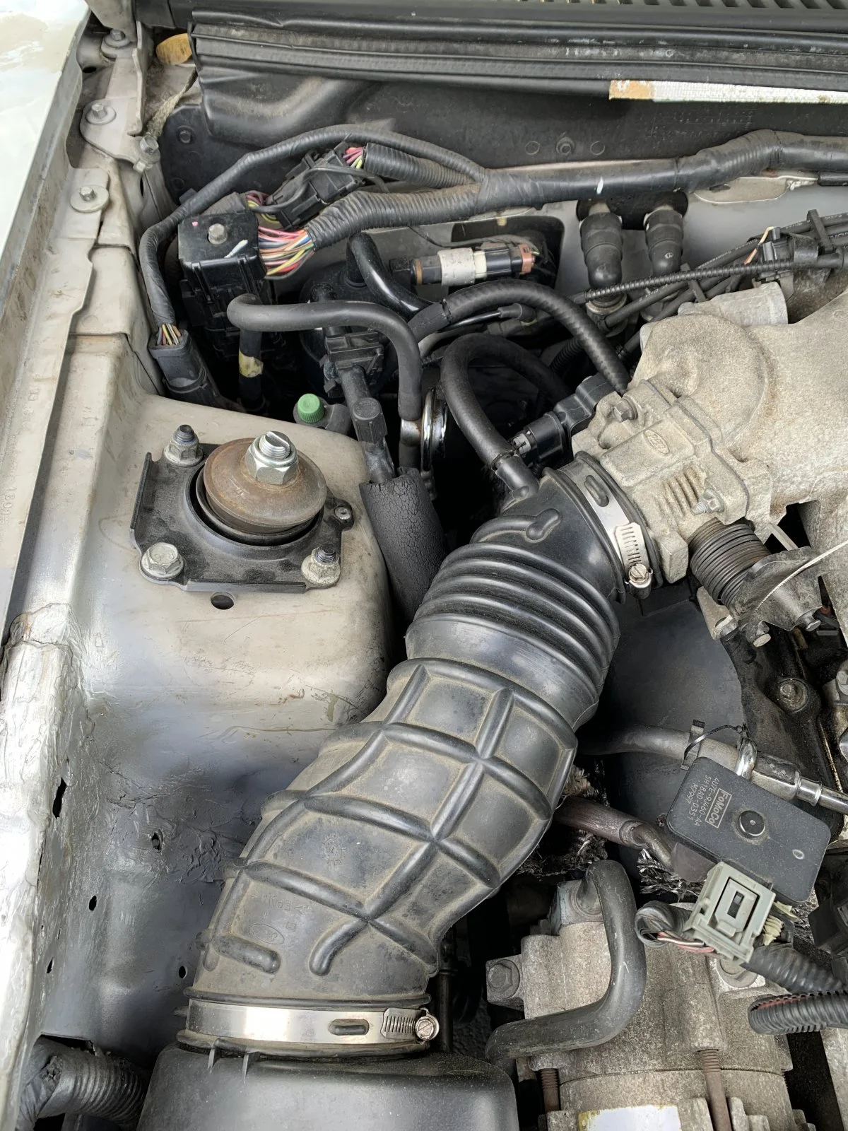

Im having the same problem 01 mustang v6 looking for a vacuum hose diagram for the hoses behind the passenger strut tower. Misfire in cilynder 3 and running lean. Replaced spark plugs, coil packs, egr vqlve with new gasket, cam shaft position sensor. And have new seal for my injecotrs replaced all this and still cant find the cause i belive its a vacuum leak but would like the diagram for this side so i can know what solenoid i need to replace also im

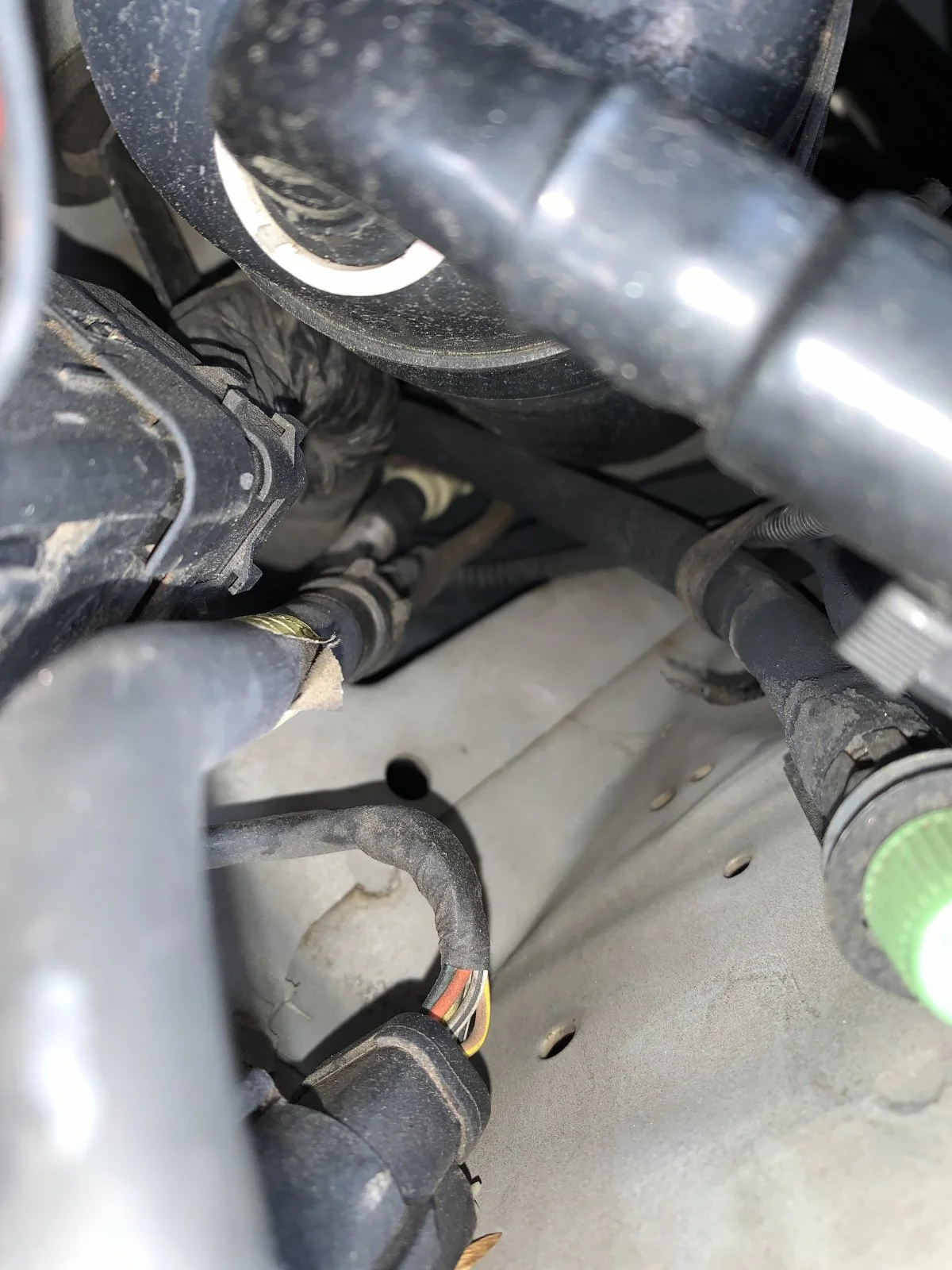

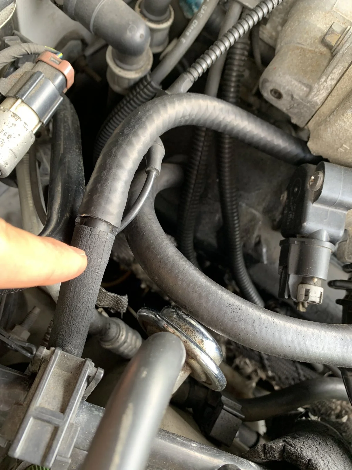

What is the vacuum hose connected to called from the picture you posted with your finger on it. I replaced my spark plugs and left that hose unplugged and made my car run like crap. I replaced the plugged and realized it was unplugged and the engine work like normal but I need to replace that hose. It run into the cabin probably the glove compartment area
