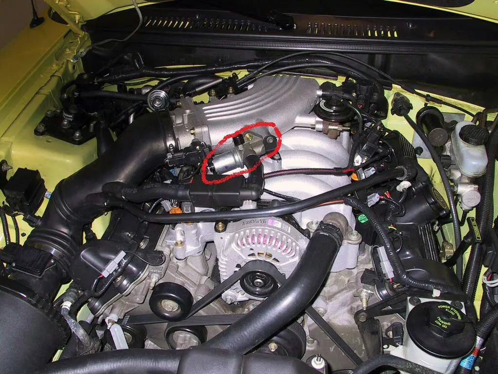

To test with the car running Un plug the iac if there's a difference in idle the it's ok if there's no difference then the iac is bad here's a pic or where it's located

thanks much, i did start the car the puled the hose off the air plenum where the iac is attached and the result was a drop of about 400 rpm, based on your comments I am concluding the iac valve is good
o.k. thanks for that clarification! Got home from church this a.m. and wanted to implement your suggestion. presently the car wont idle down to less than 1100 rpm, if I shut it down and restart it the rpm will go to 1100 or so and then before I can get around to the plug connection the rpm rises to 1600-1700. sometimes it will vascilate between 1300-1700 rpm. All this being said, disconnecting the electrical plug lead me to an inconclusive result. I dont think I accomplished a valid check of the IAC valve due to the high rpm level
From what I understand when you unplugged the iac there was no change in idle speed regardless if it's idling high or not and if so then the iac is bad which controls the idle speed
