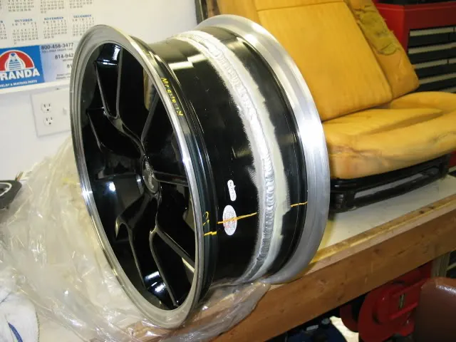

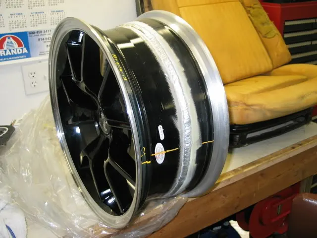

I bought a pair of 18x9 +36 offset 2005+ Mustang wheels for the front of my 68 coupe. I had previously run a 17x9 +24 Cobra R wheel on the front that I had narrowed to a 17x8. If you do the math you will see that this ended up being 4.94" of backspacing. At my ride height (Global West 620's with 1 full coil removed) this combo did not offer the fender clearance I needed. So when I decided to go to 18's I bought the deeper offest 2005+ wheels to narrow 1" and have a final backspacing of 5.42". This worked great except the wheels rubbed the UCA's at full steering lock. I could have added some material to the steering stops to fix this but since I had some 1/4" spacers I opted to run them instead of sacraficing turning radius. Also, my wheel lips are rolled front and back. Here is a pic of the narrowed wheel.

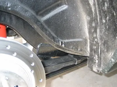

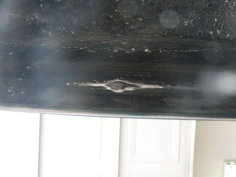

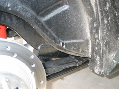

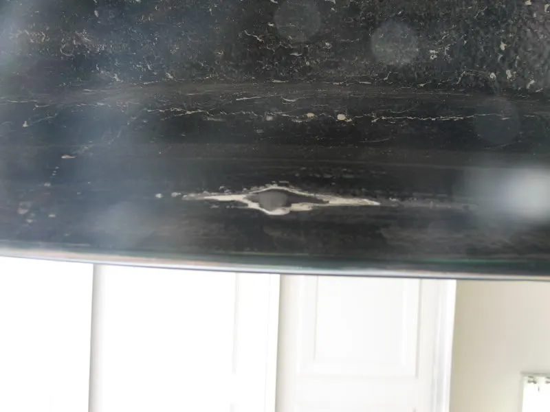

On the back I was running 18x10's (+22 or 6.37" backspace) with a 295/35 tire and no spacers. This perfectly centered the wheel in the available space but at my ride height (GW leafs dearched 2") they rubbed a little on the inside and outside. So rather than raise it up I went with 18x9 (+24 5.94") and a 274/40 tire, still with no spacers. If you are going to run it low you have to tuck them in as far as you can. The pics below show where it was rubbing with the 18x10 combo. The inside rub is the most common place on the bottom of the inner wheel house that could have been fixed with a few well placed BFH hits. On the outise notice how far inside from the lip it was rubbing. Fixing the outside rub would have only been solved by raising the car up. And since large diameter wheel/tire combos look dorky on any car without the right stance I chose to go smaller rather than raise it up.

I've read your posts before but didn't fully understand the need for 275s until now. I didn't realize the 295s would rub that far inboard of the outer wheelwell.
That's some good information and with detailed pictures too. Thanks. :nice:
MD
MD
Your welcome...and I was also suprised that it rubbed that far in :shrug:
