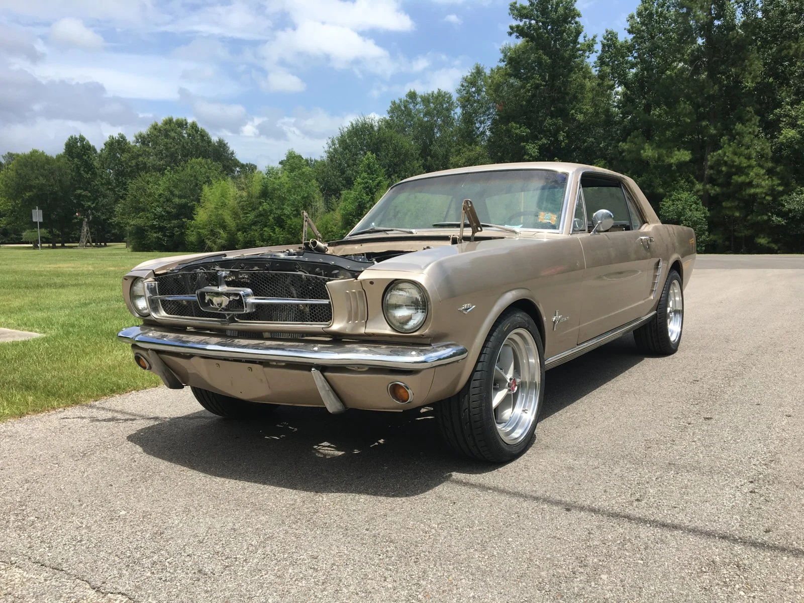

17x8 with 4.75 bs fits perfectly in back. 235/45/17 here

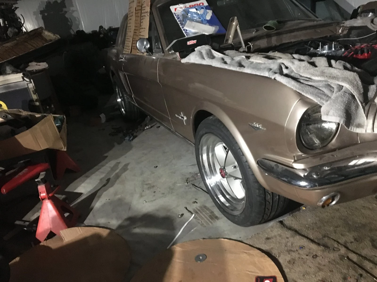

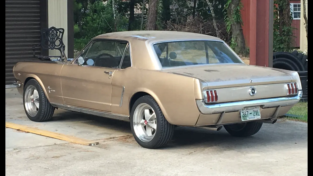

17x8 w 4.75 bs gave no probs for us up front. 225's would fit better than 235's but both are ok. We had to run .250 spacers because of caliper fitnent issues but that's another story.

Not stock. This is lowered 1" all around. HD coils up front and 4.5 leafs in rear. Mustang Steve 08 GT disc brakes at every corner. Legendary wheels don't have enough space behind the spokes so that shoved us into the 1/4" spacers. Front fenders are slightly rolled. Would have been perfect without the spacers.
I should clarify that when I say "stock" I'm mostly just saying a shock tower setup that uses the stock spindle and stock or stock-style control arms. Thanks! Those pictures are very helpful.

Would NOT have needed the .250 spacers with AR Torque Thrusts but DAMN those Legendary's look sweet! lol
Had to "love" on the calipers just a little, too. It was the rear of each spoke that gave us issues. the TH's have a lot more room on the back of the spoke because they bulge out a bit.
