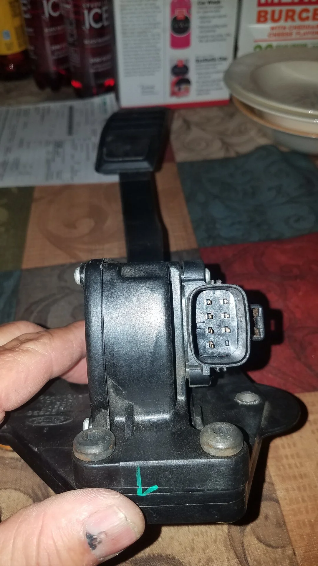

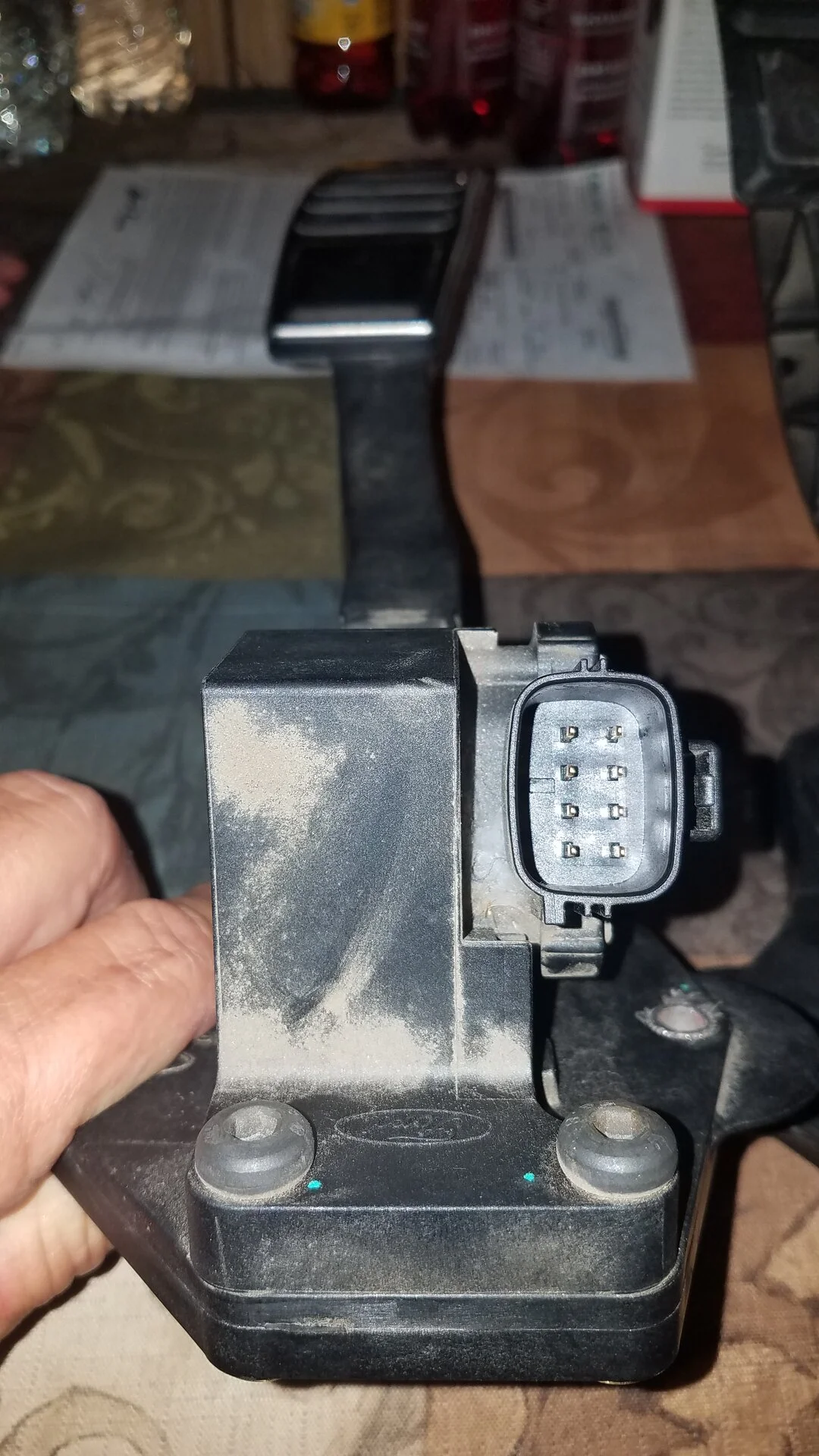

Well ,i have changed every sensor on this thing and still get the stuck rich codes . The only thing i havent changed is the pedal sensor and the engine harness ,since the harness and the pedal sensor is original to the car ,and the motor ran perfect in the wrecked 07 it just kind of runs down to one of these two ..now ,the new problem! The 05 pedal sensor is a 8 pin and the 07 sensor is a 7 pin and i can not find a 8 pin sensor ,will the 07 sensor work or is the 05 a one year only like the wiring harness ????
05 pic is first ,the 07 has a black plastic plug lower right
So far everything i have replaced hasnt came up to what two trips to ford did and they didnt find the problem and all they wanted to do was replace parts so i think i am good . There really shouldnt be anything mis matched now . I ran into a post on a face book page for a pedal code showing and all the replies said no it is the throttle position sensor but there is also a sensor on the pedal its self that can cause the same codes and problems i am getting ,and mine did bring up this code one time ,i figured it was because it went into limp mode but not so sure now . I am going to pull the pedal assembly from my brothers blue 2005 and give it a try ,if that clears the problem then i will have to try to locate a 8 pin pedal sensor
