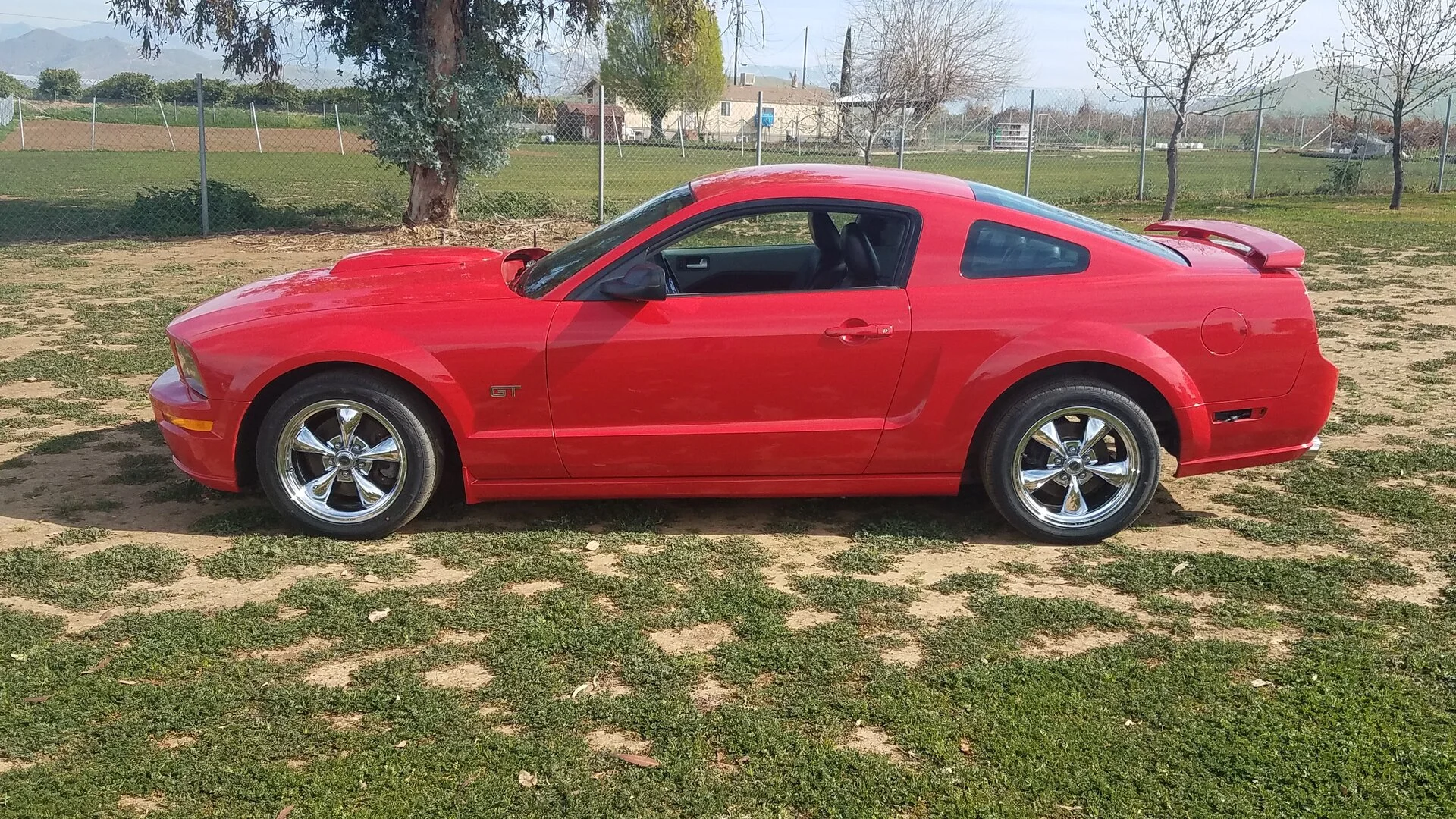

It has been sitting here on new tires ,new paint ,new windshield as pretty as can be all this time and the only time i have got to drive it was to take this pic and taking it off the trailer to drop it off at Ford :cry:
