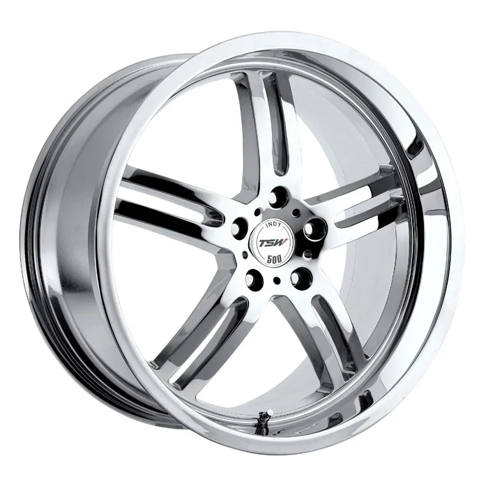

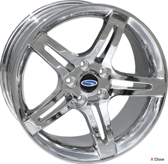

I'm ready to buy some wheels now. From the info I've gathered, the offset on the stock 2005 GT 17" wheels is 45mm. The wheels I've been looking at are the Steeda Pentars 18x9.5 (first pic), which have an offset of 45mm. Problem is they weight 29 lbs each, that's a little much IMO. The only similar wheel I've found are the TSW Indy 500 18x9.5 (second pic). I also like the TSW Montage 18x9.5 (third pic). TSW does not list the Indy 500 wheel in their application guide for our cars, they also don't list any offsets for them. I'm leaning towards 18x9.5 wheels with 275/40/18 tires in all 4 corners (so I can rotate regularly), just not sure what offset I need to get. Will the Indy 500 40mm offset fit? I want the tires to sit flush (or close) with the fender, and do not want them sticking out past the fender. Any help appreciated.
Edit: Having problem uploading picture of Montage wheel.

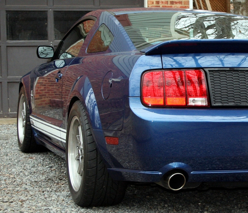

The OEM wheels are different offset as well. The Bullits are 45mm while the fanblades are 50mm. My rear wheel is 18x10 with 45mm offset(which sit just inside the fender lip)while my fronts are 18x8.5 with 32mm offset and sit farily close too.
