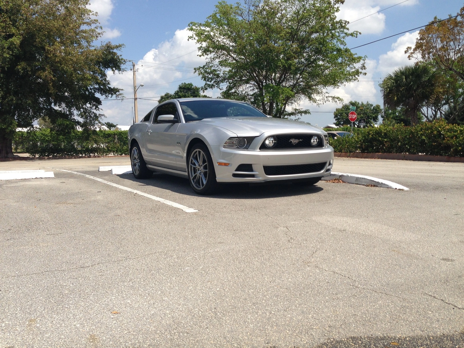

So the deal on the '12 fell through. The dealer wouldn't come down ONE FRICKIN DOLLAR!
Needless to say, I came home depressed that night and just for fun, I downloaded the CarMax app and low and behold, there's a 2013 sitting in their showroom 30 miles away from my house.
I rushed and arrived 10 minutes before closing-time. Test drove her and had her out the door in less than an hour.
2013 Silver 5.0
7k miles
6-Speed
Brembo package
Got it for $6,100 less than new with the same options (plus no fees from CarMax unlike the $599 the other dealer wanted to charge me)
One question, at 80 in 6th, I'm at 2500 RPMs and there's that good-ol' high pitched drone from back in the day that I experienced in my '02. Is this normal or should I go to the dealer?
With my stock exhaust I didn't get any drone, barely heard the car. I was the quietest car at the track :)
With my muffler deletes, I get drone at 2K. It goes away above that and below that mark.
So, drone on a stock Mustang doesn't seem normal to me?!?
I should clarify... It's definitely higher pitched than what I had with my '02 5-speed. It's only present from like 2,300 to 2,700 in 6th and it's coming from the back, not the tranny.
IF they did the gears (sounds like you have 3.73) and did not use the friction modifier, or enough of it, is can cause a howling? But, other than that I don't know? I don't think that the lack of friction modifier would only cause noise in a specific range. I would have the dealership check it out. My car stock have no weird noises, it was almost as quiet as my wife's Acura until I got on the gas hard.
Dude two things Gear probs or mufflers. I had a 4.10 put in my old 2006 and it was load. The guy must have eye-balled it. went to a reputable shop and had 3.73 put in - quiet - and 4.10's suck gas. I'm sure my rear would have been destroyed soon. As for mufflers - cheep ones drone, I put Ford Racing axil back "Sports" $700 bucks. Google them take a listen.
