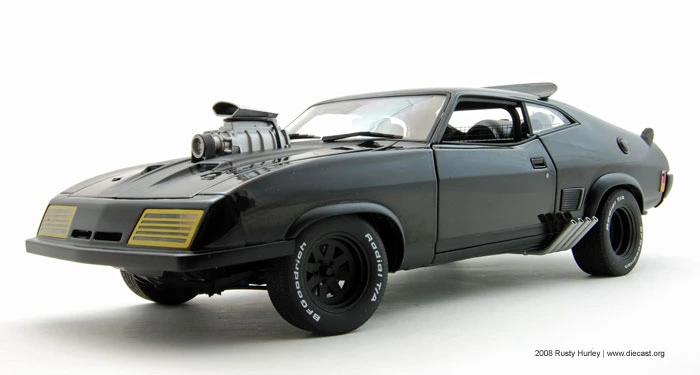

Hellz yeah! :rock:
Kinda hard to see in the pics but here's mine:
