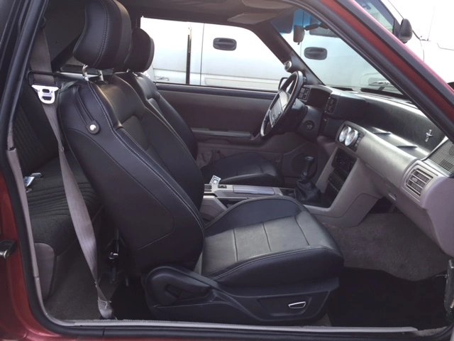

2017 seats are in & I love them!

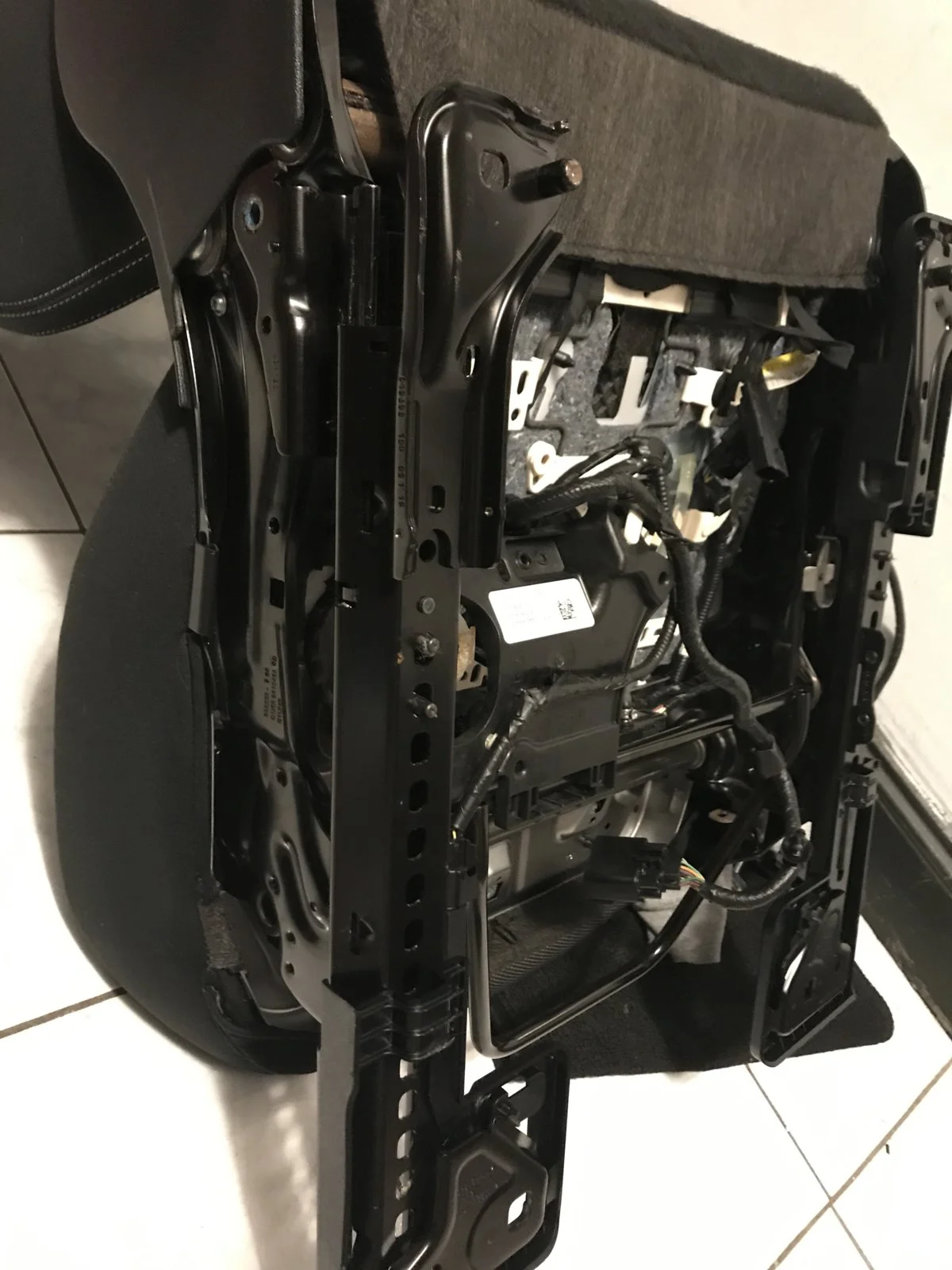

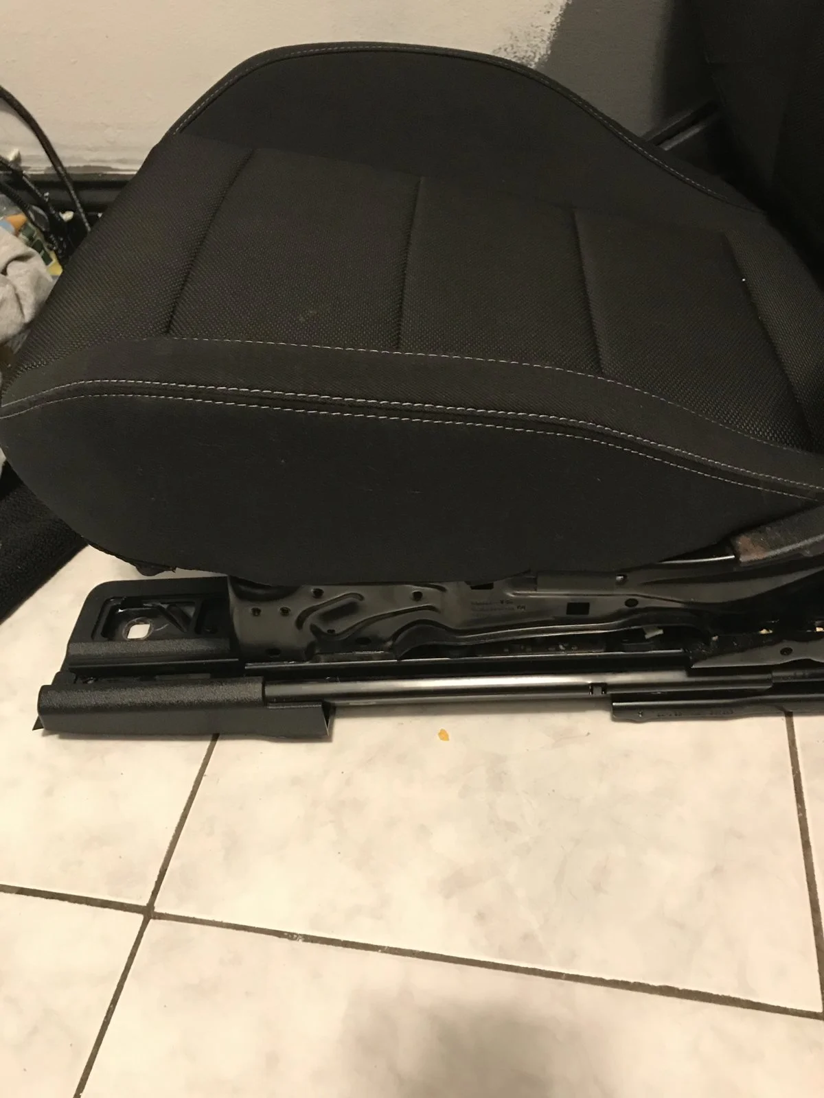

Awesome man kinda skimmed through it but will read it over again. So a couple of questions. Are the ones I’m looking at the 2016s any different base wise than those 2013s? Can the power lumbar etc on these some how still be used or is the wiring for all that just off and won’t connect to ours? Instead of using our stock tracks can I use these tracks from lmr? 54F58017-B14C-4957-AE9E-E59806181995.webp

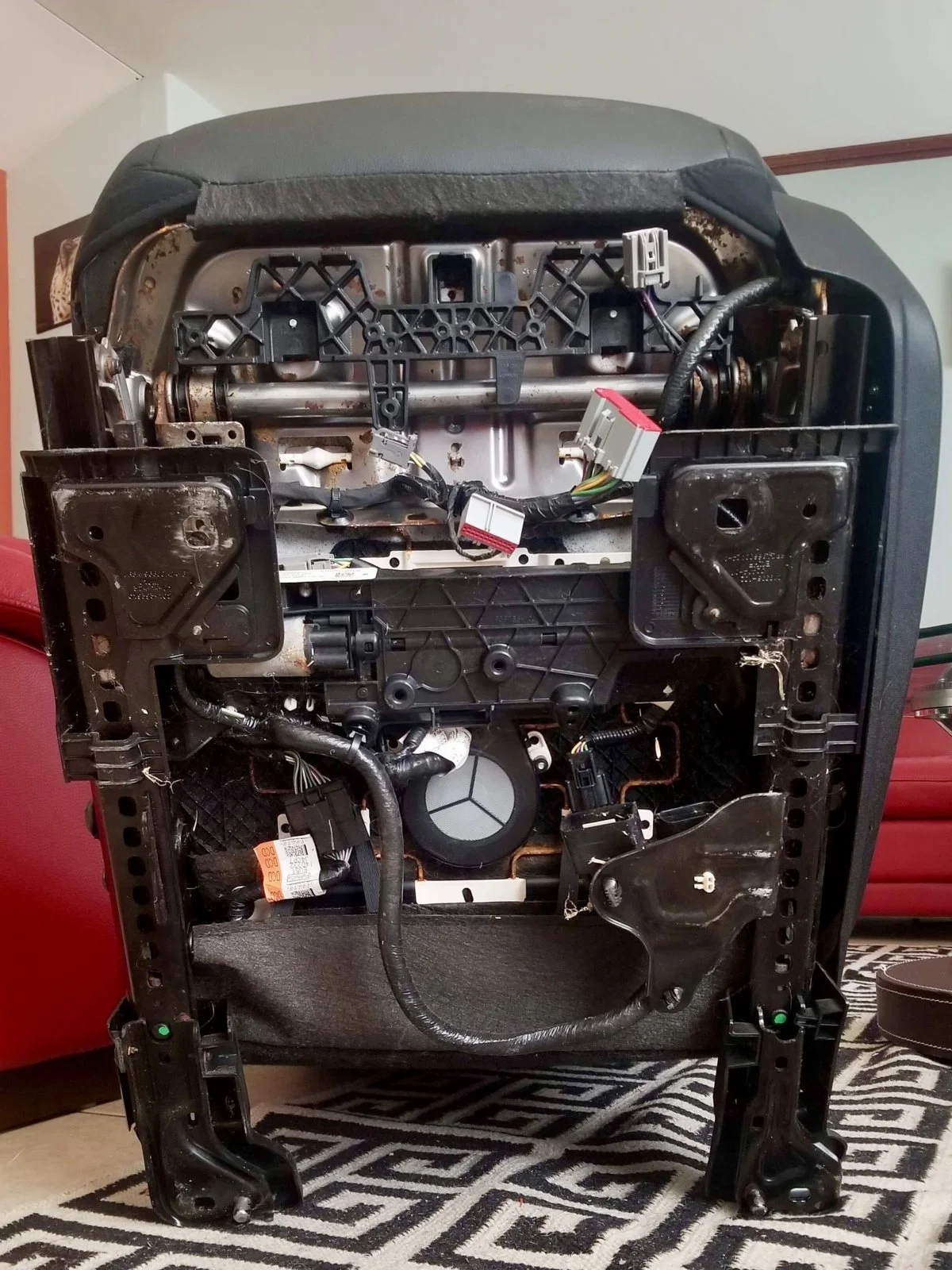

If you can post a picture of the seats from underneath I’d be able to answer your questions. I only know about the 2016’s because that’s what I bought.
As for the seat tracks I understand they are direct replacements.
As for the power seat question, I’m gonna say yes because there is a continuous power wire under the seats. The seat only draws power when the switch is turned on (toggle switch). You’ll have to splice wires but yes it can work.

This is the pic of the drivers side which he sent me.
These are 2016s as well, just out of the eco boost mustang

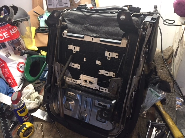

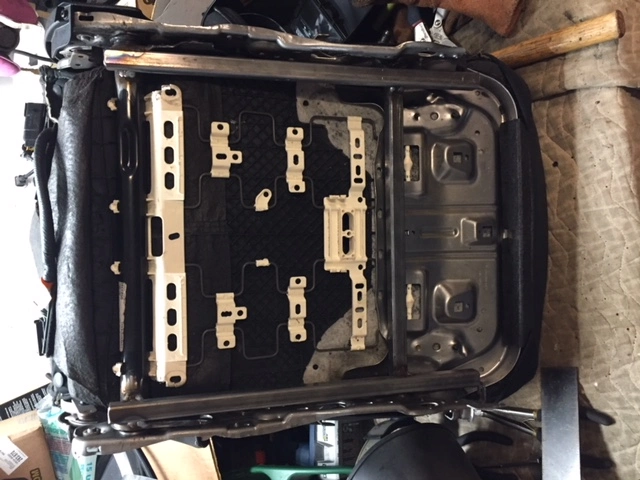

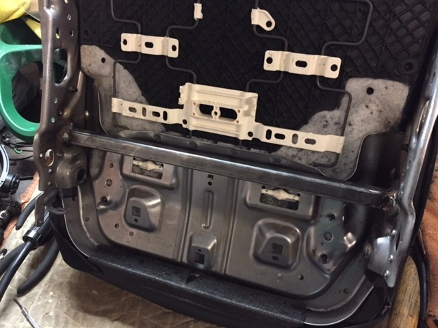

The most work is removing the seat tracks, heated and power features, etc. Once you get it all stripped down it doesn't take long to fab up a new base to mount your Fox tracks on to. Maybe a couple hours each seat, second seat goes faster than the first as is typical with most things.

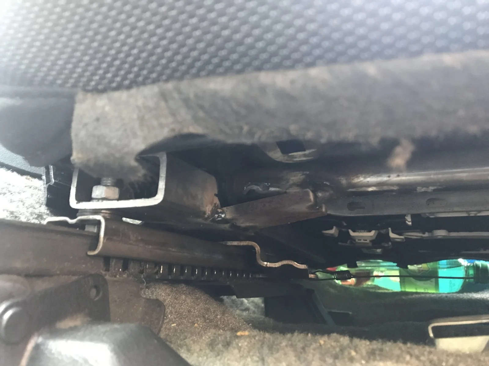

Wow you have the good seats. Mine are manuals so obviously they had less guts than these. If you look at my pics i shaved off (grinder, or sawzall) on the side of the seat tracks. Tuck away all the wiring while doing it without them getting cut. I used a grinder to cut it all off. Went pretty smooth on my end. There are two bars under the seat, one visible towards the front of the seat and another underneath the grey flap on the bottom of pic. I used 3/4” tubular metal welded from the back to the front of the seat BUT, when getting the tubing make sure it goes at least 2” past the front bar (if your tall, I’m 6’1”) so the seat can travel farther back. They have to be flat square tubing or else you’ll hit your head on the ceiling of the car from sitting so high. I learned this the hard way. I’ll take pictures of my car later and try and show as much as possible. I hope this helps.

I did everything the same except the bar you have going from left to right. I used the existing bar you seem to have removed. But great work nonetheless.
This is my seat in the car now. Both went in and don’t forget the new metal boxed frame has to have at least 14” square all around for the stock or aftermarket seat tracks to sit on.

The electrical shouldn’t be an issue as long as all you want to work is the adjustments to work. Again if you go under the seat you’ll see a harness there. Use a volt meter to test for a hot lead and then for the ground. I’ve used schematics to figure this out the right way on my other 89Gt with cobra full power seats and it worked for me. As for the seat tracks, $300 bucks vs $40-$60 on stock seat tracks is a no brainer. I rather use $300 bucks elsewhere like a cam or roller rockers etc. etc. If they should break again then hey do what ya gotta do. Stock seat tracks are all over eBay or Craigslist.

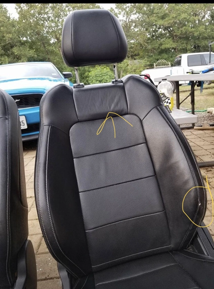

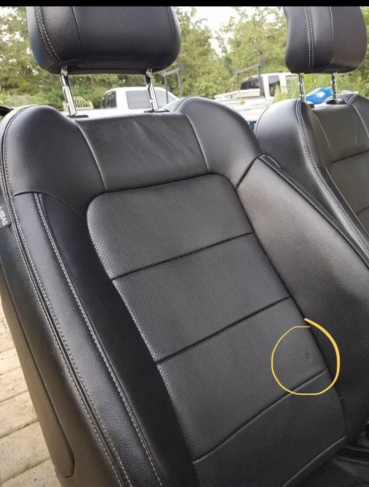

So went to look at the seats and I didn’t get them yet. I liked them could see them looking good in the car. I asked him what his lowest he would take to start off with. He said he had offers for 425/450 but nothing done yet. Maybe I’m just nit picky and some what of a perfectionist. So the seats weren’t bad, leather looked good, need to be cleaned up and some leather care and would look better. The passenger seat felt good, obviously hardly anyone ever sits in them usually, had a few spots of wear. The drivers seat also felt good to sit in but not as tight fitting as the passenger but not bad, could just tell someone def drove whatever car they were in, and the left sided bolster seemed a little worn I guess, idk how big the last person driving said car was. I’m 6’1” 225 and I felt comfortable. The leather seemed worn, like not tight as you can see in the photos. I marked some areas where I had issues with mainly wear and tear, and there was a small area on the left bolster where the leather got scuffed. Let me know what you guys think, I told him I’d do 425 cash in hand and he said 450 and I could take them. I walked away, said I was gonna look at some other seats I’m interested in which are some tmi pro chicanes which the guy wants the same price 450.
