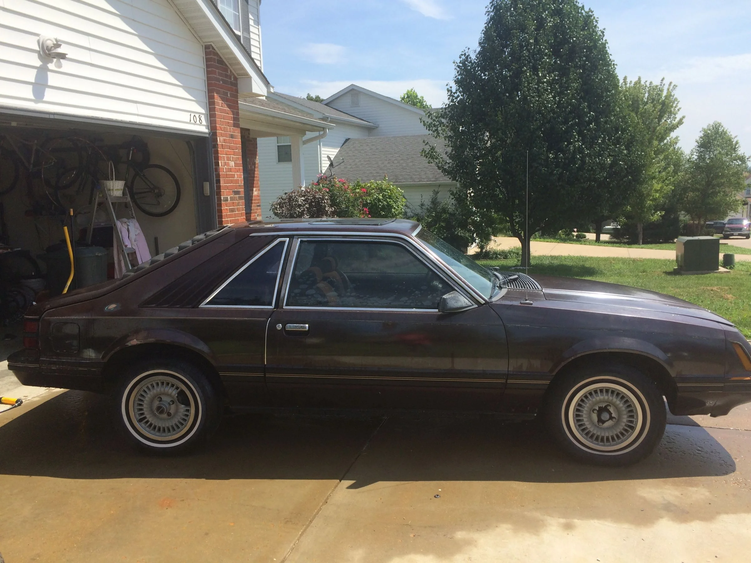

The first car I ever bought was a 1983 Mustang GL (bought it in 1987) and I've had it every since. When I bought my second Mustang in 1991 I kept the '83 (I'm still not really sure why, but I did.) I always had the plan to paint this thing Jet Black and put a 5.0 in it. (its got a little 2.3 in it. Never could afford the insurance for a GT) Anyway, never had the Money or Time. Finally go some money set aside for it but I figure I'll never have the time so I'm just gonna pay to have the Big Stuff done for me. I've never done anything like this and don't really know were to start. Long story short I want to start out with the motor. Like I said I wanna replace the 2.3 with a 5.0 but don't want something out of a junk yard. Professionally rebuilt motor would be OK I think but don't know were to go. I had the Transmission rebuilt but figure I need something else to go with a new engine and I'm guessing a new rear end too. I would appreciate any advise you have for me. Moved a couple of states away and don't know any good "Car Guys" around here.

Here's what will help you out. Post a new thread in the '79-'95 general talk subforum. Include lots of pictures of your mustang and tell the guys there generally what you want to do. We have a big fox mustang contingent here (I have two myself). You'll get help on any stage of your build that you could want.

You'll need a rear end, front and rear springs, v8 front spindles- brake calipers -master cylinder- booster- proportioning valve, transmission, motor, double hump crossmember, front and rear shocks/struts, carb, intake, fuel pump ( on motor ), not to mention all the support stuff ie : water pump, alternator, power steering pump, radiator, fan, belt, hoses, the four cylinder rack is different, k member, wheels + tires....
To be honest... The best thing for you to do is buy a running v8 fox with a terrible body. You can source everything from a good donor car.
I just swapped my 4 cylinder to turbo v8. Most of my parts came from a previously owned v8 that met the crusher. [emoji106]
Something else to add is that your mustang has the narrow front suspension....that means you need front control arms, too. I'm a professional master mechanic and would much rather have someone bring me a car and a donor car for the project you want done. Alot of guys here will help with advice. We all love seeing these cars saved.

I'd focus on 87 to 93. With a doner v8 you'll still may want to do some motor refreshing..... And you'll need to buy an intake and carb. Its not a hard swap....just takes time.
When you find a donor there are a lot of parts that you can sell off to recoupe some money.
With having to switch out so much suspension/chassis components to run a V8 I highly recommend going straight to a 5 lug conversion. I also recommend checking out Maximum Motorsports for their suspension and chassis catalog. They will set you up with top quality parts. It won't be cheap though.

I guess first question is what do you want to do with the car? A nice modern EFI driveline with 8.8 and 5-lug disk brakes is nice, but is that what you want?
What's up with that back rim btw?
If you look for 89 to 93 you can go EFI/MAF use the PCM, harness etc and get all the benefits and no carb as well...
He could also use a standalone efi system. Better in my opinion. Just trying to give the him the least expensive route. The brakes would be nice to upgrade.....he may find a donor that already has the 5 lug swap an sub frame connectors.
Using other folks to do the work would make a harness change out expensive and time consuming. Nothing wrong with a carbed car. Mine got 26 mph. and ran flawlessly.
